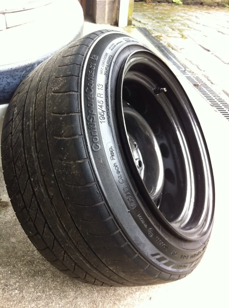

Banded Steelies
Another Fin:) 8.5" front 9" rear 195/45 13 dont know what ET
I've got 9" wide banded steelies on mine. If you run a bit of camber on the front (1.5 degrees), and a stretched tyre (185/55/13 or 175/50/13) 8J wheels should fit. Dependant on the offset of course but mine are about ET0 with 195/45/13 tyres and with an aggressive flare they fit :p
