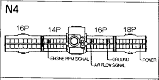

This is a pic from the Apexi AFC PDF wiring manual. You can see the RPM signal there. I am sure it works. Just splice into it there.

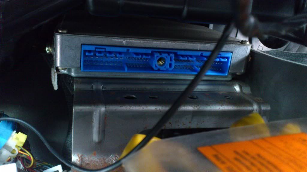

You are looking at the plug and not the ecu.
You cant see that in the centre where the screw/bolt is one of the bits at the top is higher then the one at the bottom. Just look at it the same way. I think the 16p would be on the right, but I cant be certain

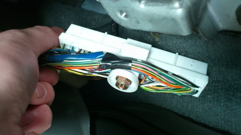

Right, so for clarity, I'm looking at the wires on this thing:
That goes in this thing:

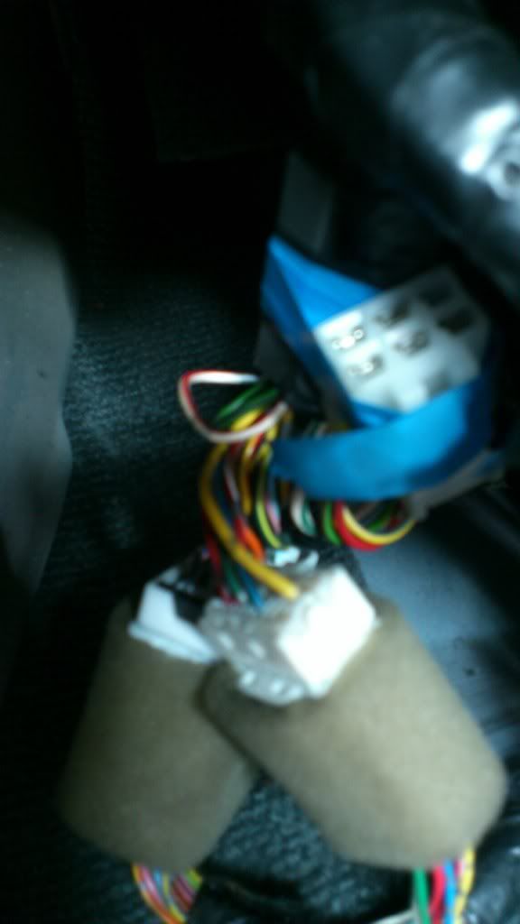

And these bits are not involved at all (or are they?):
Yes you are looking at the first pic from the same direction as the picture was taken. Count the amount of wires. The one one the left is 16pin and the far right is 18pin, just to be sure
So find where the rpm signal wire is from my picture in the 14 pin section of the plug and splice into it. Dont cut! And try to solder it for better contact.
Right, think I'm getting this now... Second port, top row of 14 pin section is for tacho. So if theres a wire there splice into it, if not then insert one in plug.
Your hand written diagram in other posts and the picture mckenzie put above are looking at the plug from the front, not the back as in my picture, yeah?

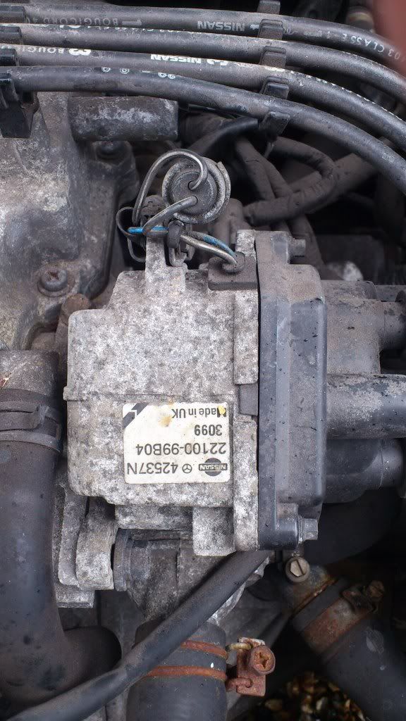

there are 2 plugs on the dizzy, and you need the blue wire in the smaller plug oddball (but thats the same wire that we indicated on the ecu surely ?)
The ecu sends a trigger to the transistor in the unit. there is feedback via a resistor that plugs into the side of the coil. Some tacho units do not work with the trigger or the feedback signal as the voltage is not high enough. I've had this problem with omex shift light units.
Right... Found what I thought would be the problem... The blue/black tacho wire from port 2 was somehow broken under all the tape a little further up the loom. Have re-connected with a terminal block (not ideal I know but will do till I buy a soldering iron next payday) and have also connected the tacho signal wire into this... Still nothing... What could I be doing wrong?
I think I see the cable at the dizzy, will try get a pic up but I'm on the phone today, but don't really wanna be splicing into cables in the engine bay & routing them...
Is there anywhere else I can splice into the signal? Surely the dizzy wire comes through the bulk head somewhere?

not sure if it will work but its worth a try, when i was installing mine, I unplugged the cluster and started the car then put the signal wire into all of the holes in the cluster plug until it picked up the rev signal, its worth a try, worked for me, but mines a coil pack :) might as well try it :)
Is this what we're talking about? I don't understand all this stuff in porkpies guide about orange wire & black wire & bridging gaps etc?...
just test it on that blue wire there oddball (with the other 2 wires on the battery)
How do I do that without actually cutting into it? Presumably this is the exact same cable I've spliced into at the ecu so I can't figure out why it won't work?

np oddball :) you can stab a sewing pin into the wire just to test it eh, and then if it works bare about 10mm and lift the copper strands up and thread your wire through, i soldered mine and just left it bare :)
Cheers Frank... Is there any particular type if cable I should use & will I need to shield it in anything for protection or can it just be cable tied to the loom back to the bulkhead?
just use the same wire as they,ve used on the gauge eh
Right, just tried it directly on the dizzy wire, with a pin prick as suggested & we have life! Reading about 700 - 800 RPM at idle, is this about right? Have 2 of the gauges as the first one sent was wrong colour & they're both reading the same so they are at least calibrated the same... I guess they wont be spot on but how accurate are they?
