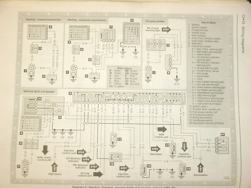

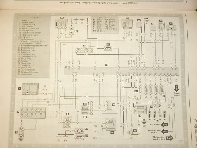

As some of you know i re loomed a 2002 k11 with 1995 micra looms drawback is there is no nats to stop it been stolen, So after buying this alarm imobiliser unit I cant find my haynes manual (story of my life) so I need a few pointers if possible so here goes. Firstly in diagram ignition cut off circut it shows relay and a coil now ive circled this part where would i connect this up to to perform the task of imobiliser next is the window trigger wire this is shown as negitive in diagram could this be used instead to protect the boot or engine bay or even both. thirdly the acc wire on ignition on the unit its white what colour is the wire it connects to on the micra loom. maybe nex or some other clever electronics person could clarify these small things for me before i fit it up.....
