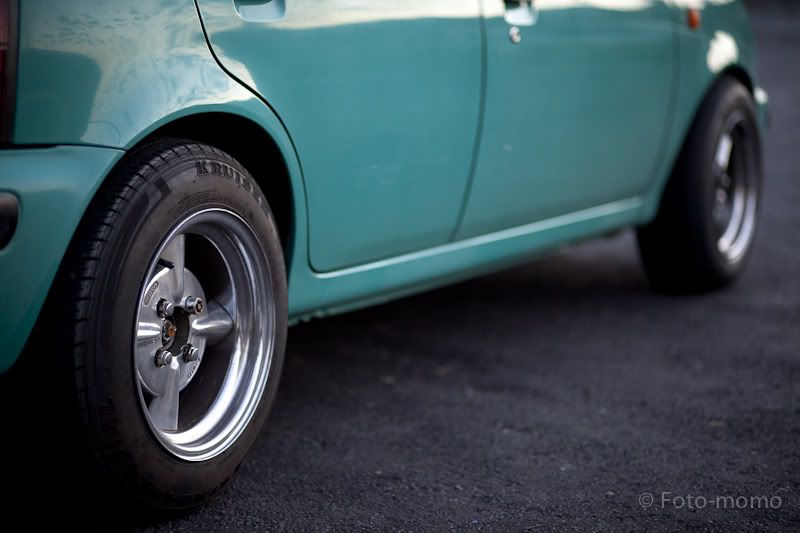

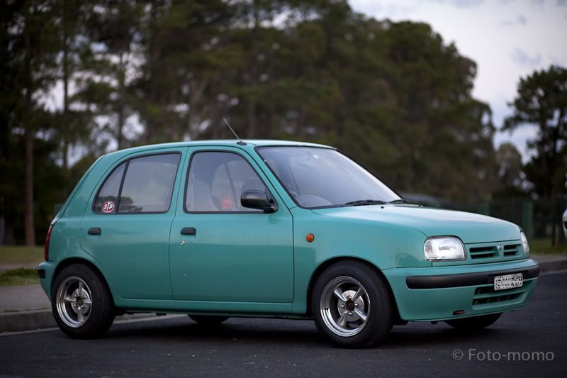

CMF_hotfunk67
» CMF Member
Member since:
Posts:
2 sets of Matiz rear springs and a set of Barina rear shocks.
Looks like this
nice daily height and doesnt rattle your teeth out.

Hey hotfunk67 mind posting a side view of the car just wanna see how the clearance is like. How far does the car sit above ground? Also are you using standard uncut matiz rear springs at both front and rear of the micra? Standard front shocks?
CMF_Mimz
» CMF Member
Member since:
Posts:
So how is the handling? any negative effect considering its the same rated springs at both ends and there more weight at the front than at the rear. Would there be any chance the springs might work it way loose ie, going over bumps on rough road and then one of your spring came poping out?
Ps nice clearance tho look like +100mm so fairly legal.
CMF_hotfunk67
» CMF Member
Member since:
Posts:
Handles much better than it used to, doesnt feel like it's going to fall over in the corners now:)
The springs are captive at both ends so no they are not going to come loose.
It may not be the ultimate handling package but it is comfortable for use as a daily and looks much better than the standard height. There are no chopped springs and it is legal height so no unwanted attention. I didnt want to go super low so this is perfect for what I wanted and I can still get up my driveway. Best thing is it cost me just over a hundred bucks, Bargain.
