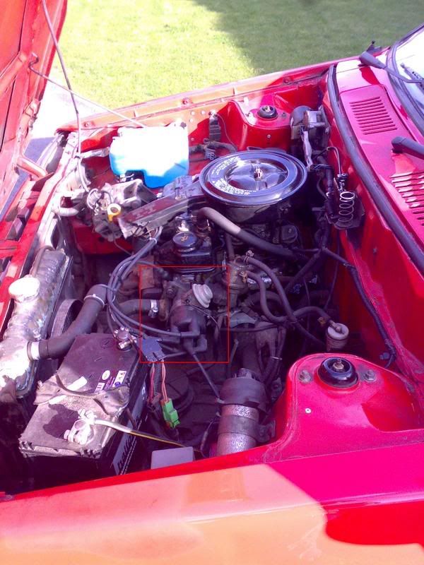

Post picture of distributor
hissyfizzy
Hi can someone post a good picture of where the distributor sits, sounds daft the pigs timing seems to have gone out for some reason. The distributor when I got the car was just off centre but now the car won't start unless I put the distributor almost over to advanced setting.

Borrowed your pic.....
the green hilighted part on the distrubuter is the diaphragm that flexes when there is a good vacuum.....if this is perrished there can be a leak through it and it will not flex instantly with the vacuum and will not flex as far either (wont advance the ignition as much)
if you have a clean peice od new pipe.....disconect the engine vacuum pipe from this device and addyour cleen bit....(with the engine off)....then put the clean pipe in your gob and suck with your cheeks (not your lungs)...when youve created a good vacuum plug the pipe with your toung to keep the vacuum in........if it sticks fast to the end of your toung for say at least a minute....lol your gonna look silly) then this device is probably OK...but the suction in the pipe dropps and the pipe comes off easily then the chances are this device id leaking...in wich case replace the distrubuter
