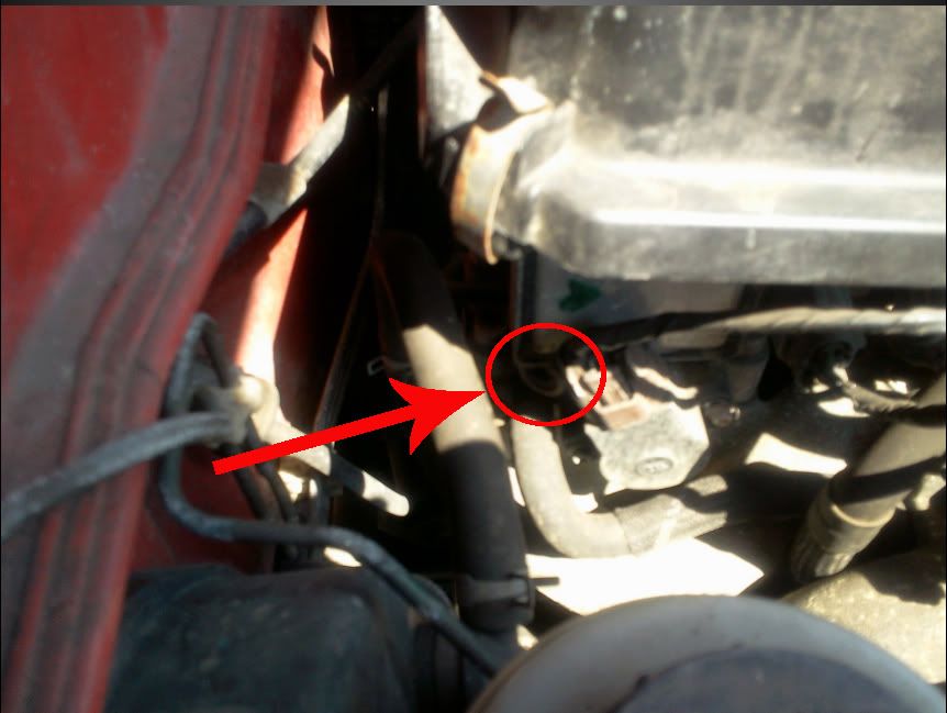

well, i dont know if your micra will have this as i have the k11 before yours (the older one) but, my friend told me about a small screw in the TB and what this does is change the idle revs, as mine was setting on 500RPM on idle and didnt really like it so i changed mine to 1000RPM (highest it will go and highest i want it), and it does now sound on idle like it has a small whistle, which is the effect i want, so when its sat there you can here like a very small whistling sound, (had a mechanic check said its fine nothing to worry about) so with it on idle on 1000RPM it warms the engine up faster, and also since i have had this changed it also has imediate throttle response difference, before it wouldnt pick up as good, but now you kinda put your foot the tinyest bit down and it does pick up a lot.
this screw is on the TB the left side of it and its rubber, you will have to get your hand down deep and with a phillips screwdriver (cross) took about a minute to do but i realised the difference straight away :) hope this helps, if you neeed pictures let me know il get you some
well i guess its worth a try i can always put it back again, yeah if you have pictures that would be great? also im assuming you had the engine running while you did this?
no no, i had the engine turned off, but if im right its a clockwise (right) motion to make it higher and anti-clockwise (left) to make it less, but less than 500RPM would kill the engine im guessing
but yeah i can get some pictures taken for you tomorrow and have them up straight away tomorrow afternoon :)

well, as far as i know this screw is more mechanical in the engine than electrical with the ECU, and i think the screw changes something in the TB to tell it to suck more air in to rev it more but i dont know haha, but yeah i have some pictures for you, here you go :p
ahh okay, recon i have one frank? and how do you have yours set? any experiance with adjusting them?
i dont think coilpack t/b,s have one, and the idle control valve works the same way, so you have to set the idle with the bleed screw so that the i/c/v still has its full range (from fully open to raise the rpm, to fully closed if there,s no parasitic load, ie p/a/s or alternator loads etc)
i couldent see anything yesterday that looks remotely like a screw, now i have seen a pic i know what im looking for but i doubt i have one :p ahh well, any other ways to make it abit more responsive?
