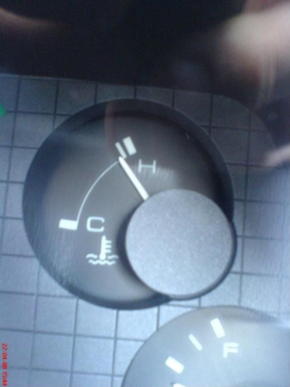

righty as you can see from the picture below i kinda have a problem
what can it be?
i know the rad fan isnt kicking in but could it be anything else?
its drinking loads and loads of water aswell but only tends to over heat if its wet or i'm ragging it

oh the pic is of my temp gauge all the way to the top just before the H
