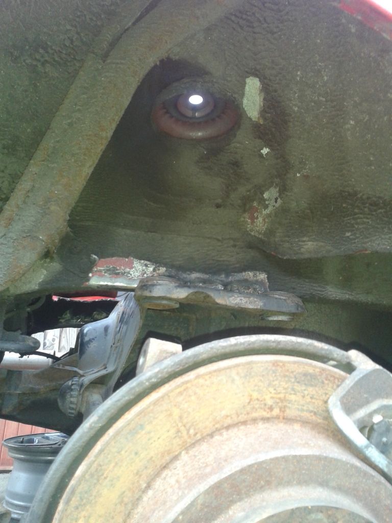

So I thought I'd share my suspension woes with you all

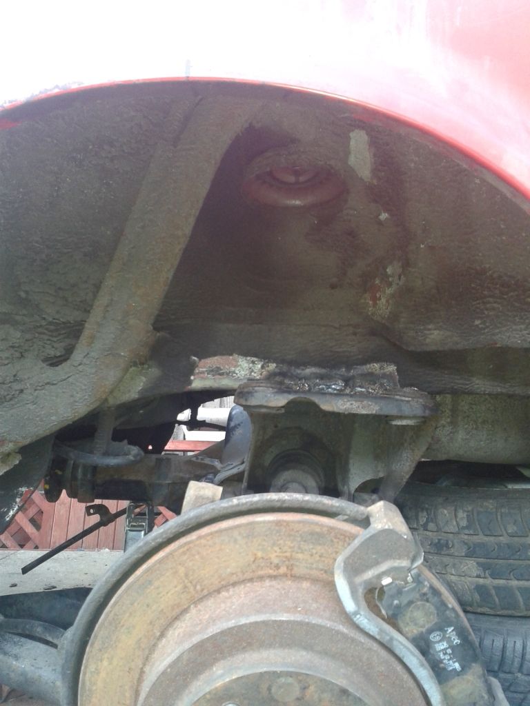

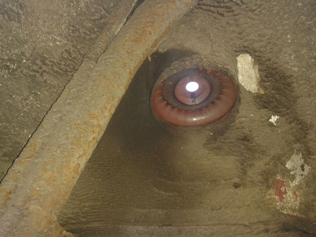

For those that haven't seen a k10 rear turret

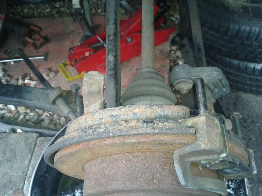

And for those who haven't seen a subaru rear hub. Which I suspect is many
Notice something? Well the mount is offset forward...
And the micra turret in relation to hub?... yes its offset rear
At an angle
Im making an offset 'y' bracket to mount polo rear coilovers ( as an example) or if I use the subaru oe gear or coily fronts I'll use what we call an offset 'd' bracket. Haven't got one to show you all so I'll draft a sketch up for myself and take a picture.
Another idea I've had is to swap the hubs around. Putting the brakes at the front instead and the offsets mount to the rear. Whether it brings it inline or not is another matter but I don't fancy fighting the old carrier bolts and the driveshafts nuts.. we'll see
Can't flip the diff... but there's no need anyway? It'll run the same. I can however try and swap the hubs which is my hopeful idea and possibly the best option. Except I haven't measured the two arms bushes width to see if its possible first. Can't risk upsetting it if they're not

The suspension has come to needing new turrets making. Too far offset
