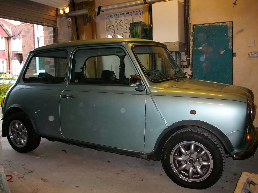

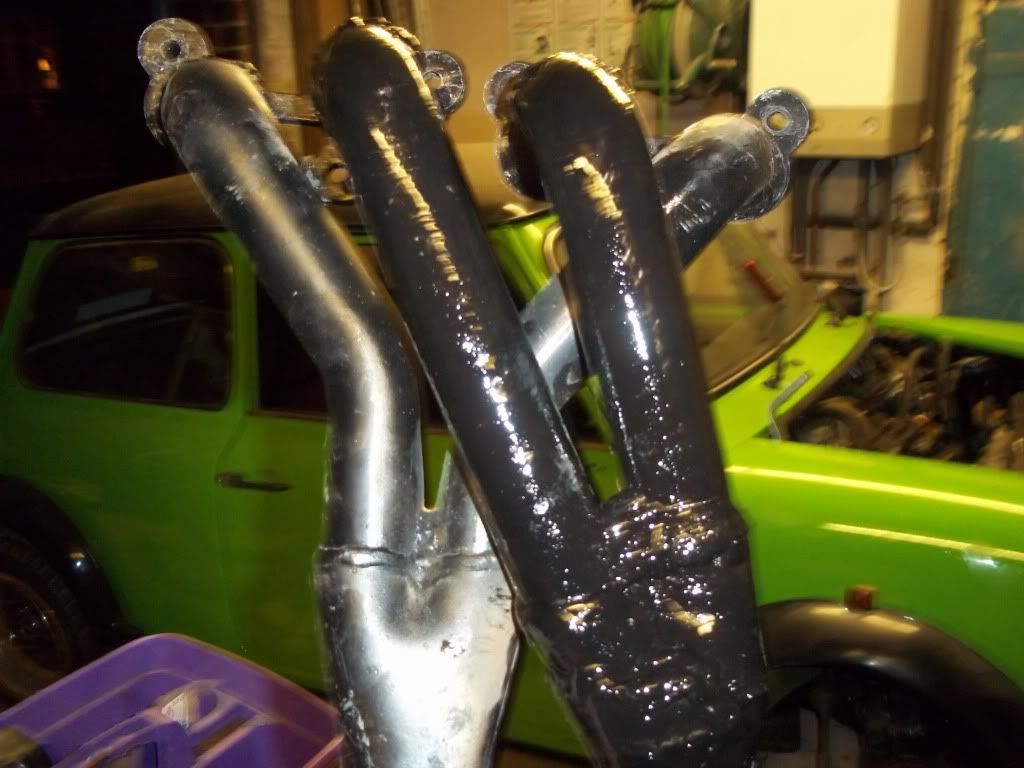

Just found this forum. I'm running a CG 1.3 engine in a classic mini... custom inlet manifold and 4 branch pipe. i am finding that the gearing is a bit high, i'm running on 13 " wheels, but would like a bit higher top speed at the expense of acceleration any advice on final drive ratios would be appreciated.
Welcome buddy, I must say that's an awesome car you have there, looks mint (Y). First time I've seen a Mini with a Micra engine in it :laugh:

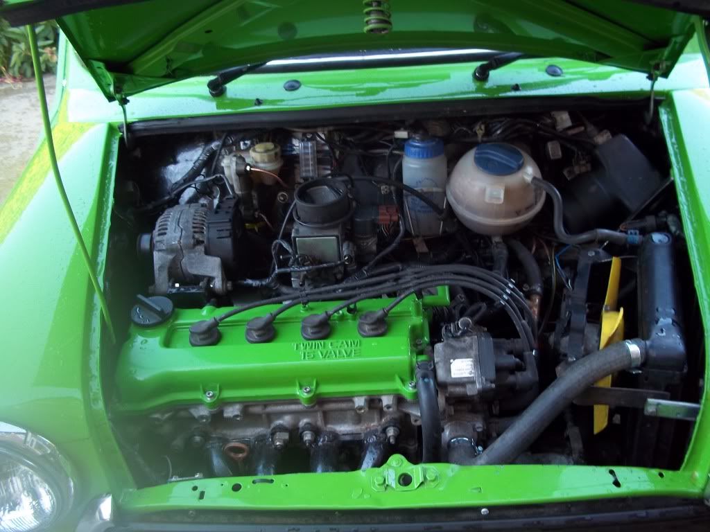

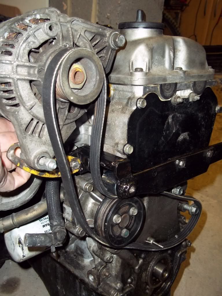

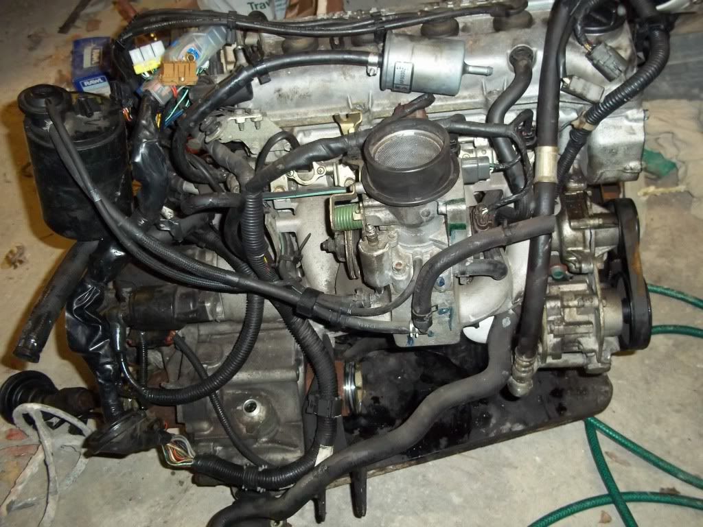

I'm very impressed that it's all your own work (Y). More pics? Be interesting to see what else you've done to it :grinning:
I guess a custom set of final drive gears is the only option, if that is even possible? the Haynes manuals these days don't show any detail of gearboxes, and I've never seen anyone here messing with their gearbox, inside it that is.

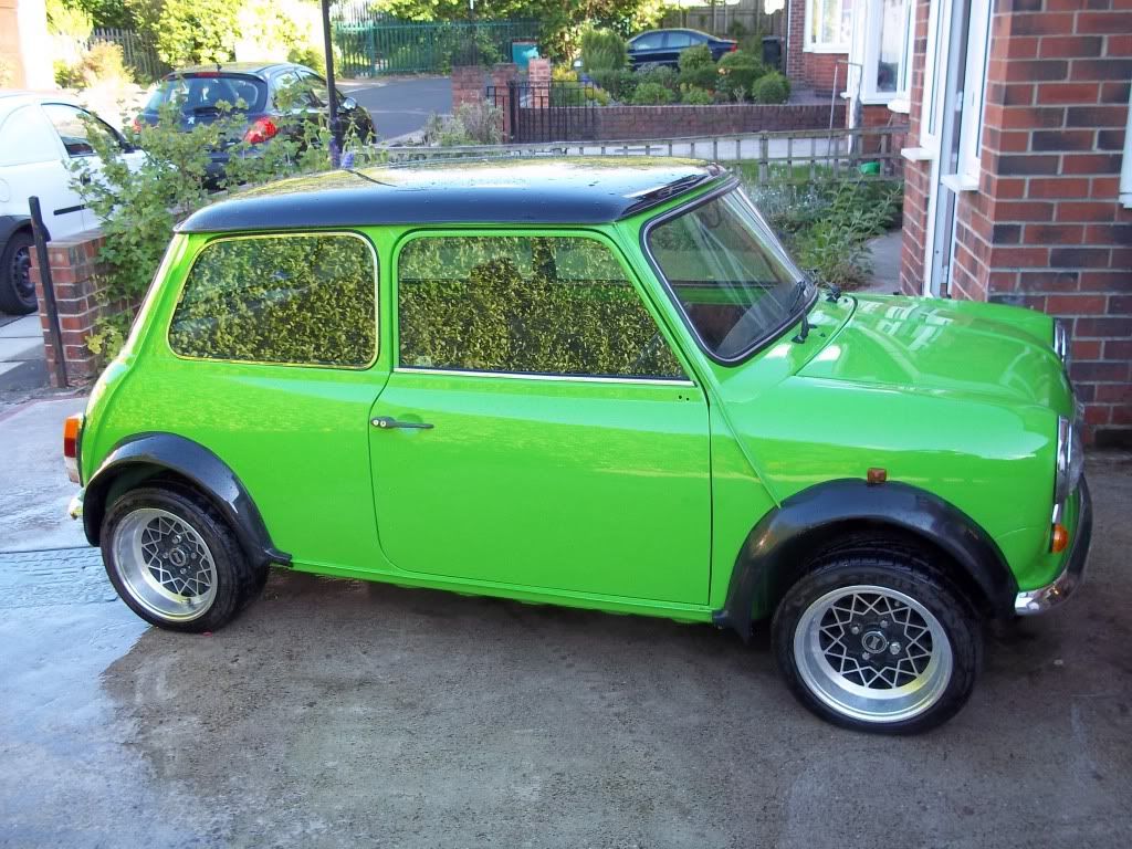

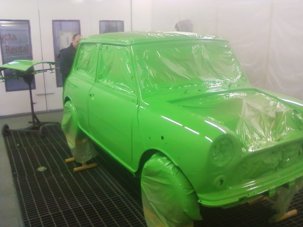

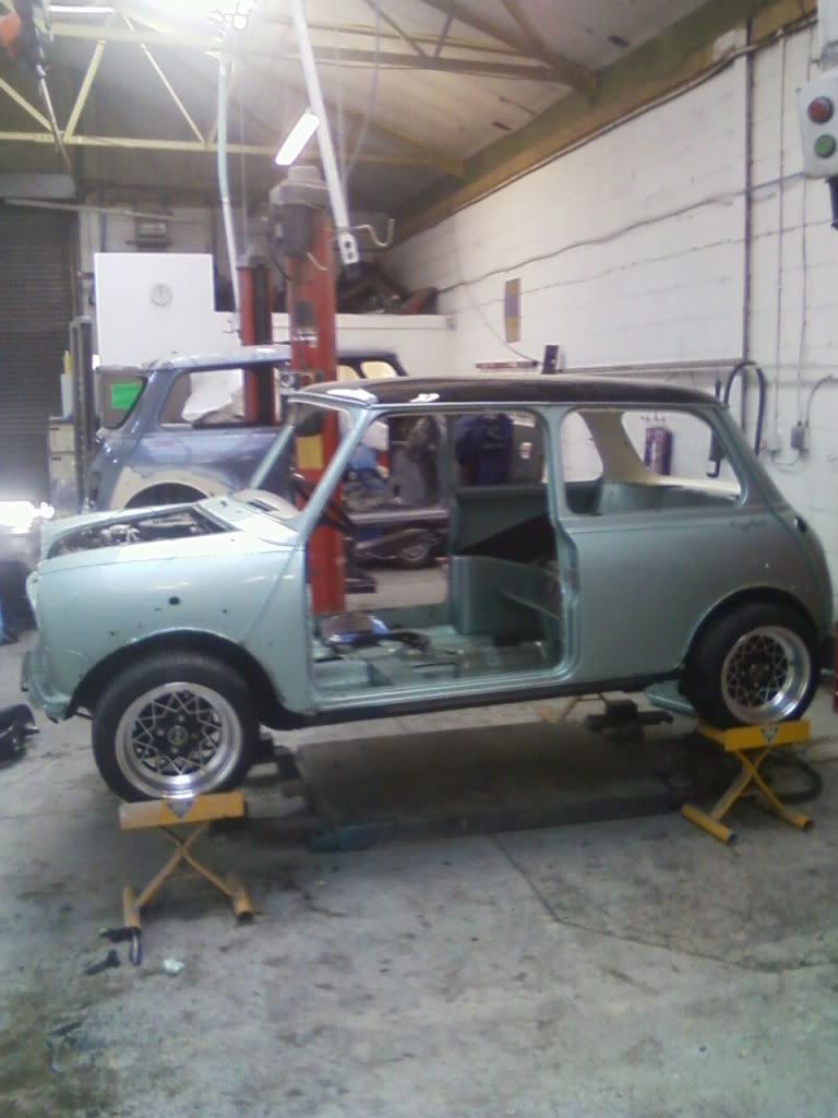

That colour is just way too awesome, and those alloys? :love:
I like the way you've managed to make it all fit together as well - remounting the alternator, fan, and vital fluid bottles (Y)
