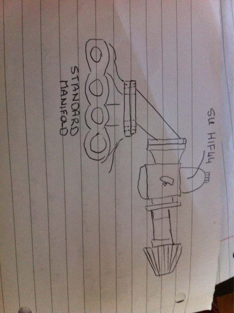

I also can give you an idea for mounting one to a manifold , i had an idea for an adapter for the mani thats standard , ill sketch it tomorrow and post the picture tomorrow , the idea was it would be simple and cheap to make or not too expensive to get made if your not able
Right so this was the other option i had i cant remember who helped me with this , may have been MicrAde , because being an awesome but typical yorkshire man he always shows me the cheaper option :p
So it involves ,
1 plate shaped to suit standard mani
1 plate to suit SU
Pipe with right bore and outside diameter to suit , cut at angles each side to get the SU at a right angle .
Only problem with this is your stil stuck with the restrictive standard manifold , however it leaves it "cheap and chearful"
