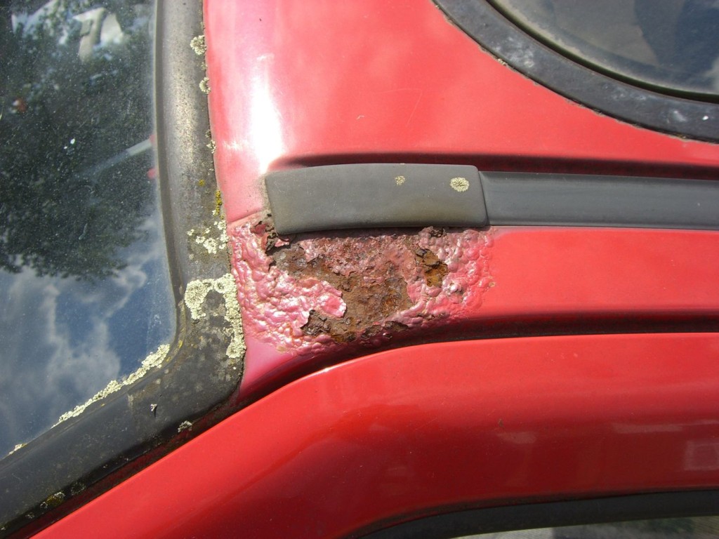

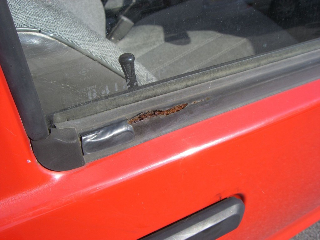

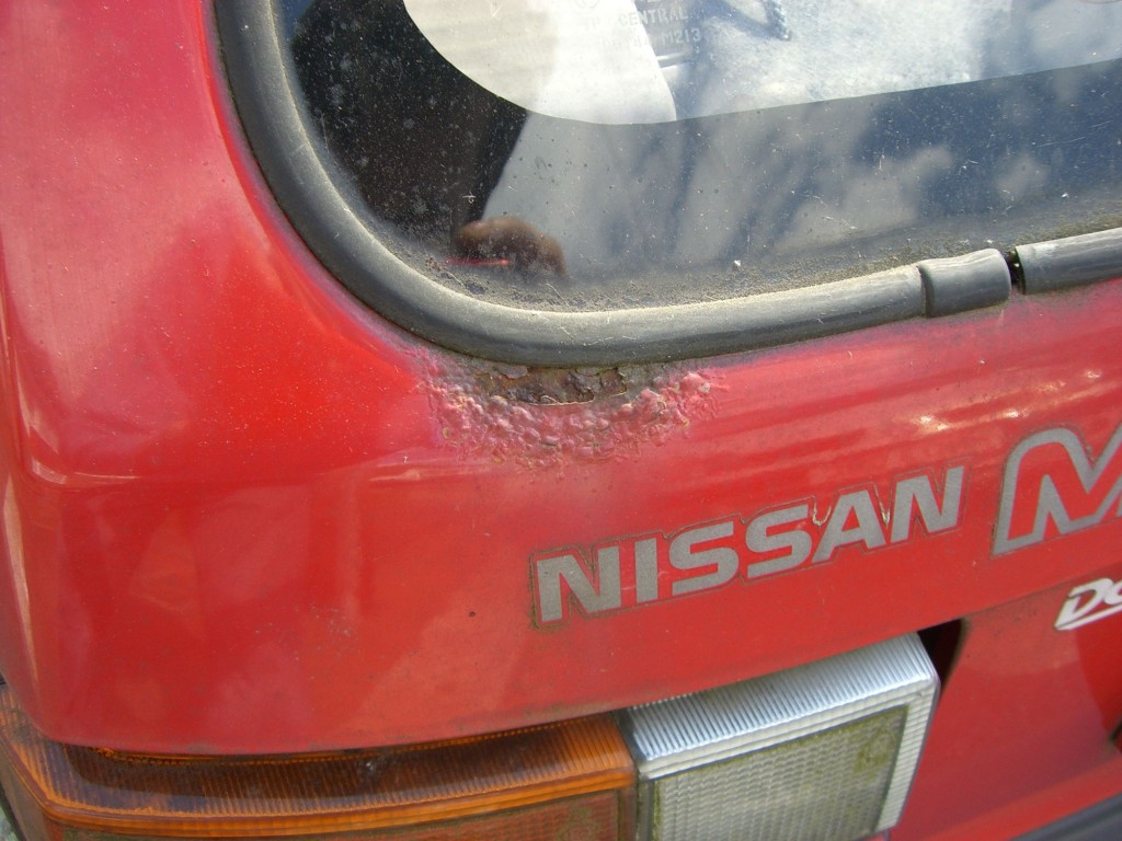

1) so how i sort rust out then? on the sill, roof and boot. easiest way?

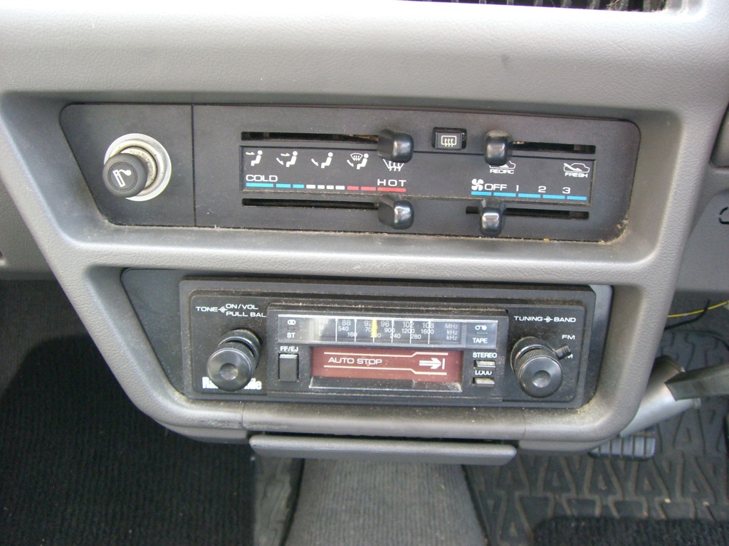

5) i decided to check all the cars fuses. There was nothing in the aircon fuse slot. So i put in a 15a fuse. Now when ignition is off, no lights on dash or whatever, I can turn the air con on. Is this right.

this is what i got
Yeah thats just bog standard heaters lol, on the rear march K10s came with air con iirc

Munkeyboi I have had some success recently using this green gell stuff to treat rust. Bought from halfords, it is quite expensive, cant remember what its called, but its basically kurust i think.
you rub the loose surface rust down, then brush on the gell. Leave it a while, 3 hours or so, then rub down a bit. Conitinue until you have all the rust gone. You need to paint over the naked metal fairly quickly to prevent it rusting any further.
That is what I have done with a satisfactory level of success.

Also, regarding the rust. Would green super goop be ok for these areas do you think. Am wondering in particular about the sill. All 3 of my rust spots are by some sort of rubber.
