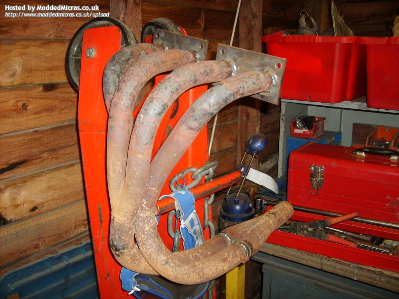

look,s good ! but those headers look huge compared to the exit pipe, supposed to be around 2/3rd dia i think ! exh gas speed is important, if they fall below a crutial level you get stalling and turbulance and a flat spot in the bottom end usually

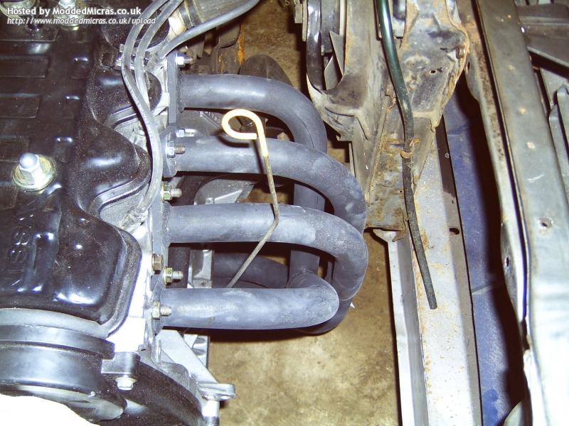

What sort of price would you charge for a 4-2-1 manifold like in the pic?

don,t take offence ! im,e just saying that the exit pipe LOOKS a simular size to the headers but has to handle 4 times as much exh gasflow. if it,s the camera angle then i stand corrected !!

no the flanges are still mint, primaries are 35mm o/d, your welcome to the 3 y pieces if they are any use, wait till they arrive, then sort my bronze membership please ! my email is [email protected] if i cock up !
