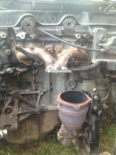

Listen mate I have Owen and built my own micra turbo my self yrs ago and done it cheap lasted 2 yrs then sold, I moved to Saxo turbo I own and built two turbo conversion on them mate as well it was mines for 7 months each, a rack is nothing special too me mate its only a rack with bolts, I been there done it I drive a c200 cdi micra is just for fun mate so yeh go and get rack done off Esle where lol
That's an engine? Tis a good start to being a mechanic but doesn't answer the question.
