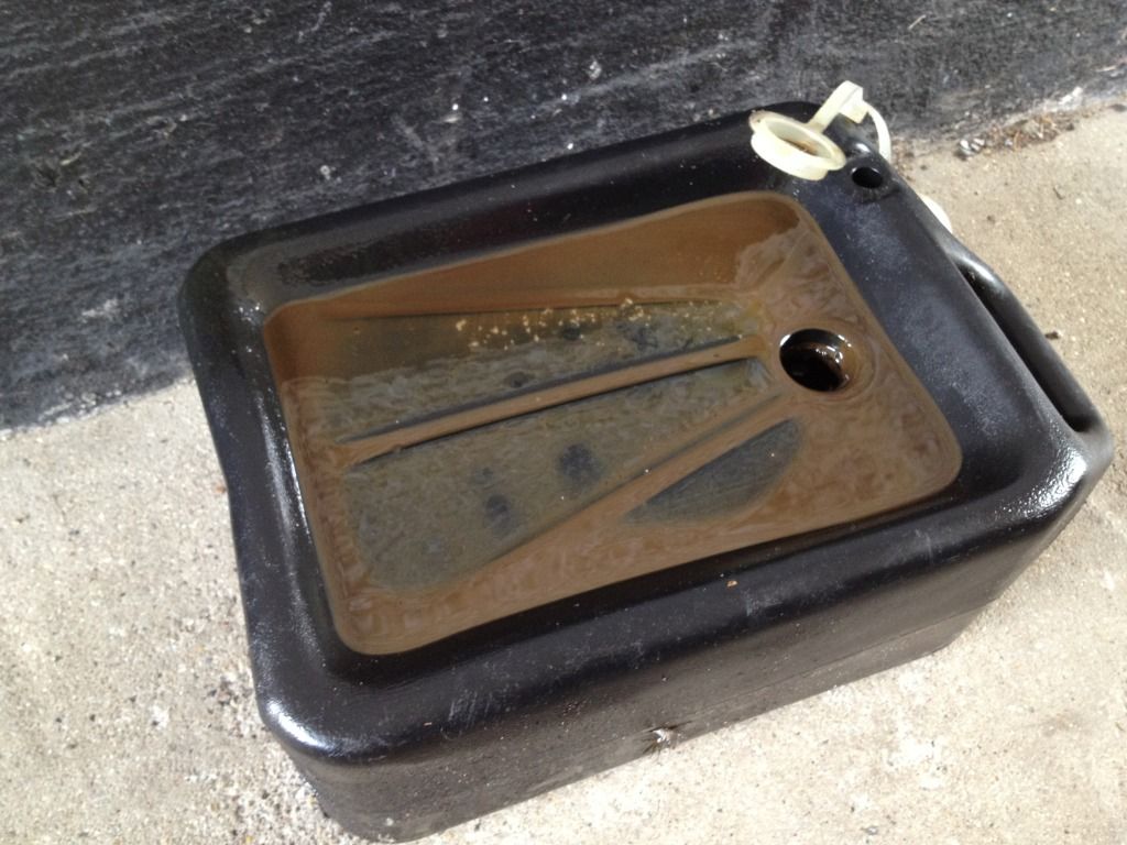

It's quite obvious from the oil

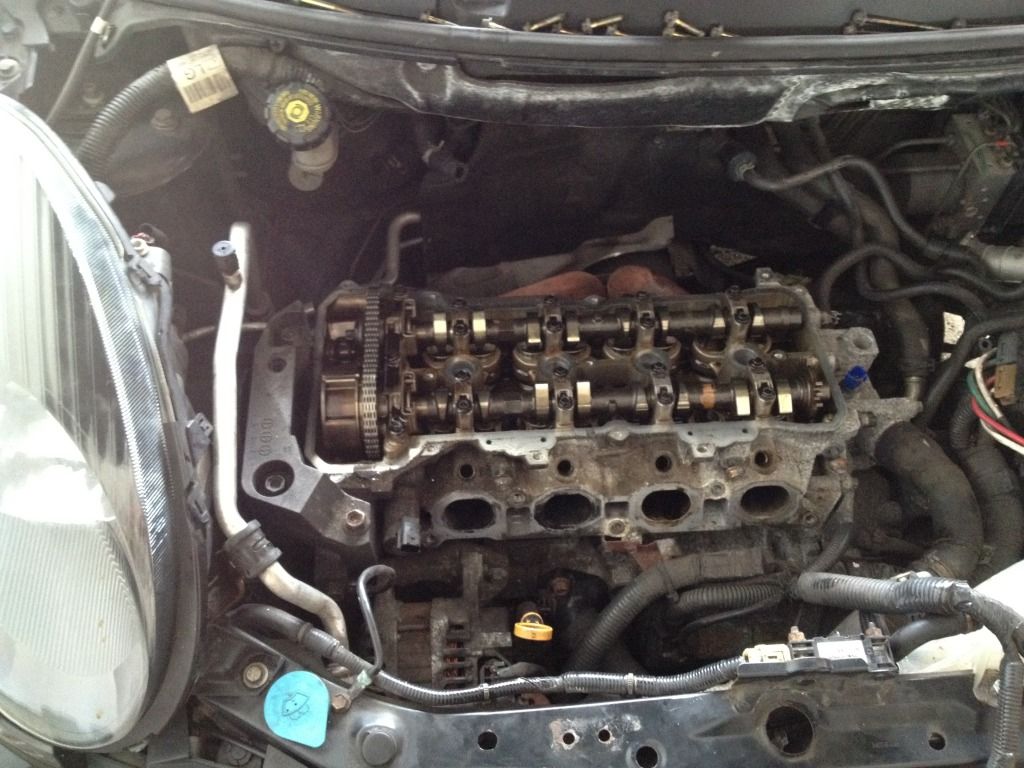

Anyone know how to go from here?
I don't know what to do from here. Brak the chain or do I need to slip it from somewhere?
Please help
Not seen it done in the car but when we do chains on the k12 we find it easiest to remove the engine to be able to get in,but you dont split the chain just try and remove it somehow
its not gonna be straight forward george, those vtec mechanisms need to be pressurised to lock them into position iirc, and are easily broken i believe.
you will need to remove the sprockets and cams to get to the headbolts mate

WD40, blow torch and rattle gun finally undid the crank bolt. I was struggling with the cam pulley bolt but then again torch and rattle gun did the trick.

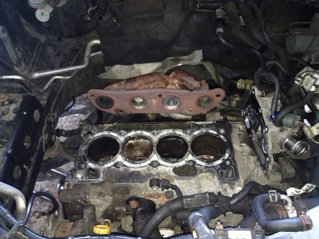

Gasket is from metal so no obvious fails, but there was water in two of the pistons, so cleaning time tomorrow.
nice one george :) exh primaries 2 and 3 looks steamcleaned lol, could you not leave the chain and cover in situ ?
I probably could have, i never really done this before so i just took the lot apart. lol
Now i just need to find some manual how to time it and reset the vvt :O
probably head distortion eh george, with those pressed steel headgaskets there,s nothing to actually "blow away" when they blow, so any leakage will be due to an uneven face eh
