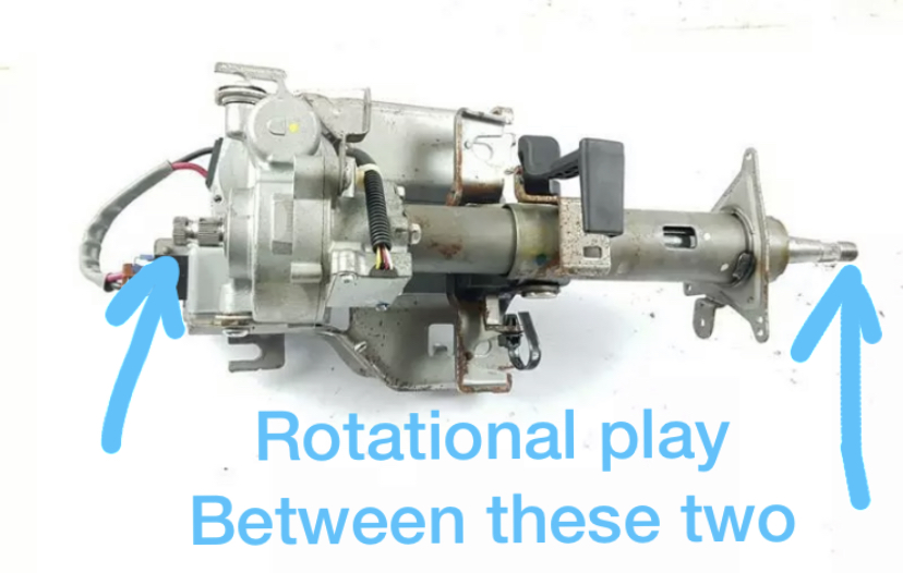

Hi @huttojb - May I pick your brains.
We have a more ‘mechanical’ issue.
Our 2008 Nissan Note has play between the steering wheel and the first universal joint.
ie I locked the rods etc that go from the back of the steering column assembly down to the floor - when I move the steering wheel there is play before it moves the spline at the other end of the assembly - it’s like it has a worn universal joint - but within the column assembly itself.
The electronic elements work fine!
Can you assist in explaining what the set up is between the steering wheel spline and the end spline.
ie wondering if I can get a (good) used unit and swap the electronics as such - or open and replace the offending worn bush (or whatever the assembly is within the column).
Much appreciated - Andy

Hey. This is weird, if it’s the TRW unit then there is a protection on the so if the torque sensor turns with out the motor turning aswell it causes a fault. So in that I’m mind, it maybe between the column and the gearbox. Usually there is a plastic moulding that helps the connection between the gearbox input shaft and the column, maybe that? Could be many things but I doubt it’s within the gearbox.
Thank you for the reply much appreciated.
That would make sense - definitely something with rotational ‘give’ (like the feeling of a worn rubber interface - or slack in some gears / a motor etc) before the steering wheel rotates the spline at the end of the column.
I’ll grab a used unit and have a look at possibly swapping my ‘bits’ onto that column / and or / try and open it open up to see if I can see what connects to what.
I’ll update once done incase anyone has the same.

Have you checked the ishaft, that use to give that sort of feel. Look at my video,
there is a rubber coupling between the motor output and worm wheel, but if this broken I would expect failures as the sensor would turn without the corresponding movement of the motor. I think it’s column or ishaft based?
I was hoping it was going to be the part in your video… but it’s before it even gets to that. Similar sound of ‘clunk’ mind!
I’ve literally locked that ishaft so it can’t move with a bar - then laid in the footwell - looking up at it - waggled the steering - wheel small / gentle movements is ok - but anything vigorous / or sudden left / right gives slop / play / clunk is within the column. ie the steering wheel turns - but the spline going into that ishaft doesn’t mimic the steering movement. I’ll do a video when I get a mo. Thanks again for the pointers.
