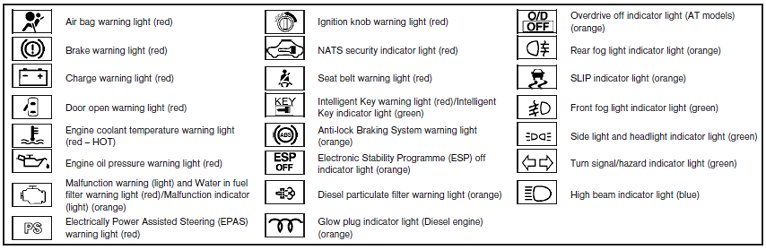

Do these dashboard lights normal?
Just switched on the ignition and for peace of mind wondered if all these are normal?
Thanks
Yup. Normal. The computers are all the same, irrespective of wether the vehicle has the specific stuff fitted. So it self tests and checks that all the lights work, then switches off and only the relevant lights are active. As long as they dont light up while driving you are ok.
