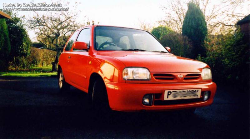

bought it December 2005…
the interior…

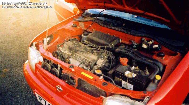

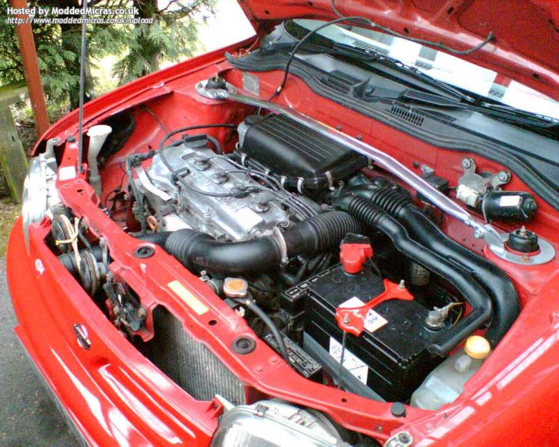

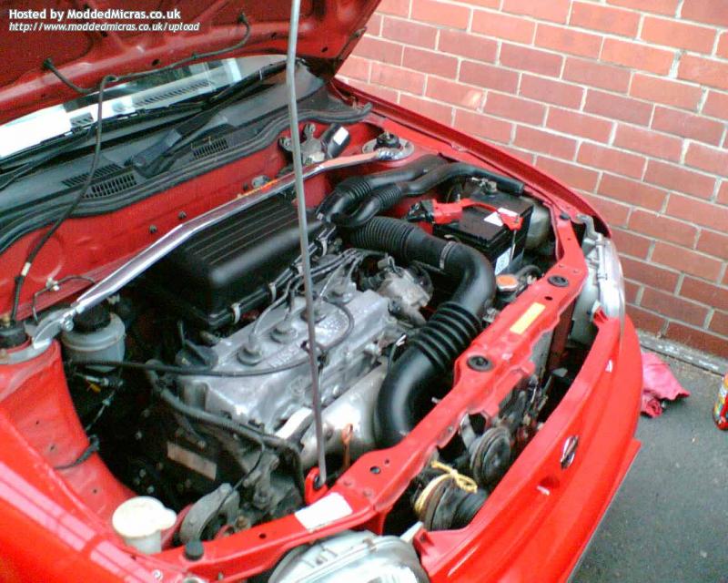

the engine (1275cc)…

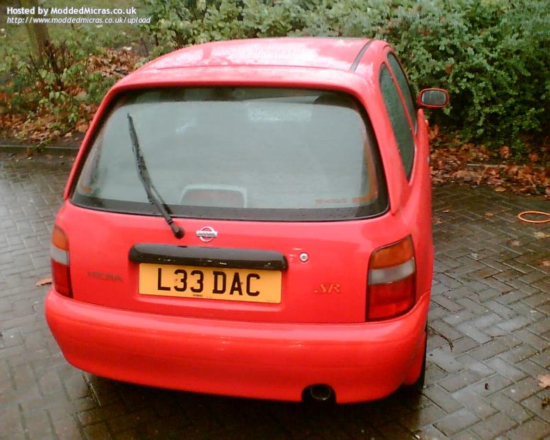

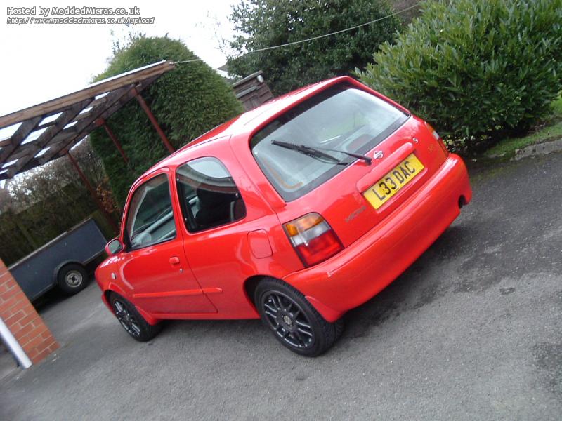

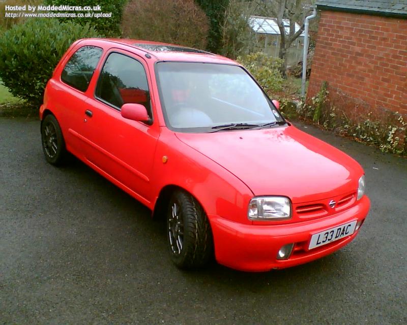

parked on the drive…

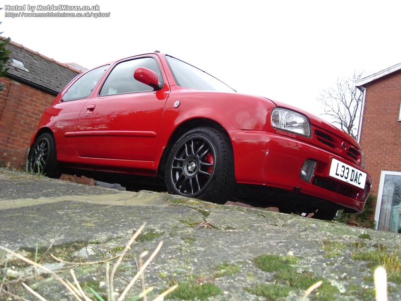

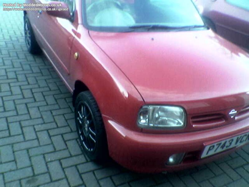

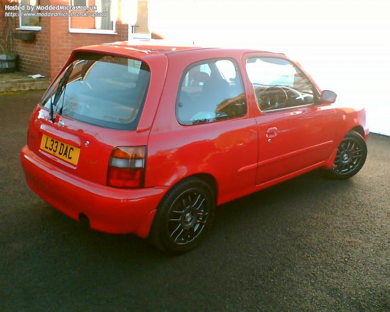

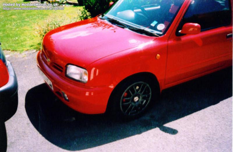

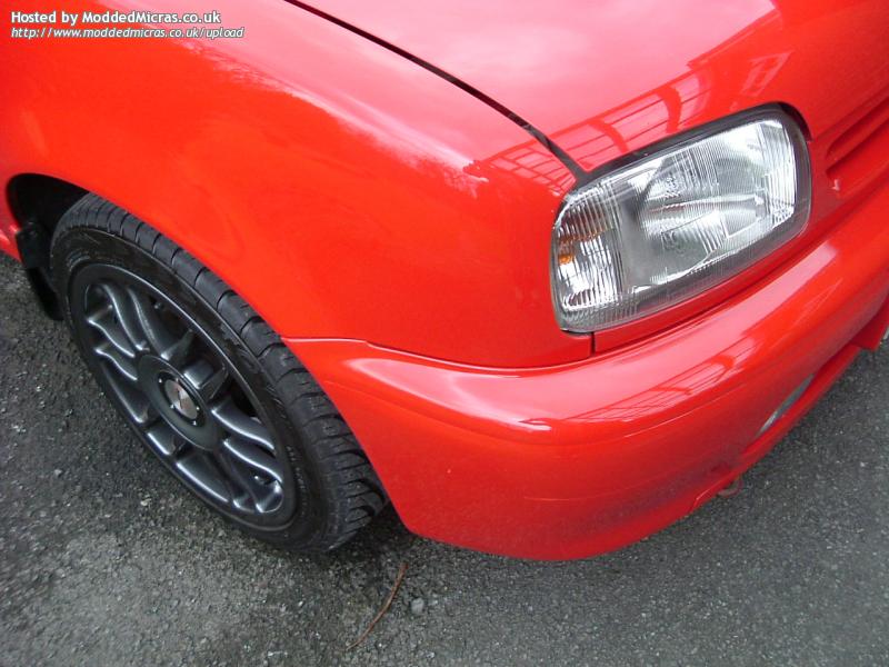

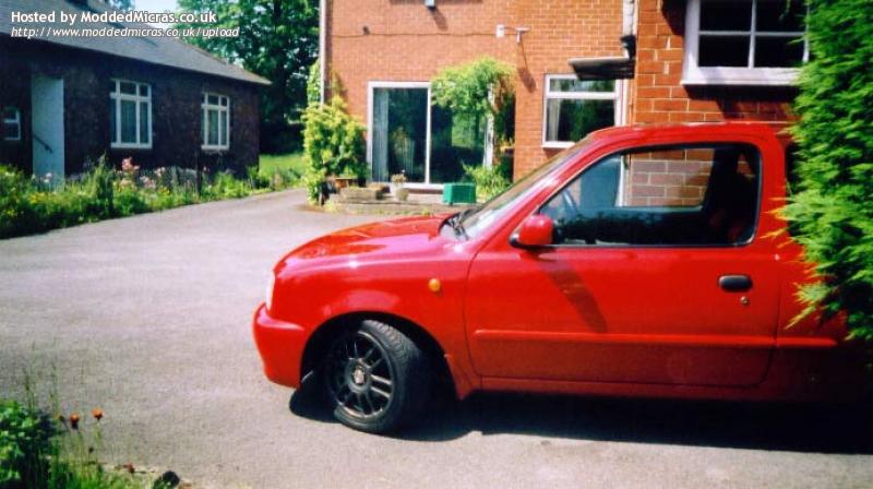

first mod was the alloys…

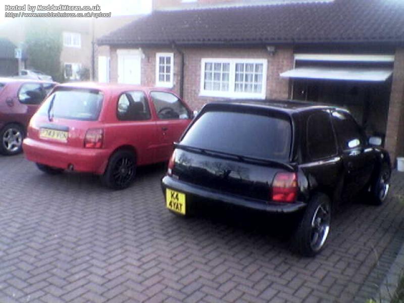

not much of a match against Ayats car lol…(cheers to Ayat for the wheels also)…
back home washed and parked on the drive…

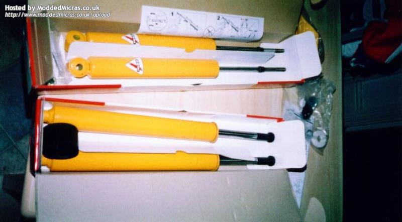

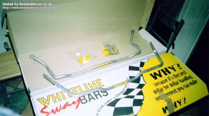

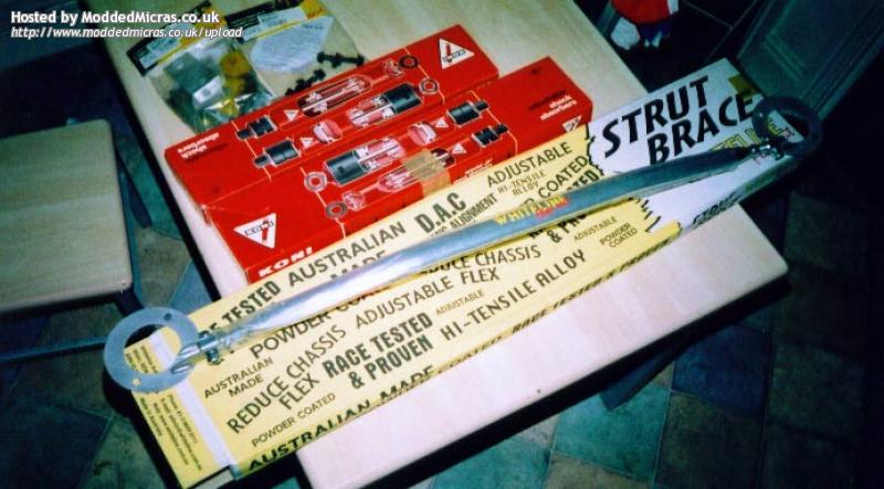

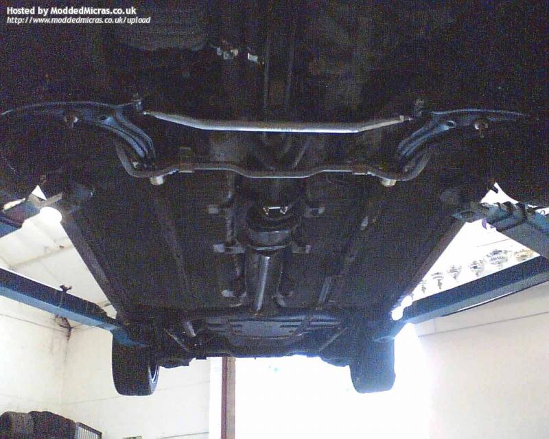

[FONT=&quot]next the suspension was arriving thick and fast after an agonising wait from whiteline (konis)…[/FONT]
[FONT=&quot]
[/FONT]

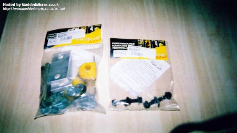

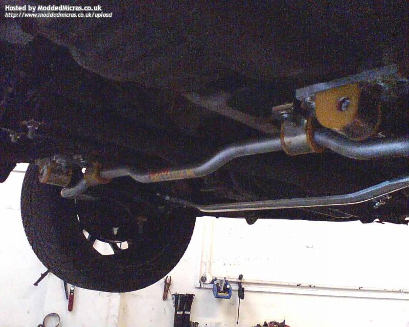

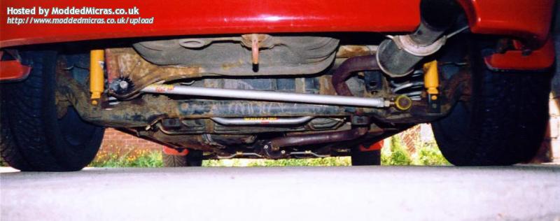

Anti-roll bars…
Castor, camber kits…
more goodies, (see spec for all info)…

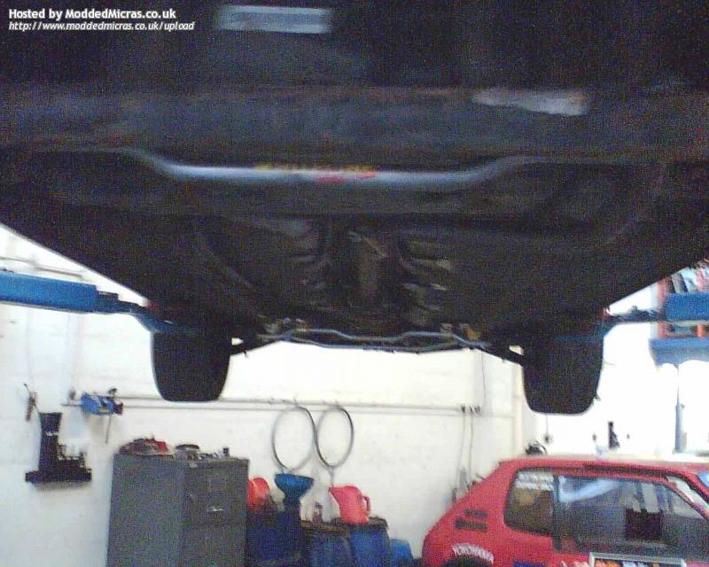

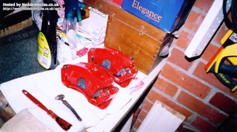

I fitted the fully refurbished Gtir callipers and disks at the same time as the suspension…
fitted on the car and the suspension also fitted…

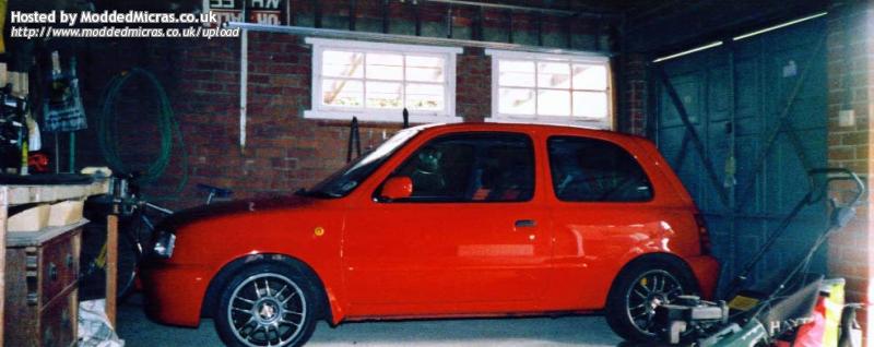

in the garage parked up…

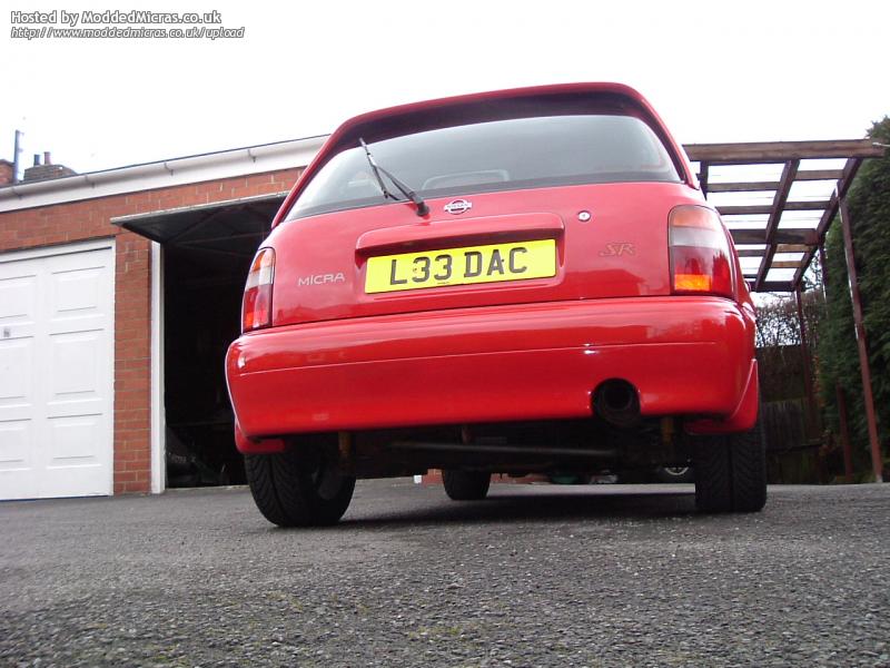

view from the rear…

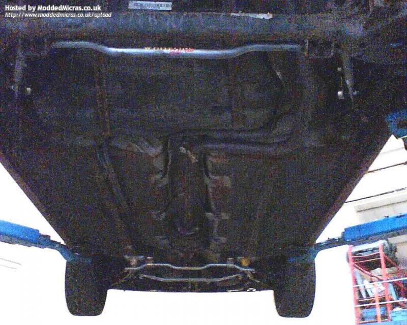

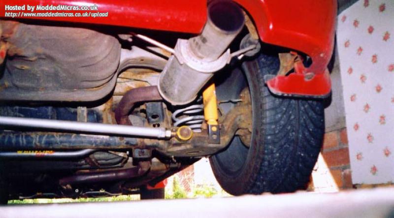

forgot to mention the exhaust lol that was before the suspension but around the same time (month) if ya see what I mean…
Showing the clearance after a couple of days to settle…

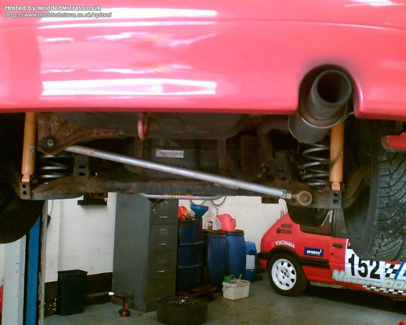

once suspension phase one had settled I was off to get it all set up and the remaining bits added…

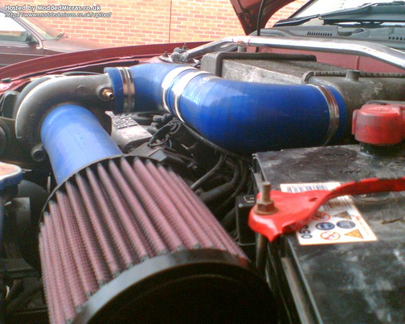

Next some custom cold air feed in the form of K&N panel filter and extra cold air feed…

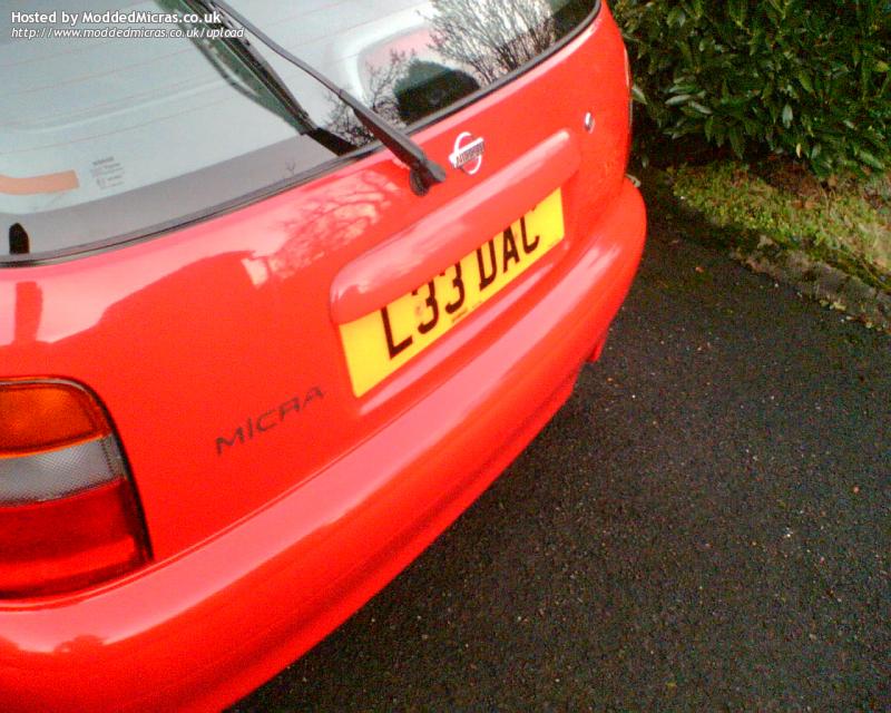

Next was the march rear clusters, subtle and I like it that way…

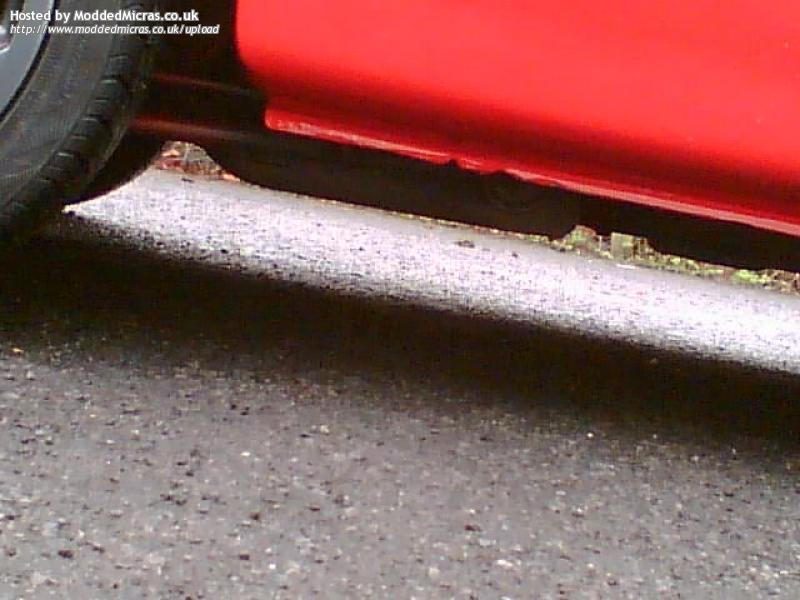

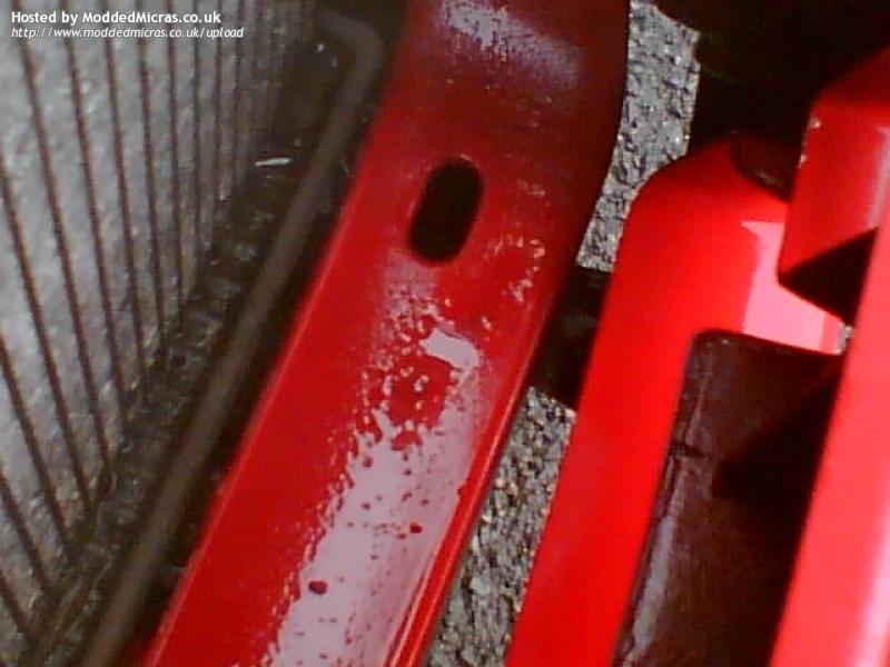

Some MOT repairs to be carried out front cross member…
sills replaced…

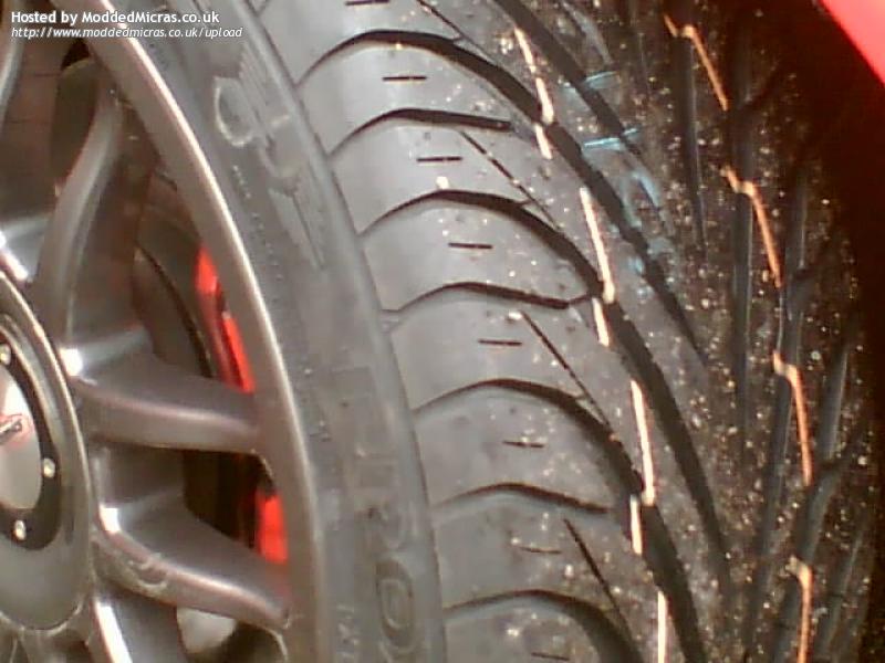

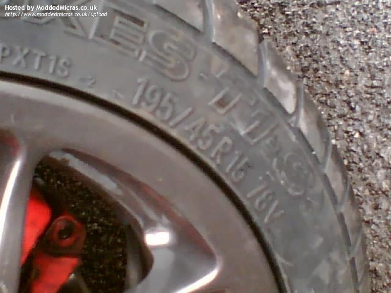

new tyres too (toyo T1-S’s)…
tread pattern…
Toyo…

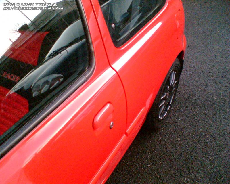

Now some colour coding…(boot handle)
door handles…
more…

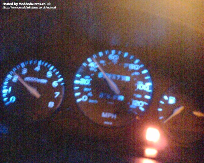

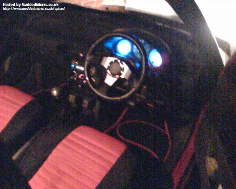

interior was progressing throughout so pics in no particular order…
leds instead of the lights better me thinks…

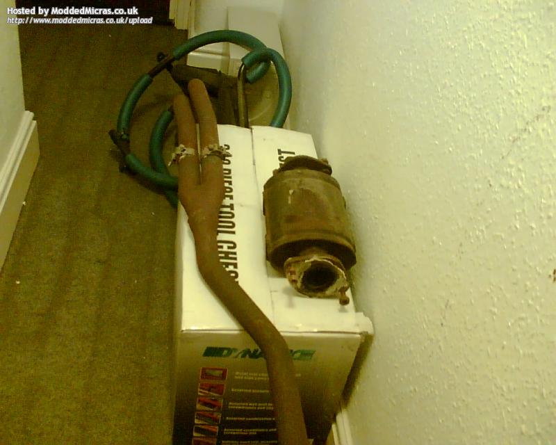

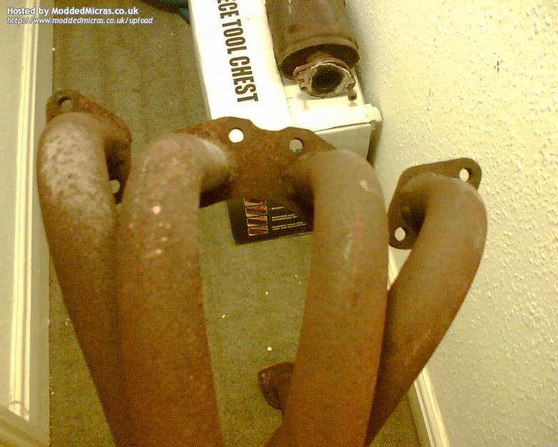

more speed required so a janspeed manifold was added to complete the exhaust system…

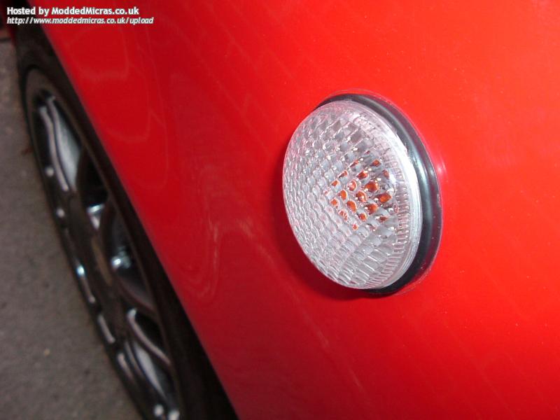

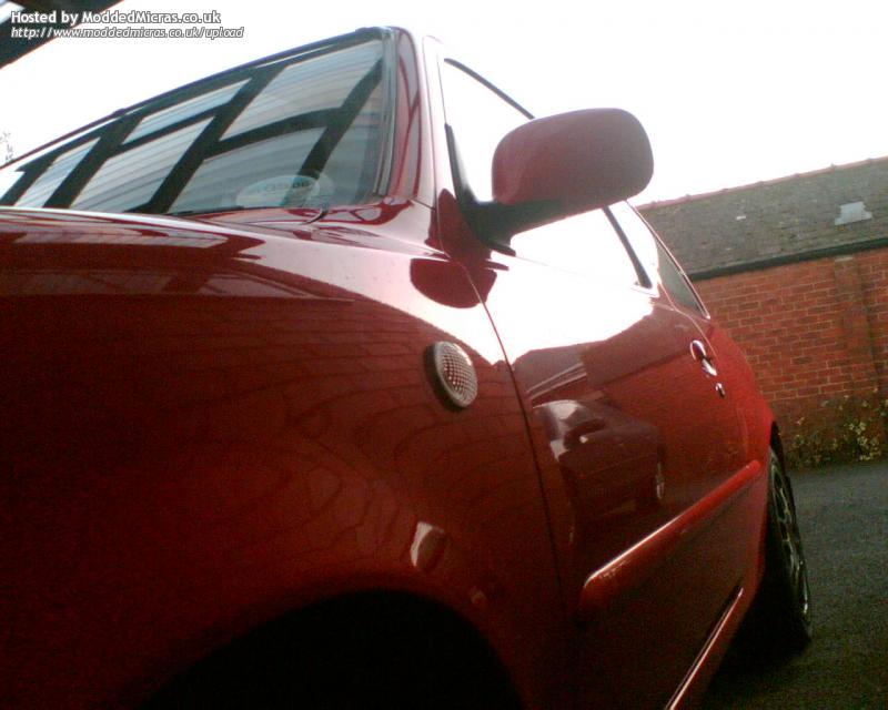

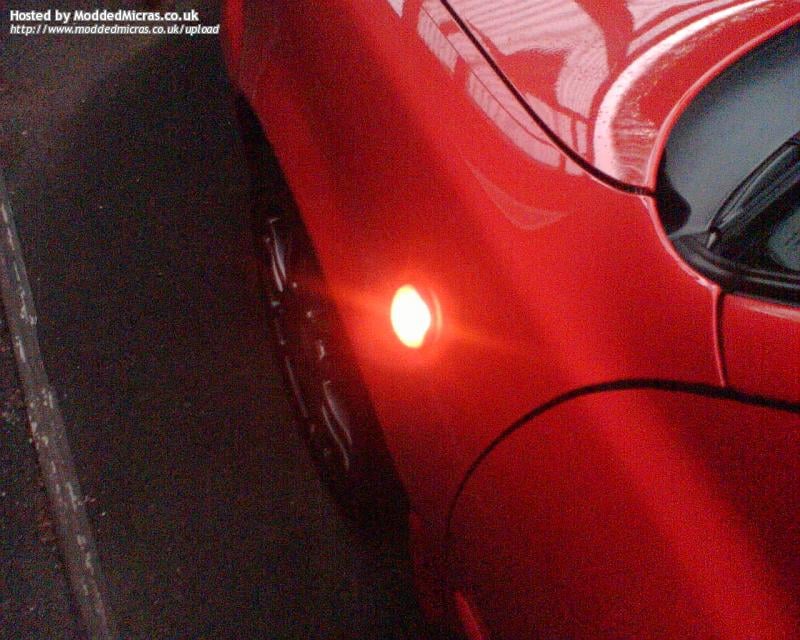

clear side repeaters now…(again nice and subtle)
another angle…

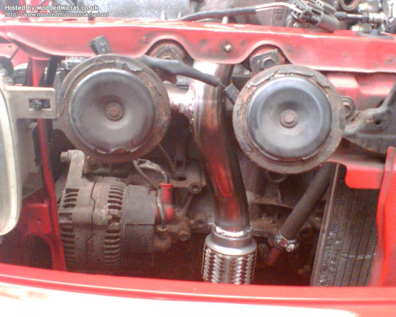

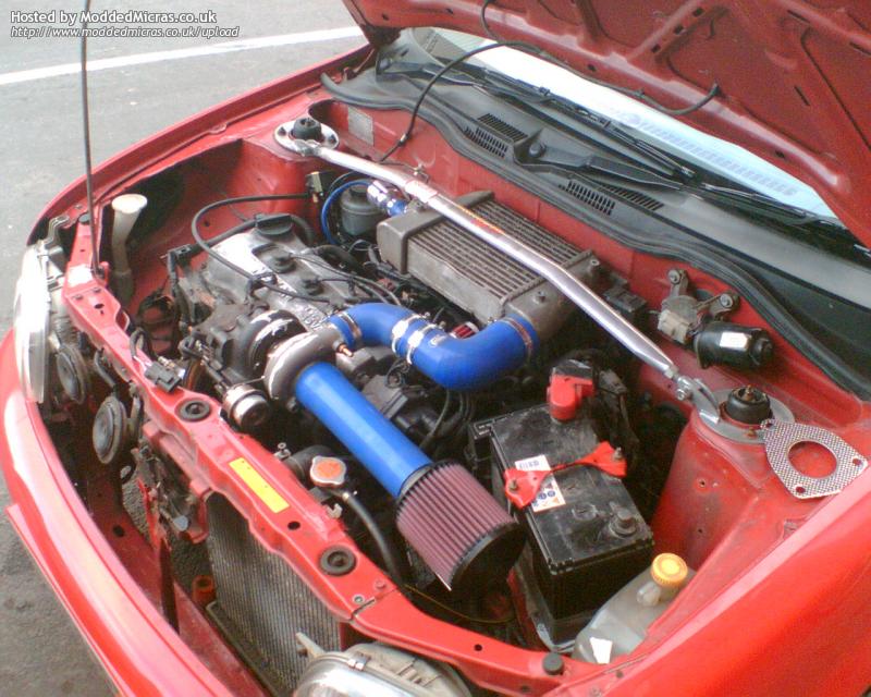

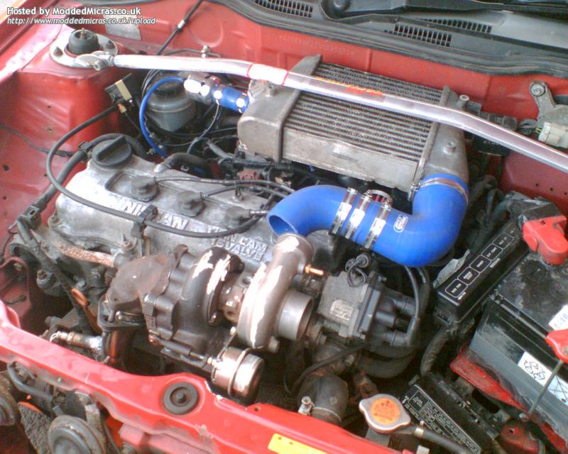

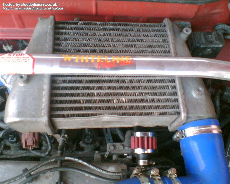

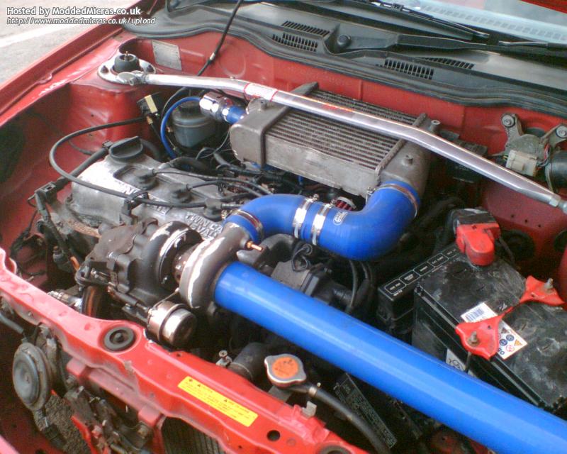

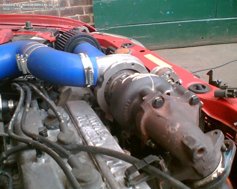

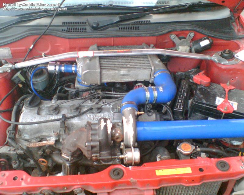

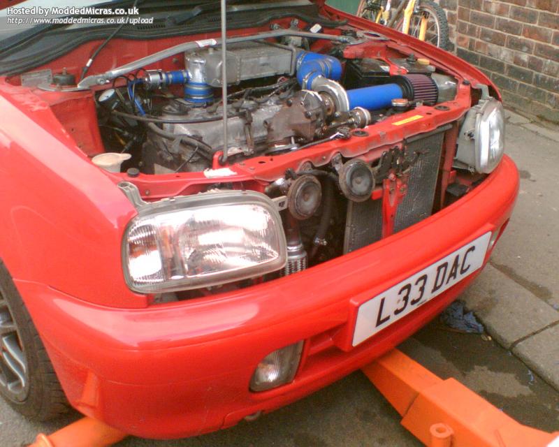

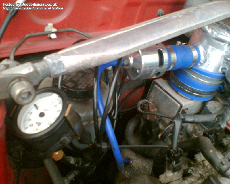

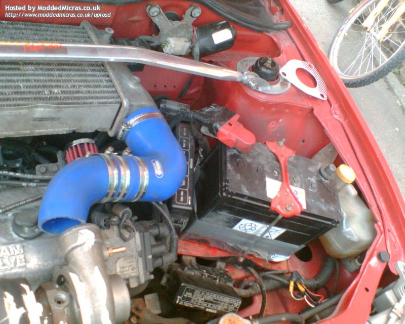

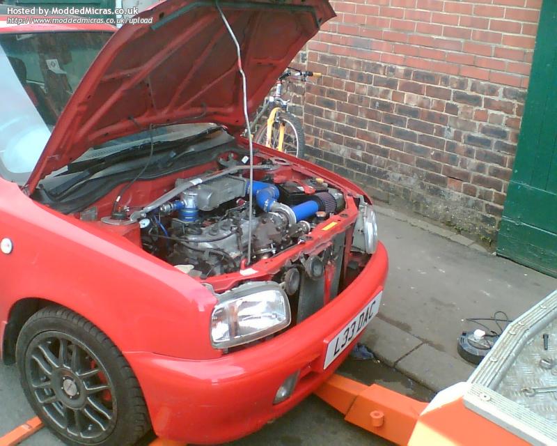

now onto the more interesting stuff…hidden beneath the bonnet is a new surprise(see spec list)…
Dave’s Nissan Micra Turbo
Engine:
CA13DE 1275cc
Turbo: Garret T2
Braided oil feed/return, and water cooled
Intercooler: Calsonic R33
Customised to suit the chosen setup
Manifold: HKS cast manifold
From the Nissan Cube bolt on kit
Exhaust: Custom 2 inch exhaust down pipe, flows from turbo to de-cat
Janspeed De-cat
Powerflow custom cat back system with 3.5inch tailpipe
Engine management: Greddy E-manage
Injector harness
Ignition harness
Pressure sensor
Fuelling: Adjustable fuel regulator
1.6 Primera injectors
Blow off valve: Bailey Twin Piston type, atmospheric dump valve
Actuator: R5 Turbo adjustable actuator
Hosing Samco: – Blue (nice contrast to red paintwork)
Air filter: K&N generic cone filter
Gauges: Rally comp boost gauge
Suspension:
Dampers: Koni Adjustables (internally shortened to suit whiteline setup)
Springs: Whiteline -42mm springs front and rear
Anti-roll bars: Whiteline 22mm heavy duty swaybar front
Whiteline 22mm Adjustable HD rear swaybar
Strutbrace: Whiteline upper and lower control braces
Panhard Rod: Whiteline adjustable panhard rod
Camber: Whiteline adjustable camber bolt kit
Castor: Whiteline castor / traction control arm
Wheels:
Team Dynamics 15 inch “Motorsport” Rim

Front: Toyo T1-S’s 195-45-R15
Rear: Khumo generic 195-45-R15

How much work did the IC need, looks a good nice fit, how muc hboost you planning on running?

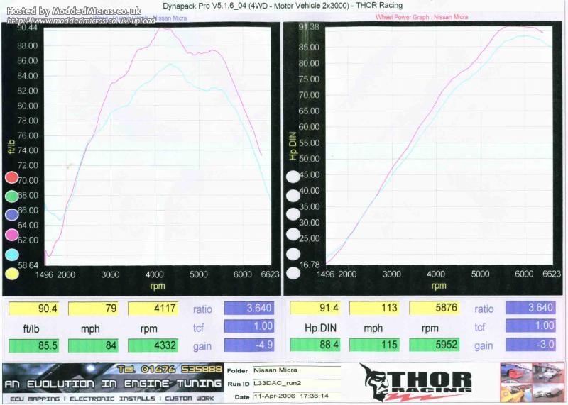

ok people, its raining outside so its no fun to play anymore. ive bullied enough cars so im ok for now, gonna wait and see if it dry's up a bit then ill be going back out to hunt "faster" cars lol

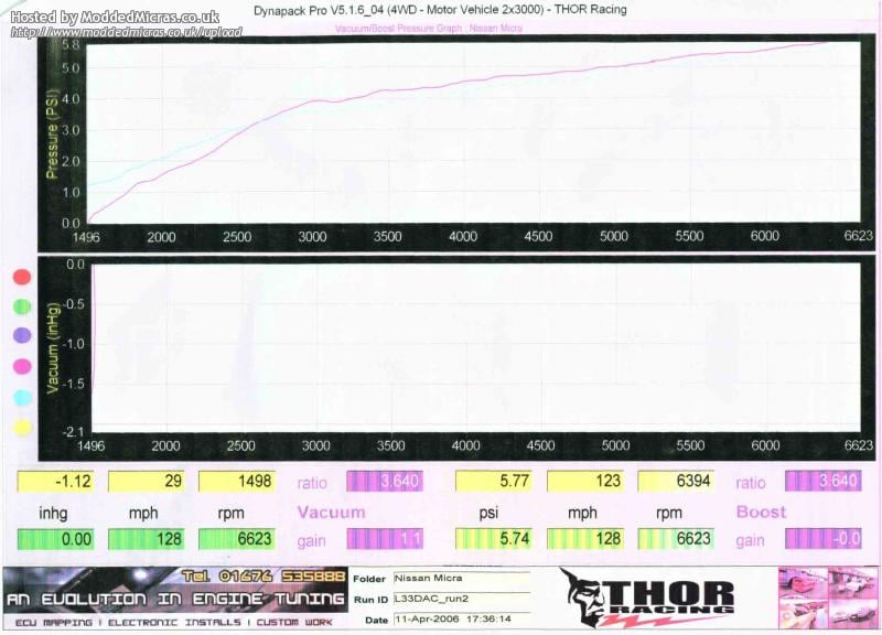

An update for you, i picked the car up late on yesterday. i have included the graphs so you can all see the results.
At first i wasnt too pleased with the results...untill i drove it, Muwhahahahahah this car is SO much fun, ah hahahahahahahahaha i love it!
i would write more but i'll wait until its asked as a question and then ill answer it.
Seriously impressed and plenty more to come... :)

maybe with some adjsutments to the igntion and fuel map that 5psi can give a bit more power. 120bhp@fly perhaps?, that would be a bit more healthy.
Ian
yeah it might be mapped slightly rich for saftey, or mapped so it can still use 95 RON. Better to be safe then go for slight more power and pop it.
OP
OP
Davey C
Davey C
solarice said:
how much did it cost you to get it mapped ? if you dont mind me asking...
just out of curiosity :D
far too much! go and see ed, i dont reccomend thor!
yup your right ian it is mapped for 95RON fuel, figured it was more available and i dont want to have to drive around with octane boosters in the boot all the time incase i cant get any.
it is mapped very rich and therefore safe. 5.5psi of boost is only achieved at redline so im basically tootling around on 3psi and not often taking it above 4K as there is no need lol. (up to 4/5K then change and the torque just drags the car along so well.) overtaking is such a pleasure quick prod of the throttle and you are infront :)
had an oil leak yesterday, noticed it while getting an exhaust piced up. it was the turbo oil feed, was a bit loose so that was taken out cleaned and tightend back up. then i had the intercooler hitting off the inside of the firewall under acceleration so i have removed an inch length from the samco and brought the IC further away from the firewall so that is all good now too.
other than that i havent had any problems. lets see what the next 500miles have in store lol.
when i got the car back i was advised to get airflow to the IC as soon as possible, as this will release approx another 10bhp, then i was also advised to increase the exhaust size from the cat back as at the moment its tiny. only 1 3/4 inch. apparently this will release another 5ish bhp and increase the torque peak and also improve the boost :)
these are all thing that were planned already but i just wanted the car running first to see if there are any other problems before spending more money. need to get the problems fixed first, then improve.
there is so much more that is possible now that the first hurdle is crossed. so now im just going to enjoy the car as it is for a month or so then the mods will start again. however this time i will keep you all posted in this thread rather than keeping quiet lol
