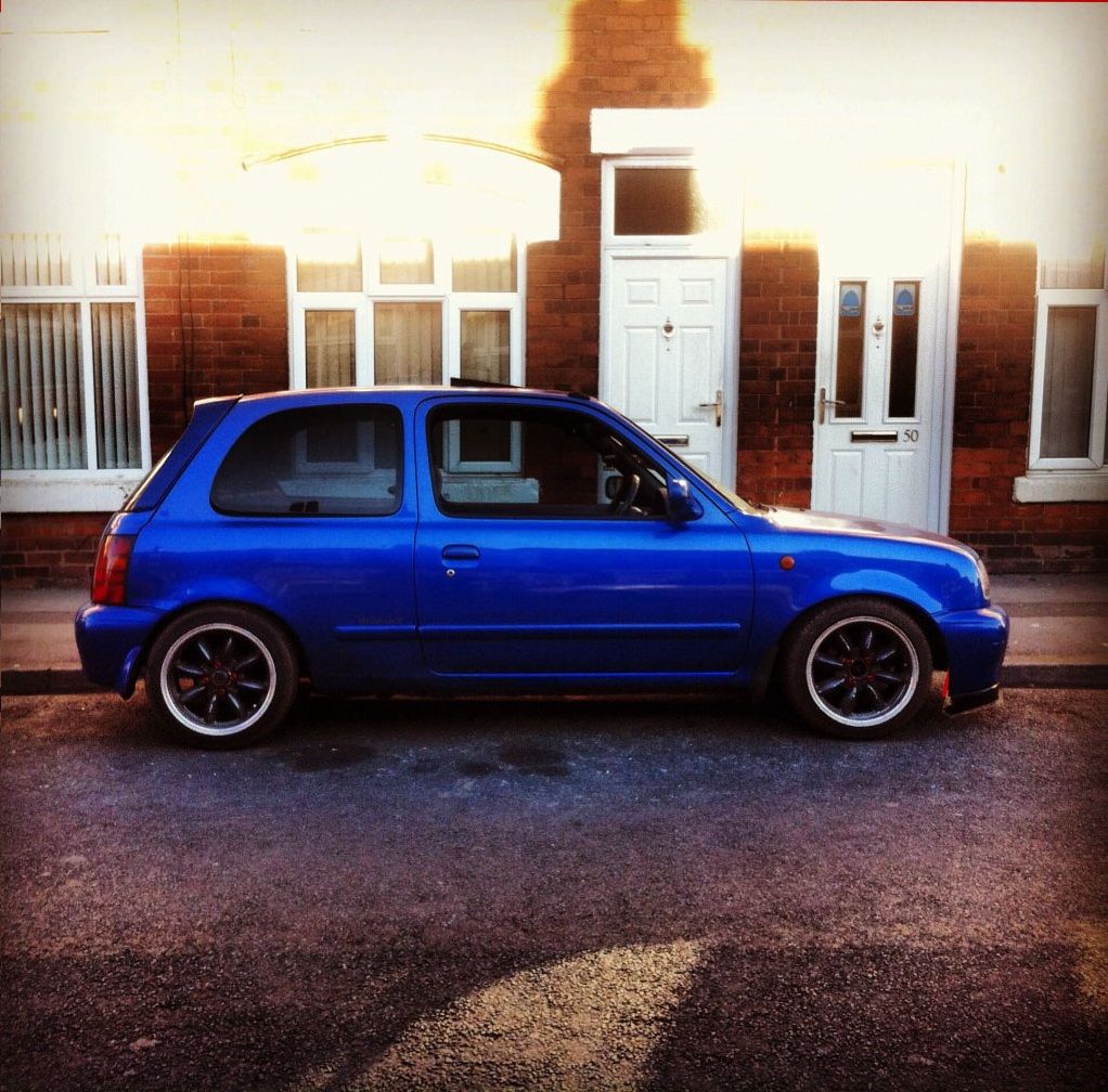

sorry was meant to put a pic up..did a quick photoshop,but yeah this is what i'm aiming for..so would 2 coils all round be about right or should i go 2 n 1/2?

thats 1.5 coils off the rear? im gona need to cut off more then 2 coils all round then to get the look i want?
But if you want to have people in your car aswell itll be even lower so thats why mine is like that, and it looks loads better than satndard but if you want to go lower you'll have to cut more coils off :)

tbh i dont mind as i wont be having anyone sit in the back anyways well i dont think anyone would want to sit in the back with the 15" kicker sub lol i just want it to have just about a finger gap around all arches
It'd also depend on what size rubber you're rolling on...I have a similar arch gap on my 15"s and 35mm springs...

im running 195/45/15 on the front and 175/50/15 on the rear and 2 coils is what iv cut so far just havent got round to fitting them yet
