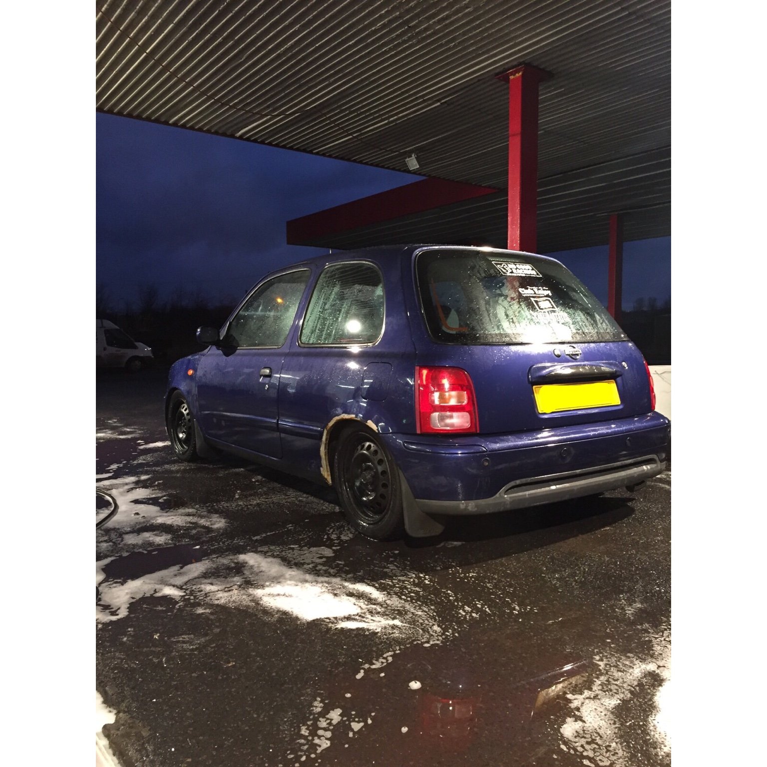

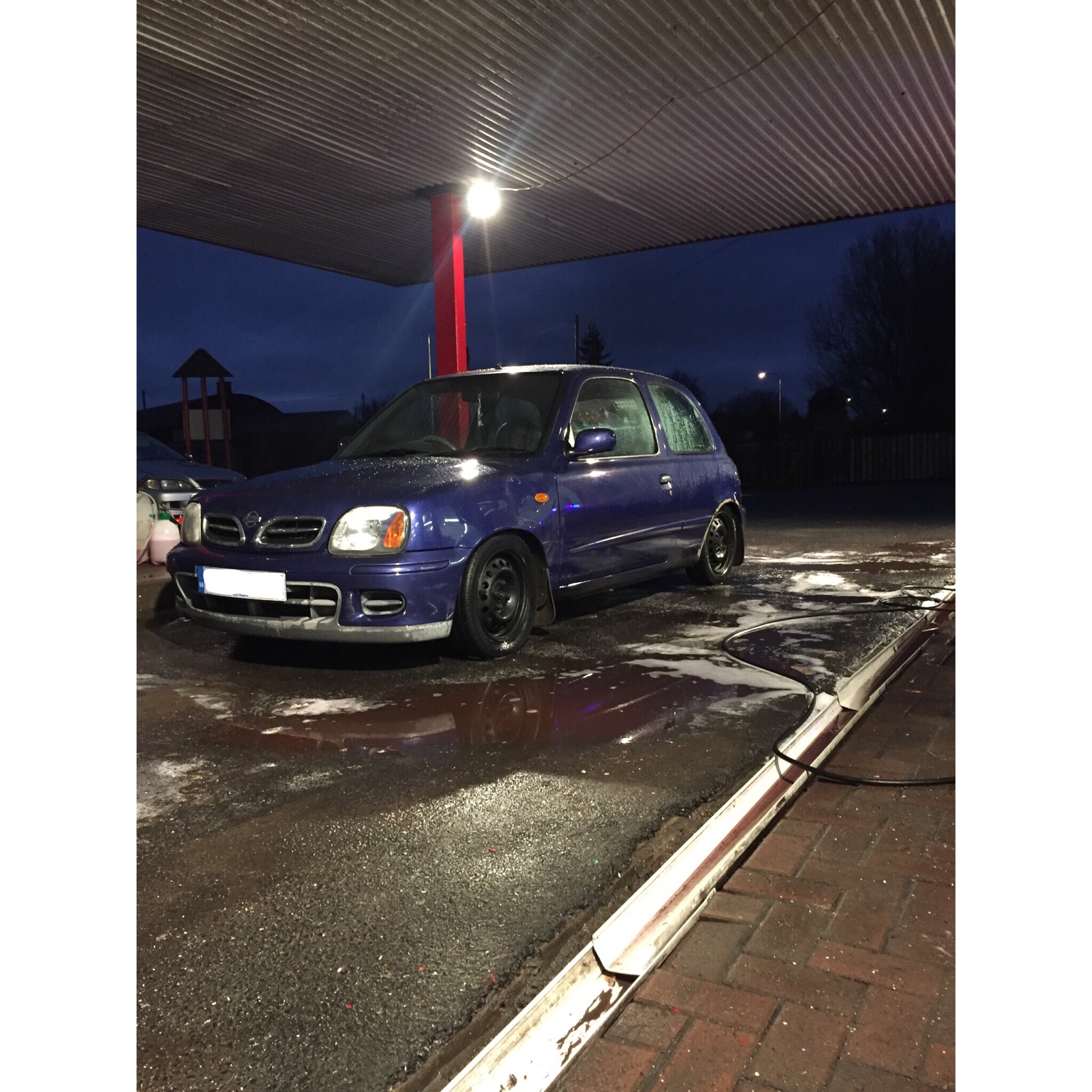

I had a look for BSR coilovers for my k11 but couldn't find any so I just went with corsa B Ones and just had to modify them slightly to fit but they look really good on them

Is there much modifying in the corsa ones? can you post a pic
Just need to drill the Nissan top mount hole a tiny bit so the new strut fits through and just need to grind the Bushs on the rear shocks so they fit in the box section. Really easy to do! And mine are set quite low but they can go a lot further
Ive dropped it more since this pics were taken just don't have any photos haha and they cost £160 from amazon delivered next day
