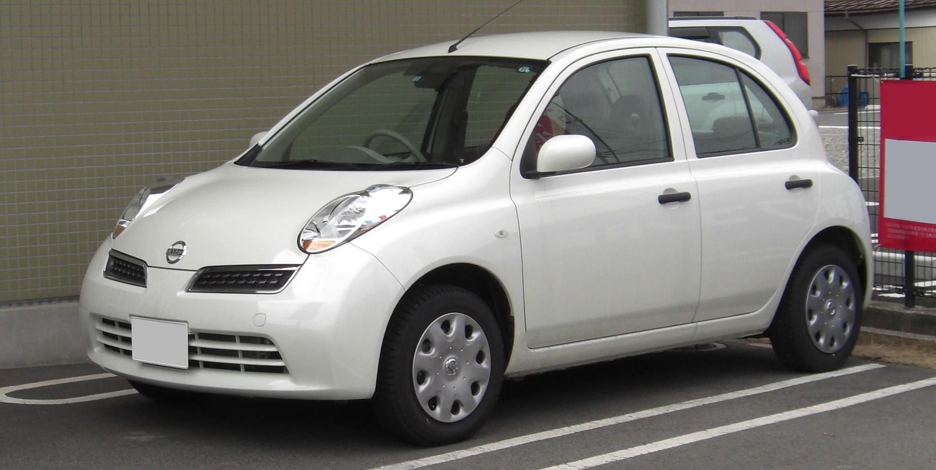

Contrary to Daniel i think you won't have a probelm... if your still at stock height etc. at the very worse you'll have a very comfotable ride and go round the corners like a boat.... the only real thing to worry about is perhaps the tyres may rub on full lock with the splash guard, but if people are putting 16/17" rims on their car i don't really see the problem.
Stock height:
well yeah if the tread is sticking out of the arches you may get a ticking off, but i don't think they will because most cars as standard now days the wheels are tucked right inside the arch...
