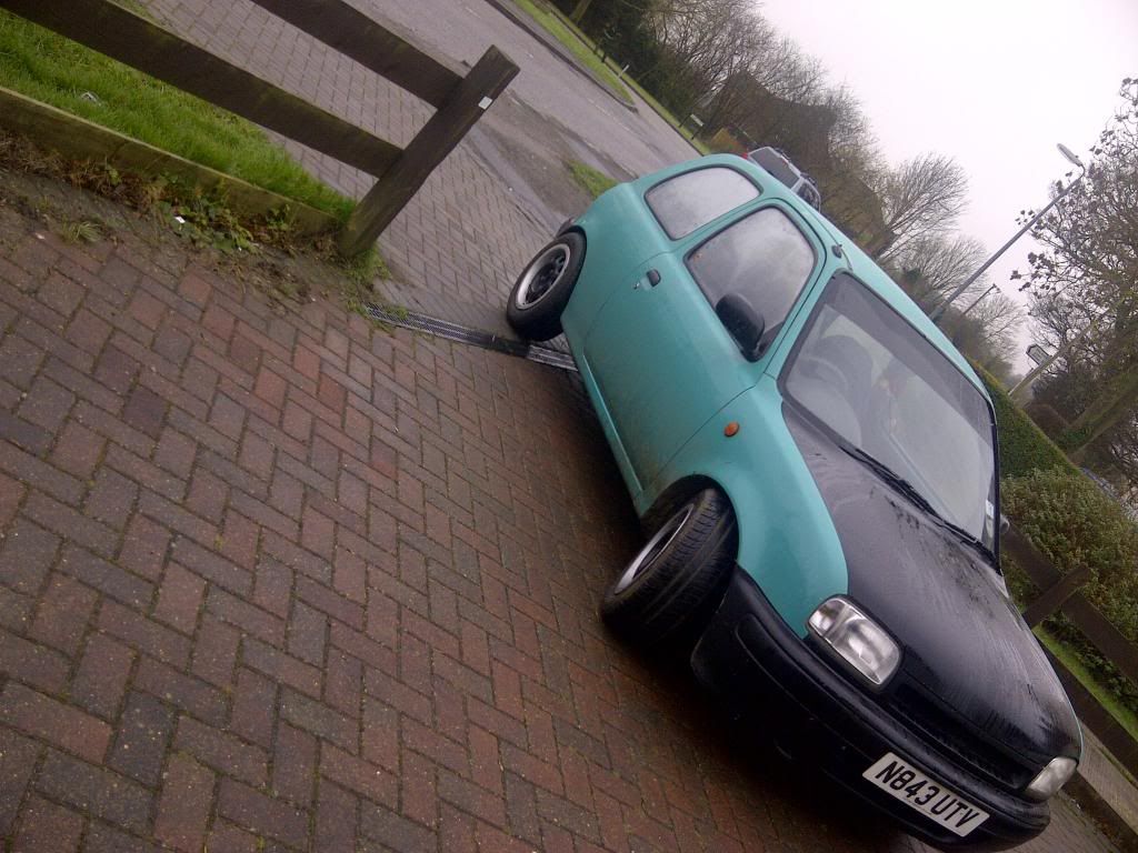

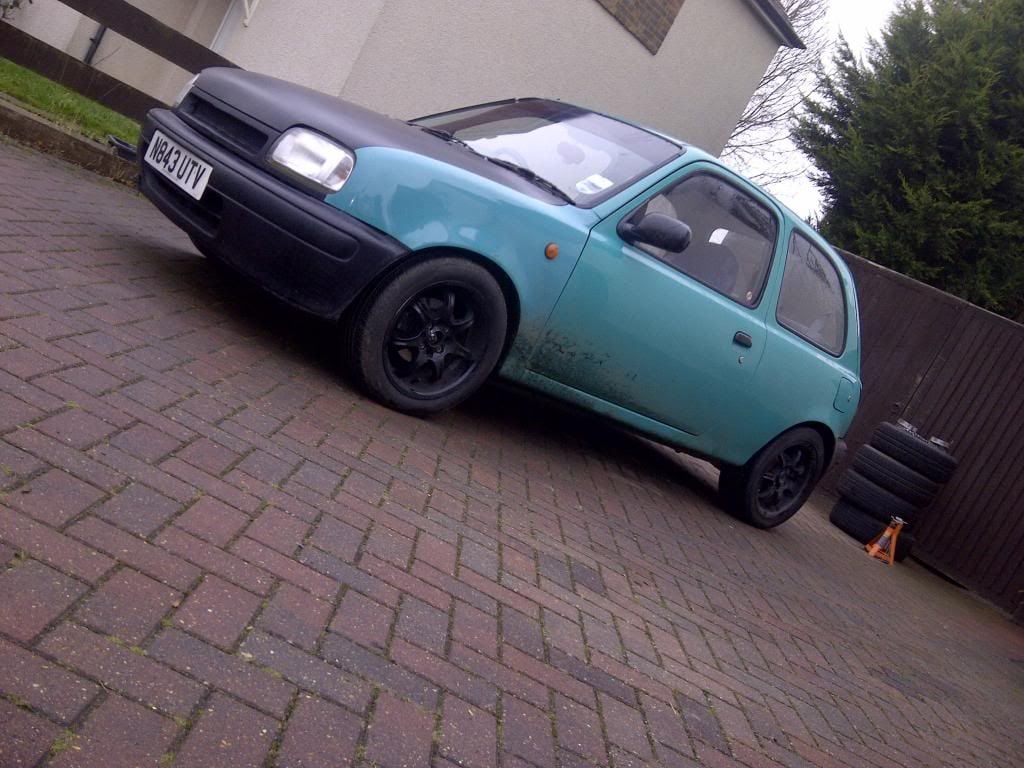

look downwards with a tape against the top of the tyre sidewall, and sight a line down from the arch down to the and top and bottom sidewall, the tape will show how many mm difference in the left and right sideshow would i go about measuring the difference? cant really tell with the 15's on!
the bush is sometimes rusted onto the stump, if not its just 1 nut and lever the rubber one out, then bash the 2 nylon ones inmate just measured it, said its between 10-15mm?
are the bush's easy to fit? any re-welding required or?
