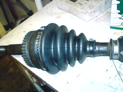

Hi all i have a 2000 nissan micra 1.3 gx but it needs new cv joinst on both sides i just dont know whether or not it has ABS can anyone guide me on what i am looking for?
pollyp
a square toothed sensor ring on the end of the joint like in this pic
k550i-1071-jpg.33393
the hub will also have some black sensor bolted to it with a lead cable going up into the chassis
