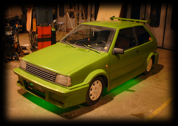

the (outer) wheelarchers have been completly cut out, due to my widebody archers...
i know the rim does line up perfectly with the widekit
but will it rub inside the arch???
That's a really low offset for a Micra. Got any photos of your arch work? I think your only really gonna know the answer to your question by fitting them and see how you get on.
in this picture i got 175/70/13 tires from an Opel Kadett D (Astra mk1 in uk) (unknown offset) ... and these dont rub
the diameter of these tires and the 195/50/15 are almoast the same (2mm larger)
but that low offset could make it difficult for the front tires when turning
