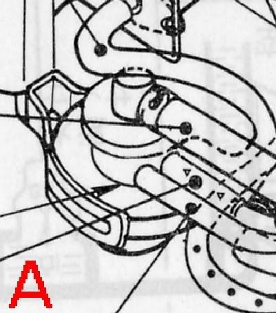

what exactly does this 'UFO' do, what makes them brake and can a new one be fabricated or found on another car?
It controls the bypass valve that in turn controls the switch over from supercharger to turbo, it also acts as a damper to keep the boost on the s/c stable.
They get contaminated with oil and never work properly again and the st is a pig to drive with it gone ,it feels like a really bad misfire
is there no way to split it and clean it?
im assuming theres a rubber diaphram or something in it? can a slovent be poured into it to dissolve the oil and the be flushed out?
If you do a search smidge has split one , bit of a lost cause really because you can't put it back together.
your dead right there's a rubber diaphram and a spring and two chambers

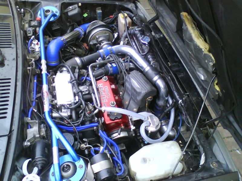

Its to the left of the washer bottle

Can someone do a rough attempt of a technical drawing of what these consist of?? Smidge I'm looking at you, since you've ripped one apart...if you could email it to me??
I am gonna look into getting something made up as I'm almost certain this is the prob with my ST at the moment...and both the ones I have appear to be stuffed...
i got photos somewhere, its pretty hard to get the thing apart in a way that makes sense as to how it works
but what i could do it test the working one i have to see how much pressure it takes to crack the seal on it etc
i dont fully understand what it does myself yet, once i've figured that out then it will be easier to help out
