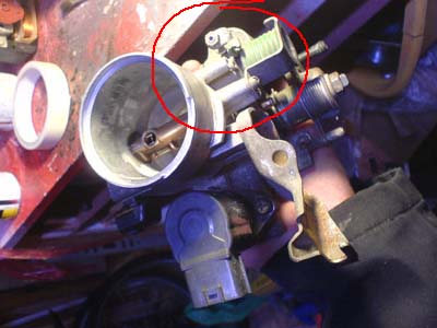

After disconnecting the TB coolant, the coolant operated fast idle waxstat will no longer work (although they tend to age & seize anyway) so the sprung waxstat mechanism that keeps the butterfly open will need to be removed.
the electronic IACV at the front does the same fast idle job. prob a good idea to clean and calibrate the valve making sure it works perfectly.
