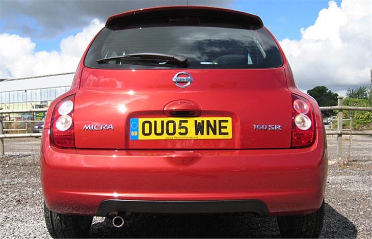

Got my MOT next weekend. I notice when I put it in reverse only one white light at the back turns on. Is this right or is it supposed to light up on both sides o_O ? TIA.
Nope, in these vehicles there is just one reverse light. In your case it's on left side of vehicle. On right side is rear fog light, RED, to increase visibility on bad weather, heavy rain, thick fog or heavy snowing :)
