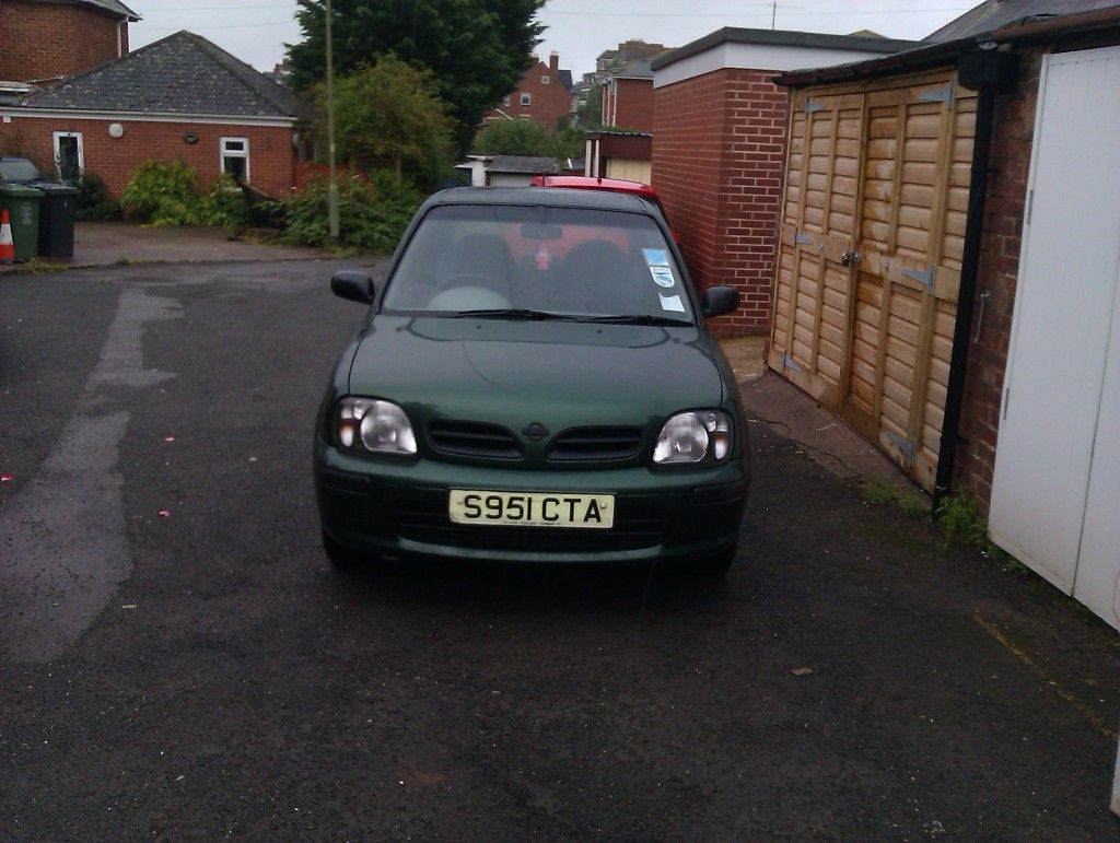

Hey, I have my MOT coming up this Thursday, and I've been told my driver side (right hand drive) reverse light isn't working.
Now, the left one does work, and looking at the back of the car, there does indeed seem to be 2 clear/white sections at the bottom for what could be considered as reverse lights.
Its a Nissan Micra K11c 2002 Tempest 1.0
Now, does it infact only have 1?
I got the bulbs out from the boot, but can't see any issues with the one that isn't working.
Is that the fog light on the right and not a reverse light?
Thanks for any info :)

I turned on the fog lights, and indeed, the one on the right that I thought was a reverse lit up :p
You think I'll fail my MOT for some body damage I have?
Basically, my mum (I won't let her drive it again) reversed into a tow bar of a van, and she thought she wasn't going that fast.
She blew a brake light, and I opened the boot (it does securely lock, but doesn't open as easily any more, as I think the catch has broken slightly), to find metal has jutted in where the bottom bumper is (the size of the tow bar), and was jutting against the spare wheel. The reverse wheel won't go back into its holder anymore after managing to pull it out but is still in the car, but everything else appears fine.
Would this be an MOT failure?
The fix would apparently cost around £400 but I've been told just to get a hammer and fix it myself.
