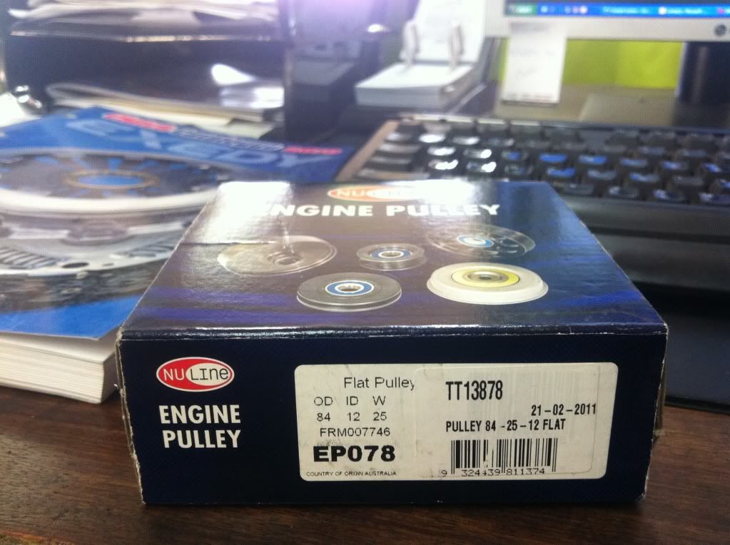

the size of the bearing ? (removal is an option eh :) )

Thanks for that asdame, much appreciated. :)
I'm guessing if mine has the same external diameter I've probably got the same one. I can at least measure that while it's on the car, and then find a replacement.
