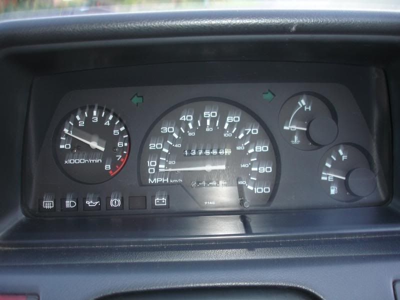

Hey Guys/Gals Have A 1992 Super S (K10)
i have been hunting for the speedo plexi glass for a good six months now,
anyone know where i can find one other than scrappies cos i keep checking there anyways, do you think nissan dealers would be able to source one for me?

well because mine is the super s it has a rev counter instead of a clock so there would be a hole there just wanted to know if i could get hold of that exact cover as i have tried and broken 2 other ones so far! grr

i have 1 hole on the trip meter thats it... every other k10 has a clock instead of a rev counter and has 1 hole on the left instead of bottom center.

Only the Super S plastic bit will fit. The dials are slightly different in that the plastic tabs at the top and bottom are not interchangable with other sets of dials.

the above is wrong and there not LS clocks, the LS clocks didnt have a trip meter so no hole, they have no hole at all. ive had the dials with the clock along side the super s clocks and the trip reset appears to be in the same place soo, you should be able to use the front off of that but it would mean you hace a hole over your rev counter.

right ive been having a play, i had a rather battered LS clocks cover. and ive made it fit the super s clocks.
little guide for you. i have pics on my phone but my lead is still missing.
there are 6 clips, 3 on top and 3 on bottom, the middle ones will need to be cut off leaving the 4 corner ones on.
you will need to measure the hole and drill it, if you havent got anything to measure off (i.e. the old cover) then ill give you the measurements.
there is also something else to do. on the super s clocks 2 triangular locating things are on the bottom, these are not on the LS ones, so you need to cut these out, you can mark them by putting the cover on and drawing around them.
be carefull as ite perspex and will smash as the first sign of abuse.
do not pilot the dirll hole start off with the size you want, and i find it best to use a blunt hacksaw blade for cutting.
