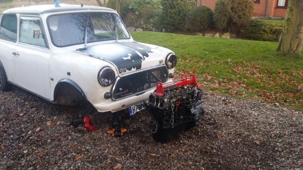

My car needed a new 998 engine so I sourced one that happens to come with a clutch still attached.
Took the broken engine out of the car
And carried it to the garage

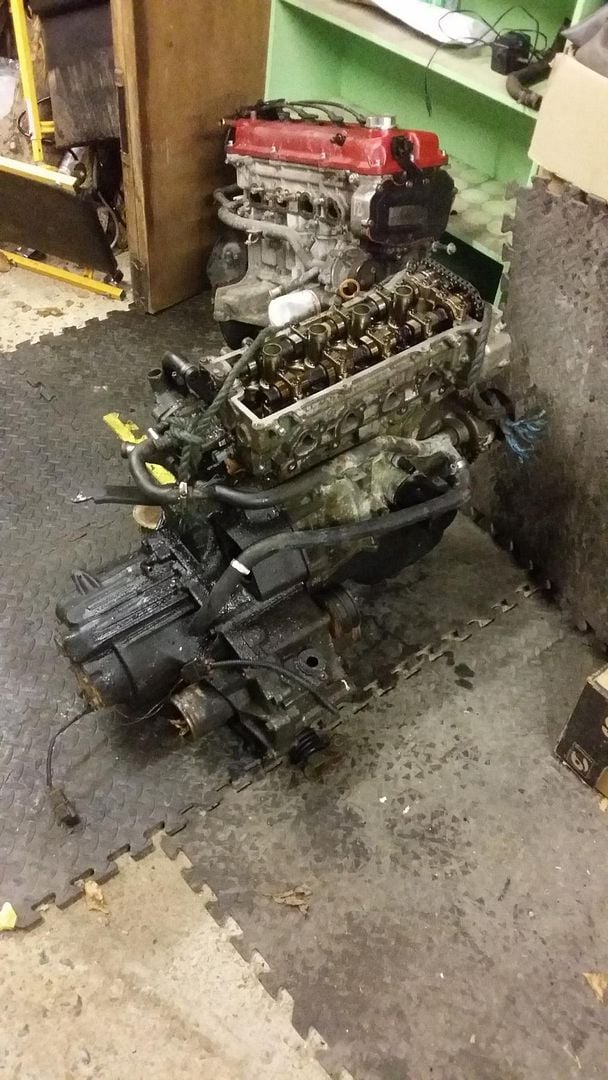

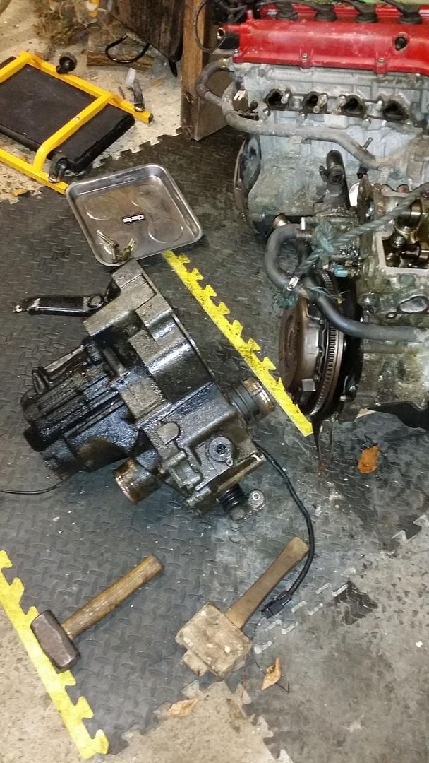

Plan was to take the gearbox off the rubbish engine and fit it too the new one and change the clutch release bearing and have one good engine with a good gearbox and clutch :)
Howver got the gearbox off fine

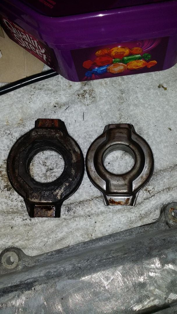

But the clutch release bearings are different sizes
So I've worked out the broken engine has a 180mm clutch fitted and the good engine has 160mm fitted
The clutch bearing bracket thingy
Doesn't fit the 160mm clutch release bearing I've got so it's evident I need to get a new 180mm clutch kit in order to use the gearbox! So more money :(

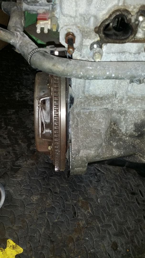

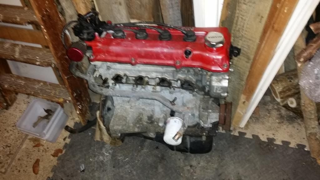

New engine
(No gap between flywheel and engine)

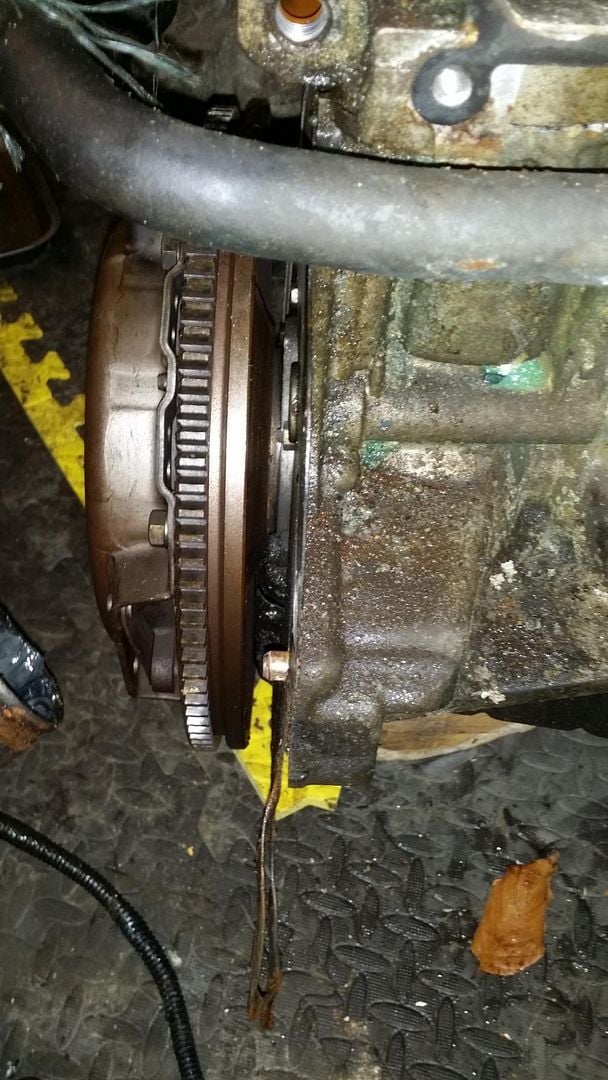

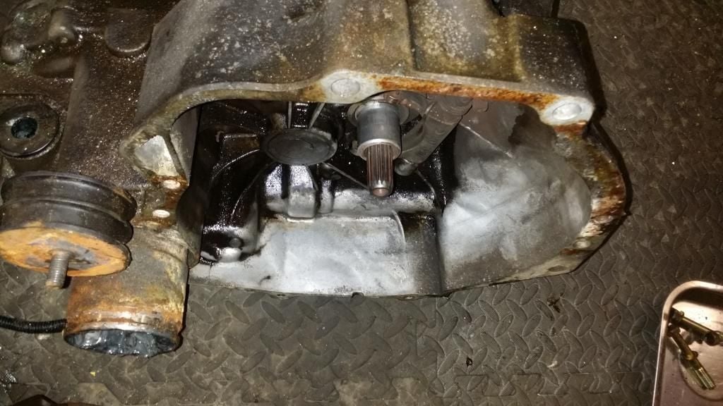

Old engine
(Huge gap between flywheel and engine)
So will my old gearbox fit the new engine?
Many thanks
Lawrence
Right I've read that blog after a bit of googling. Many thanks.
So I need to fit the old engine flywheel to the new one and buy a 180mm clutch kit?
Then the gearbox will fit ?
mine has the smaller f/w shafts g/box etc and a hybrid clutch lawrence (covered many times on here) its the only option unless you want to fit the later type running gear
