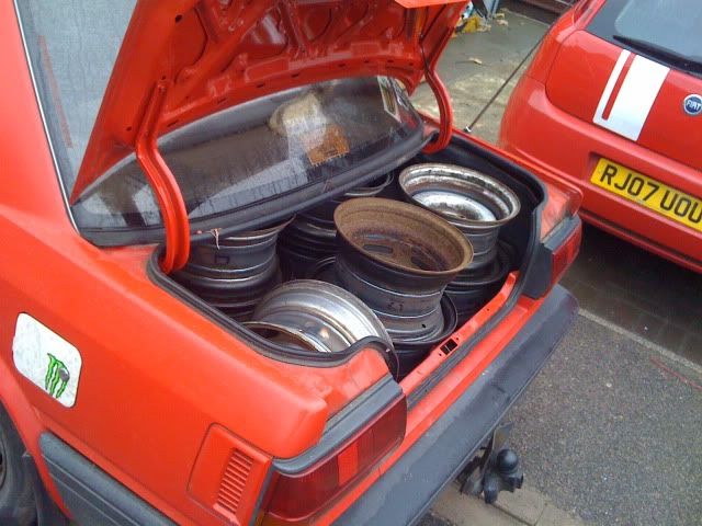

they usually band the inner well like this eh, but that gives an ugly (in my opinion) step inside the rim, and that previous pic is two 5 x 13 wheels cut and shut to make one 6.5 x 13

np mate :) and doing the wide ones was a bit of a mission tbh, but just reversing the middles is far easier, here,s my 14,s with an et of 10 on the front and 0 on the back
Reversing the Middles I thought would be a good plan, how did you go about it did it balance up ok?
they,re pretty idiot-proof, the middles are a very very tight fit in the rims, you could actually drive the car without rewelding them, (not recommended :p)
haha cool stuff. im guessin by reversing the middle you aint making them wider though. but they do look super good
yeh, 14 x 5, here,s my only remaining two 13 x 6.5 cut-n-shut ones for the 1/4 mile
