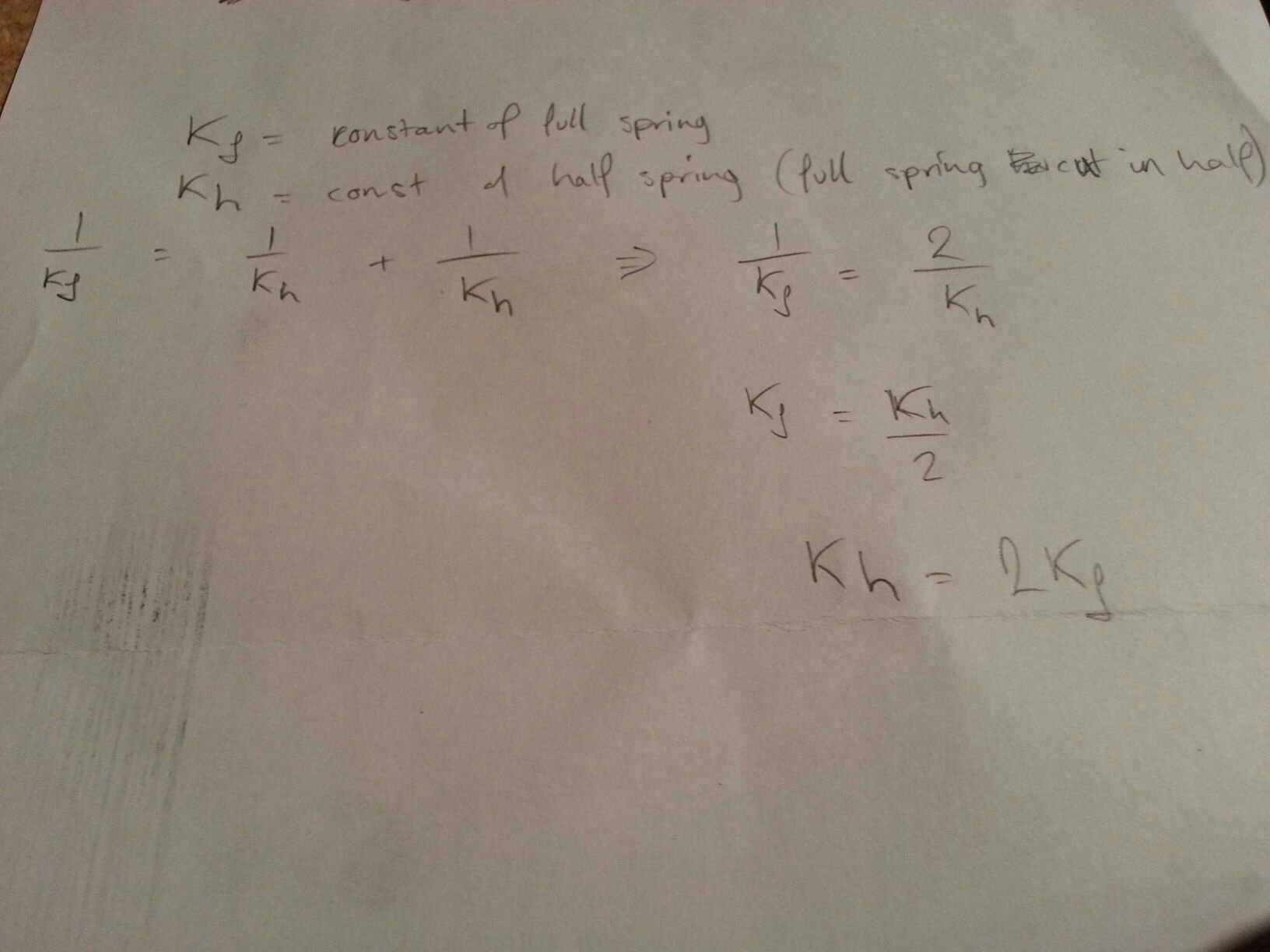

I will start with my short workings (using the equations for adding springs in series).
where Kf is the spring constant of the full spring and Kh is the spring constant for the half spring...
So that maths/physics states it will get twice as stiff if they are half the size? Still a part of me that thinks they will have the same spring rate.... :/ Join MicraPro in being confused haha
I'm such a tit, you guys are right... doh. New game, spot the amateur mistake I made in the above sketch.
Hint: YOU CAN'T ADD TENSION OR COMPRESSION TOGETHER
:oops:
Energy in a coil adds that way, not force. In my defence, it's been what... 7? 8 years since I did my A levels?
On the energy note, the spring is only capable of absorbing half the energy if cut in half, so it's still only half as good at doing its job :rolleyes:
:oops:
Only just saw this lol. You spotted your own mistake so can ignore my post on your blog :). Though hats off for keeping it simple and avoiding kx etc... I haven't used that in ages either :p
Oh I did in some of the PM's I sent, feel like a right numpty now. Can hear my mechanics lecturers smug voice as he corrects me all over again haha
