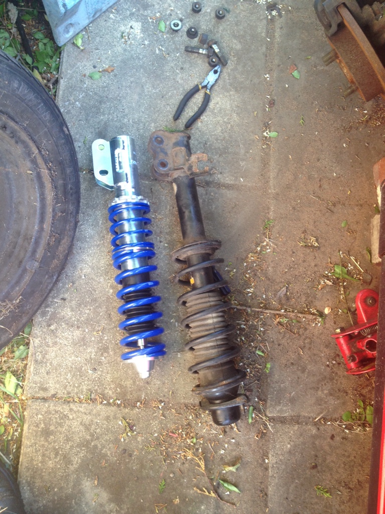

so here's both

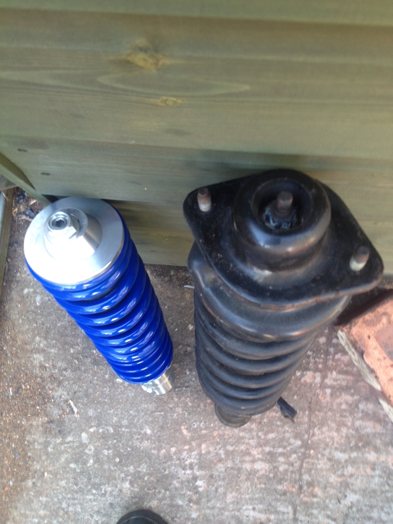

both top mounts guessing

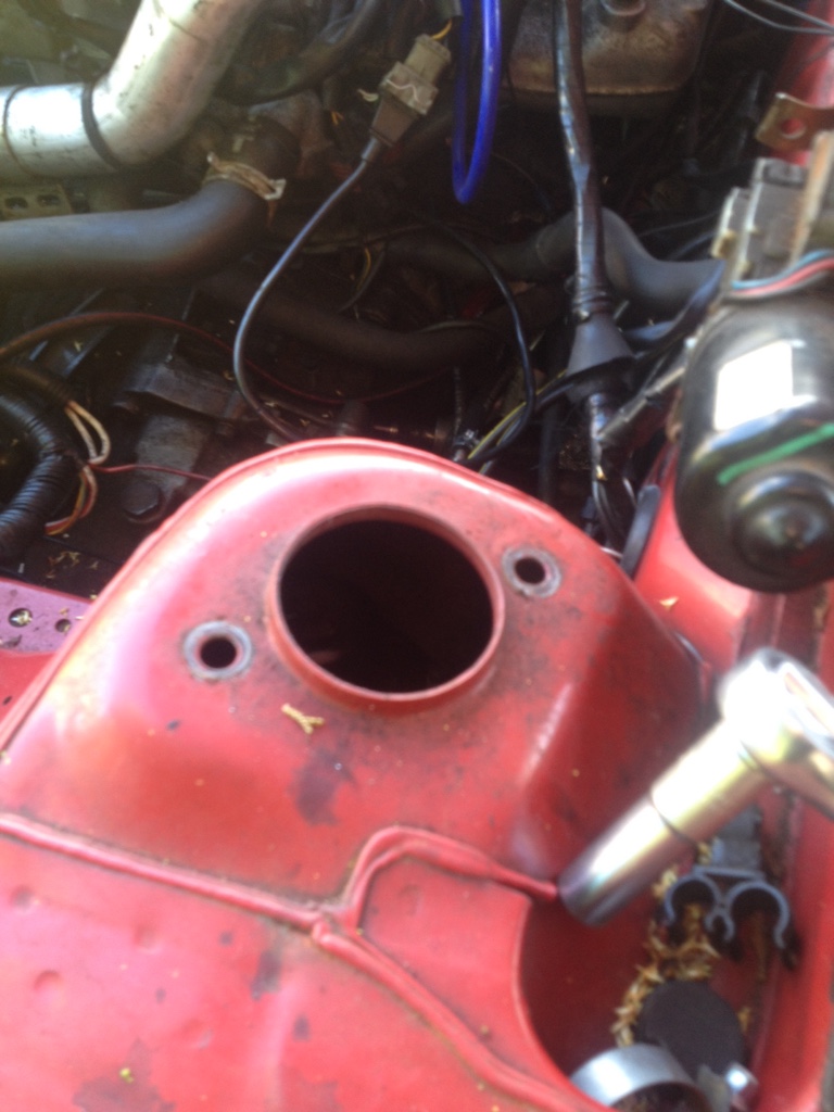

both holes looks same

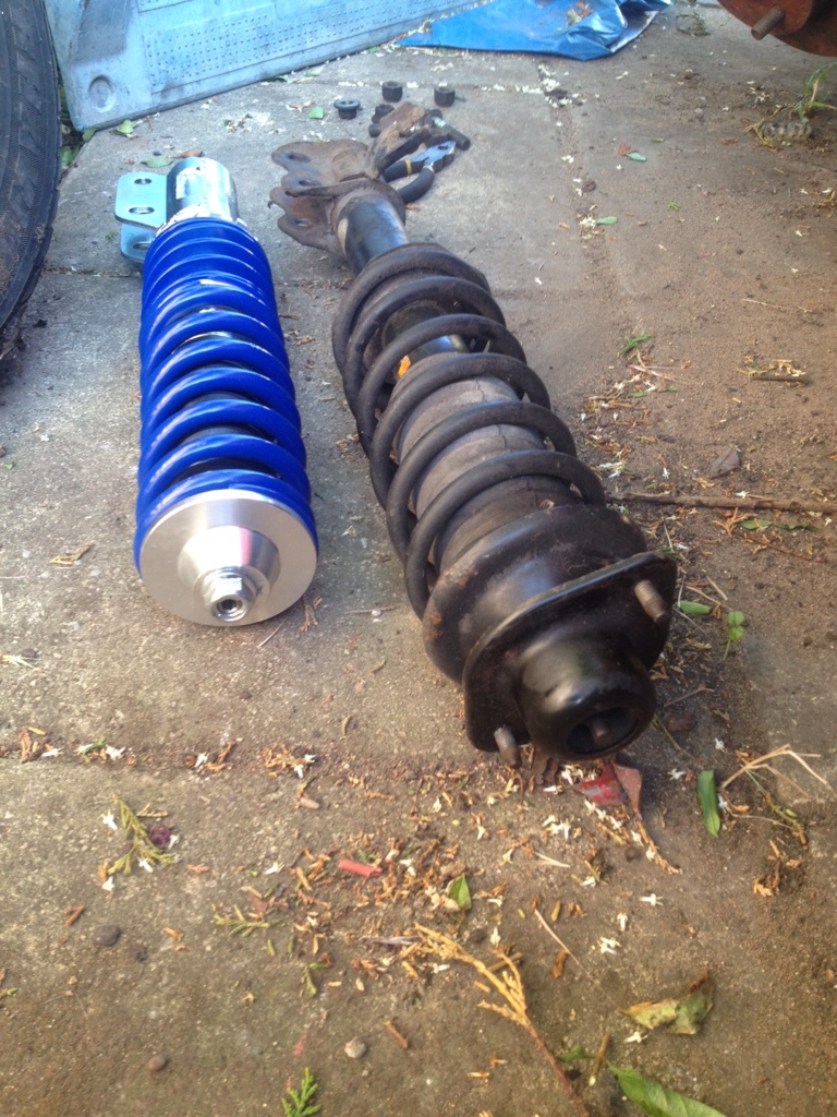

size looks ok not to thick

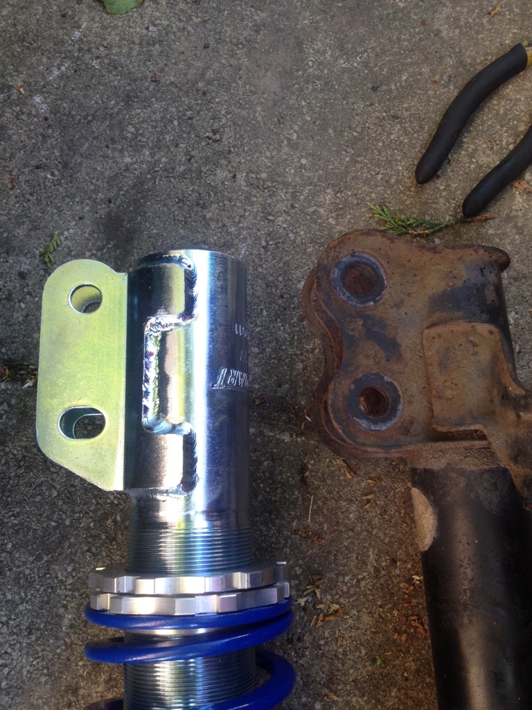

do I do anything here
damn son it all rust free :)
micra top mounts on it first,without old spring percher . widen piston hole cause its wider than k11 one
