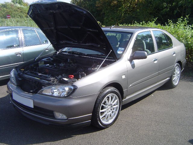

a few on npoc.co.uk have modded ones to fit the primera. should be easy to do the same to the micra. they just used one of the standard wing bolt holes for the lower and drill a hole in the side of the lower bonnet skin for the upper, but you have to cut out a small hole in the lower bonnet skin to get a nut and a spanner to the back of the drilled hole.
here's a couple of pics, but couldn't find a close up of the bonnet.
