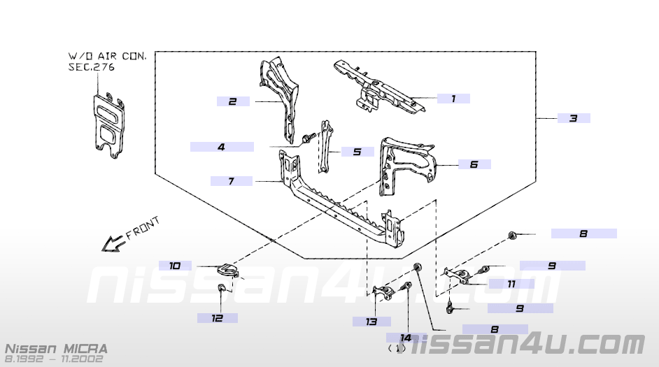

Hi guys, did anyone removed and installed a new front panel? Any advice on how to do it?
Number 3 on the pic:
most people use a spotweld drill baguete ( a flat drill that drills through the 1 panel only), then drill holes in the new panel and plugweld the holes with a mig :grinning:
Ive just done the lower x-member in my k11, was fairly easy and straight forward, use a spot weld drill to drill the welds out, drill holes in new panel and plug the holes, (exactly as frank says)
there are 2 types of spot drill, the one frank describes or the one i used which is like a little hole saw.

Thanks guys, will get a spot weld drill and see what i can do. Can i install the new panel with rivets? Will it be very weak?
the lower crossmember is structual eh baguete (and needs welding) but is,nt yours undamaged ? and cant you cut the nearside headlamp panel and flitch panel complete from another car and splice the whole upper corner on ?
The problem its the price, Nissan sells the left headlight panel at 50€, and the whole front panel on a parts store is 40€, and they dont sell only the headlamp panel, and its much cheaper than buying it on Nissan. But i will try to see at the local scrapyards if the can cut and sell only the headlight panel. But the headlight panel can be riveted?
no rivets are a no go in my opinion, as frank says the lower member is structural, whats wrong with yours, why do you need to change it all? got any pictures?
ah just seen pics in your blog, id do as frank says, try and get the whole corner, including some of the inner wing if needed, and then weld/rivit it on, you should be ok riviting if its not structural, or if you cant get the whole corner, get the complete front panel from the parts store, and cut off the part you need, i.e. the headlight surround
Ok, i will order the complete panel from the parts store and only use the corner i need.
