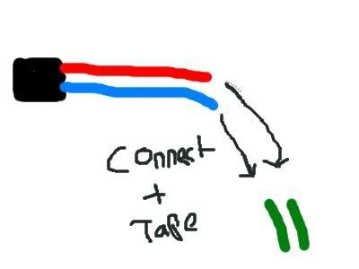

Well I got the cig lighter I reckon all I will need to buy is 2 wires and a thing to go on to the wires so I can slot it into this plug thats in the dash is this correct?
Well to save a bit of cash just get some spade connectors to plug into the lighter, then run wires from these down to the original wiring, cut and connect, then tape together. Make sure the wires are the right way around.
If you need an amazing diagram here goes:
The black blob is the lighter, the red and blue lines are the wires from it. The green lines are the original wires in your dash. The thin black arrows show a connection lol.

It's better to cut and stick the wires as fitting a plug to your cigarette lighter would mean doing that anyway.
