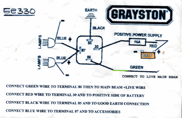

All my lights are fully relayed, the normal micra lights are not wired up via relays, this causes a volt drop. I fully re-wired them, running direct from the alternator, and relays for each feed i.e. dip, main, lamp pod, corner pods / spotlights. The spots work via switch on the dash so I can have main beam and then choice if I want spots.
So you've got the spots relayed to the altenator then to a switch on the dash so they're practically seperate from the main lights? Sorry for being a pain, never wired spots before so just looking for advice also lol. Thanks
Right so I think I got it? Its connected to the main lights using the relay then? Or I could instead of connecting to main lights run that to an on/off switch?
