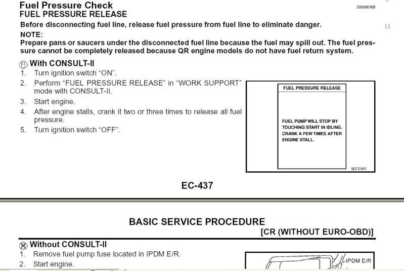

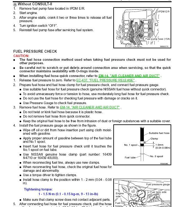

...Model T . Went out this morning to fit my new injector only to find there's now way to relieve the fuel pressure in the system before starting work grr. With the OBDII system, there's no way to do it, there is NO fuel pump fuse. I tried disconnecting the connector at the tank but this must cut the sparks as well because the engine turns but doesn't fire grr.
Any suggestions other than torching the ####### and buying a K11?
