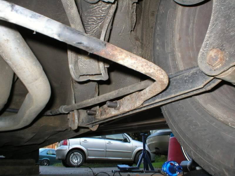

can anyone please tell me about the anti role bars on the k10. Iv heard some 1.2s have them. Does anyone have any pictures of them and can someone explain how they work. I wanna know what im looking for when i go down the scrappie!
it looks like this:

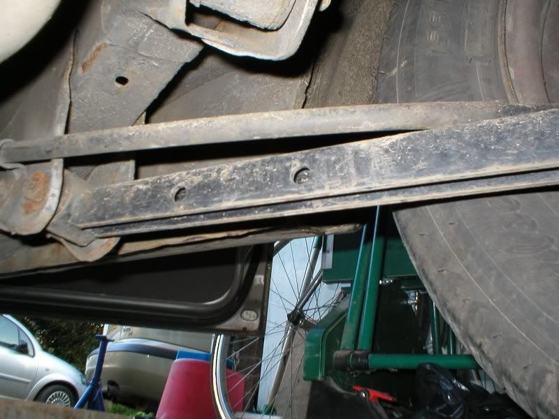

and bolts on here:

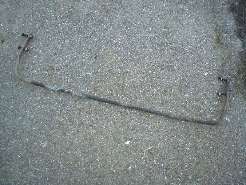

like this :D:
i think its made quite alot of difference too, so well worth it. One thing to note is that if your k10 is a facelift 1.0l you might need the suspension links from the 1.2l k10 or a prefacelift 1.0l as yours might not have the mounting holes.

just to confirm my facelift '91 K10 doesnt have these holes, i had a ganders last time i was underneath it thinking about this mod :doh:
looks like even on the facelift though you can do the conversion. all you have to do is aswell as taking the bar from the scrappy, take the rear suspension link it mounts to aswell.on both sides?
