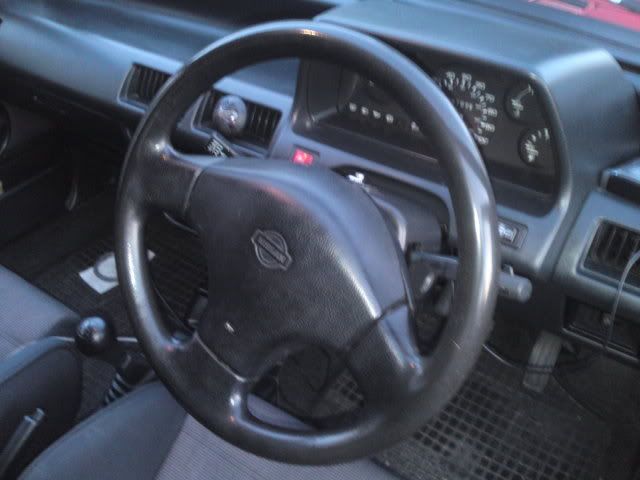

just to let you know the steering wheel was a perfect straight swap! no hassle, the indicators cancel and the horn even works from the standard switch
and the wheel cost me a fiver :)
Here it is
i thought it looked similar to the k11? mind you i havent seen a k11 one so i dont know how i drew that conclusion! :)
It'll fit a K11.
Some primera's came with really nice steering wheels, and some came with blue bits of leather. I'm not sure what models they're specific to, because I've seen them in GX's, SR's, SRi, GT's etc, but if you find one of those, they're the don.
just easier to turn than the super s one and now it looks like it has power steering :) also the colour matches [erfect with the rest of te trim
