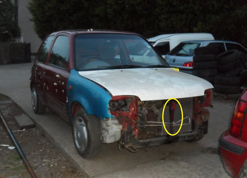

Yeah I've done it on my car, and nope wasn't really blogged I did it almost instantly when I acquired the car :(
..Covered in masking tape to mark every stupid annoying little dent and half stripped front end to do a facelift to prefacelift conversion.. "
-Straight from my blog.. The bar in-front of the radiator/behind power steering pipe is the one I'm talking about in-case anyone doesn't know lol :D
Other than that, swapping the full front end I've not noticed if the cars any longer.. but it all bolts on fine like :)
I prefer the prefacelift front end felt there's more I could do with it to make it look different and unique lol, didn't see many ways of changing the facelift front end in a way I would like haha
That's the bar that needed swapping out. Solved the problem by replacing it with the bar from the prefacelift donor car :), as simple as that lol
