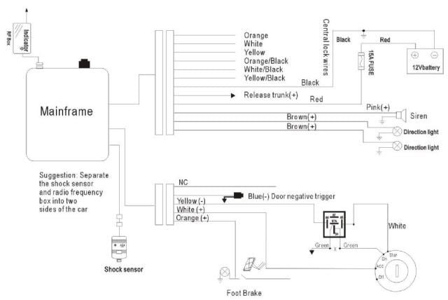

Hi, i need your help, i bought an Alarm system with shock sensor, central locking control, door triggered, etc...
Here are the install diagrams:
My question is: the 6 wires to the central locking control connects to which wires in the Micra loom? Thanks

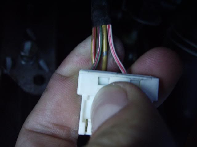

NeX, here are the pics, it has a box with two connectors:
When i removed the smaller one, the C/L closed all the doors:
Can you help me? Thanks
right looking at that i assume you have a 3 door,
the red and yellow wire is the one you need to interface with, but first you are going to have to find a normally closed relay.
let me know when you have that and i will tell you what to do next

No, its a 5 door... Normally closed relay? Ok, i will source one. Thanks

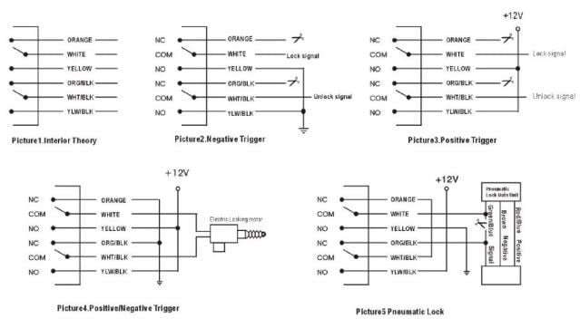

NeX, just realized that it is sooooooo simple... lol
Just need to slice the red and yellow wire, and the 2 ends connects to orange/black and white/black wires on the alarm, because the alarm has internal relays... The orange/black wire is the normally closed side of the unlock signal relay and the white/black wire is the common wire of the unlock relay. So, no need to use an external relay to control the OE central locking. The schematic that you draw its just to use with aftermarket C/L, not OE...
Anyway NeX, thanks alot, without your schematic and explanation i couldnt realize how to do it. (Y)
yep spot on, that looks like my diagram too lol
some control boxes have internal relays with normally closed options, if yours does then you should be able to do it without a relay like you said. hopefully it should all work!
