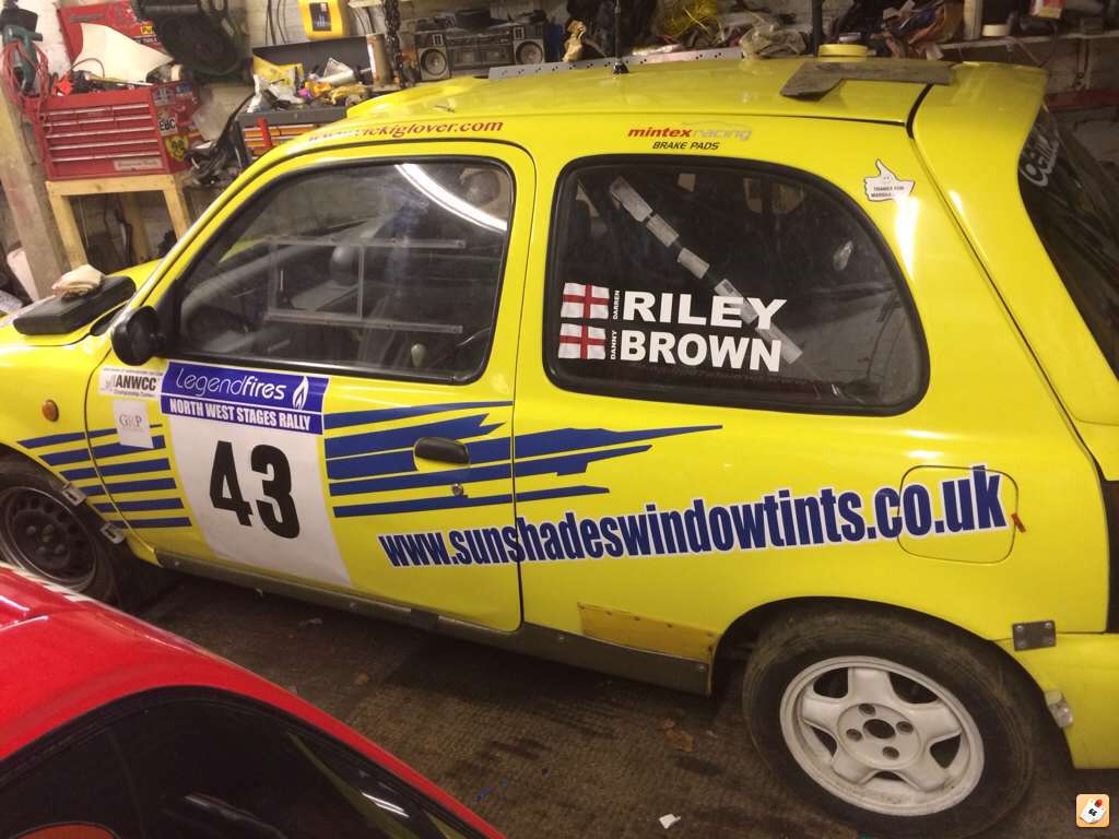

1.3 rally car engine build
Hi I am after some advice I want to get about 150bhp out of my 1.3 k11 engine can any one tell me what I have to do to get this with out spending millions on it cheers danny
