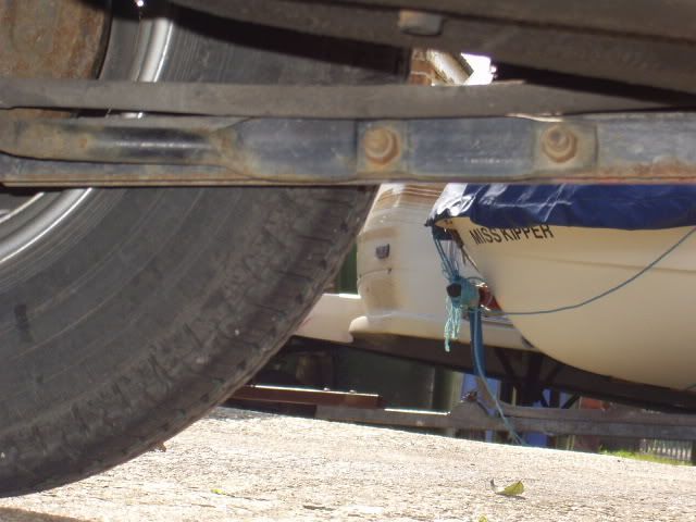

Oh yeah my 1.2 has one, preface lifts won't have those holes actually the arms will be cylindrical as opposed to flat and drilled.

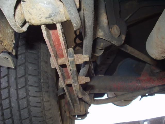

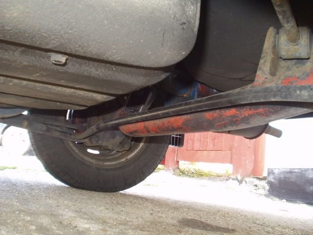

Hey whipit, would you be able to post a picture of your anti roll bar. I am looking to build my own or modify one from another car, just trying to get an idea of how they fit it in etc.

you do need to have the Bars like the one in the pic otherwise you can't fit it. :)
You need to get some pre-facelift link arms then!
Guess this is a good place to ask about welding an ARB to the facelifted round ones, or using some sort of clasping mechanism...Would that even be safe?
all facelift 1.2's have ARB's fitted as standard, if you want to fit the rear ARB all you need to do is change the drop links to the ones with the holes. all drop linkes are interchangable on all k10's 30 min job as long as the bolts come off....
