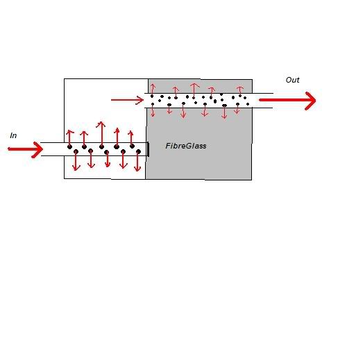

Is the standard K10 exhaust a reverse flow or stright through muffler?
Sort of:
http://i5.photobucket.com/albums/y190/crogthomas/silencer.jpg
This is my standard backbox that fell off after a particularly enthusiastic drive to the pub (across a field). Flow enters from the left into the pipe which is capped. It escapes through the holes in the side into the left-hand chamber then flows into the end of the 2nd pipe (on the right). It then flows straight out of the end (far right of picture) but is silenced a little on the way by the small holes along its length surrounded by fibreglass which I’ve mostly removed.
And, yes it is very restrictive. I've measured the exhaust backpressure with it fitted and it went off my manometer scale (30inH20). I measured it with a tyre pressure guage instead and figure its roughly 110 inches of H2O. Without it fitted the backpressure is a more reasonable (but still a bit high) 14 inches of H2O.
Makes no discernable difference to the performance though. Just makes it louder.
Removing the baffles would probably help, but you'd still be restricted by the small tail pipe on the box, unless you decided to chop that off but the volume would probably go up quite a bit!

I don’t think the big drill idea will work im afraid. The large chamber in the box is full of fibreglass and drilling into it would just make a big mess and not make any difference to the flow. Best to just replace the lot. The other one or two silencers nearer the front are of the straight through design (they are on mine anyway) but still a little on the small side.

What about drilling a few holes at the bottom of the exhaust box entry facing downwards to shift 20/30% of the exhaust flow out before it hits the baffles?
This could work right - it could also be repaired if it sounded too loud?
What do you think all?
I dont think that would work.
The only way to be sure of course, would be to flow test the box and make modifications flow testing after each stage.
But if I were going to guess id say the main restriction seems to be the small holes the the gas has to escape from out of the pipe on the left.
Perhaps this will explain better:
To remove this restriction the only options I can think of are:
1) cut a hole in the side of the box. Drill some larger holes in the side of the inlet pipe, or perhaps cut big chunks out of it with a hole-saw, then weld a patch back over the hole cut in the side of the box.
2) Weld in an alternative inlet pipe, terminating inside the left chamber and with no end cap.
Either way, its a load of ######ing about and welding. You may as well just replace the whole thing or even make your own.
