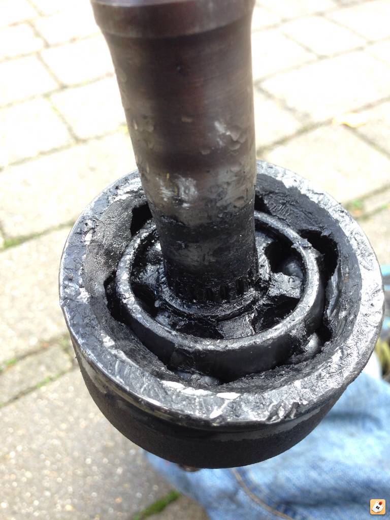

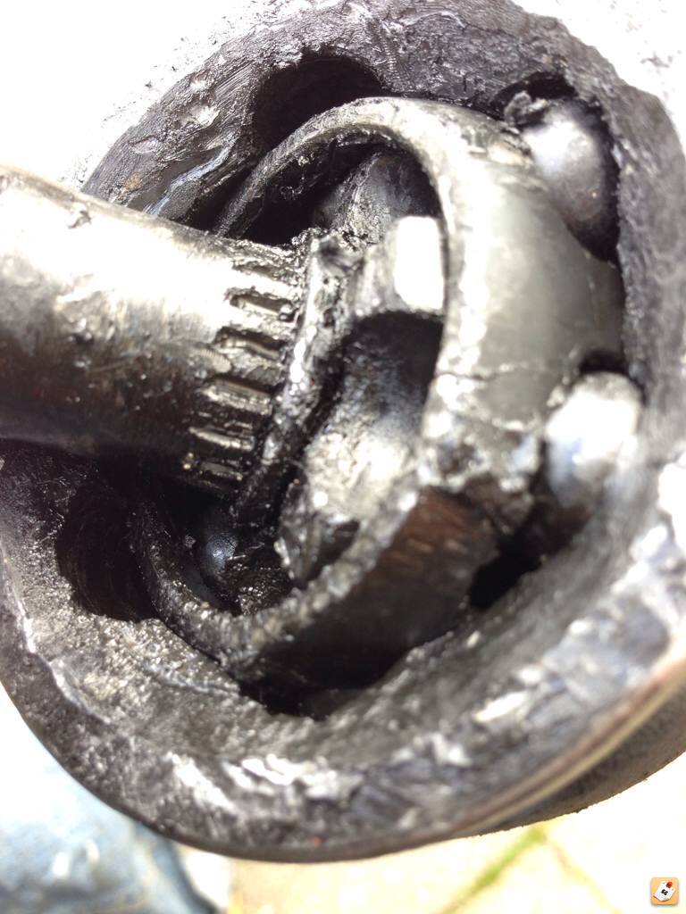

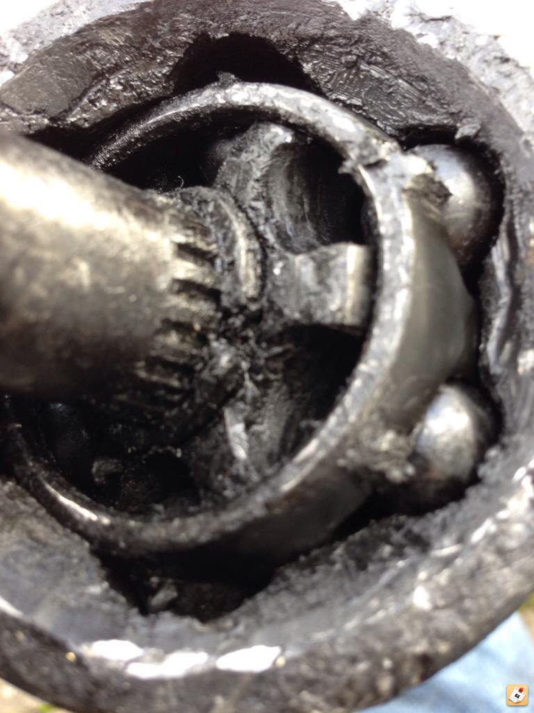

Hi guys, I need a help badly.
I changed new gaiter on the driver side. It was ok to remove this driver side cv joint.
I tried to remove this passenger side so this driveshaft came out and lose all these gearbox oil. :(
This grease are solid so I managed to remove these solid grease. I can't take this cv joint off?
Can anyone know please? I got work at 6 so auto shop will be close today at 4. I got 1 hour left to do it. Otherwise I will miss my shifts from today until Monday.

were your eyes open when you were hitting it jk ! ? i had 1 that did,nt want to let go a while back, you may as well fit another shaft mate
In first round, I was. I close my eyes before I hit on these right position. I try hard, harder and hardest so finally, it came off now. I managed to break this cv joint.
