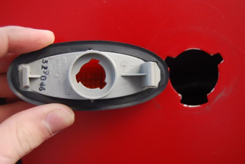

Just had a look, they should cover up the hole in the wing, but to fit them you would need to cut the clips off the back, and use adhesive/sticky pads to hold them on..
here's a pic if it helps:
And the wiring plugs are different, you'd need bulb holders to go into the facelift repeaters, and join the wires from you wiring to the bulb holder. You could do it pretty easily, just a bit of a pain.
