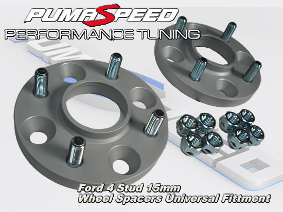

thinking of getting 20mm for rear, 10mm for front, and was wondering do i ned to extend the wheel bolts?
yeah sorry, i did mean the studs, so how would i go about finding the extended studs? i want 25mm rear, 10mm frontYou certainly won't need any bolts (Threaded hole in the hub and long bolt through the wheel into the hole). The K11 micra has studs and nuts (threaded bar attatched to the car, that the wheel passes over and then a nut screws down onto the wheel).
Safest? (the only allowable method of spacing in most motosport) is to fit extended studs, have a spacer that slots over and then the wheel fits over the extended stud and seats on the spacer. With the nut tightening down on top of that. It is best that these spacers are also Hubcentric (the centre hole in the spacer fits snugly to the centre spigot of the hub, with a simmilarly size protrousion (spigot) on the front face to help the wheel tighten centrally.
All other techniques require futher fixings to be used, increasing the chance of failure.
Imho, the next best would be a spacer that fixes onto the hub that then has another set of stud or bolt holes offset 45 degrees. Often called Bolt on spacers - but their design varies to include studs or bolt holes. These can also be bought as pcd adaptors, to change the PCD of the vehical - opening up a whole world of interesting and exciting wheel possibilities. (see the civic sedan in this months Fast Car mag)
Next would be stud extensions/spacers - A threaded extension screws onto the stud, providing an extended externally threaded section. I've rarely heard a good word said about these, though have no personal experience. Several on here have used them without problems.
Pics are all for illustration purposes of the theory, they are not a suggested possible product!
