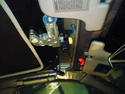

Hi fellas...is it possible to convert a manual sunroof to electric....on a 99 k11 micra...Ive searched everywhere but cant find any references to anyone doing or trying it...any help would be appreciated,

k550i-1360-jpg.32404
http://micra.org.uk/threads/pollymobiles-rebuild.35251/page-5#post-399188
it's written on the linked blog, any nissan sunroof motor that bolts onto & engages with the k11 sunroof mechanism. In my case it was from an almera sport.
the motor will of course foul the sunroof lining without modding but I left it off anyway. switch was bonded under the motor.
