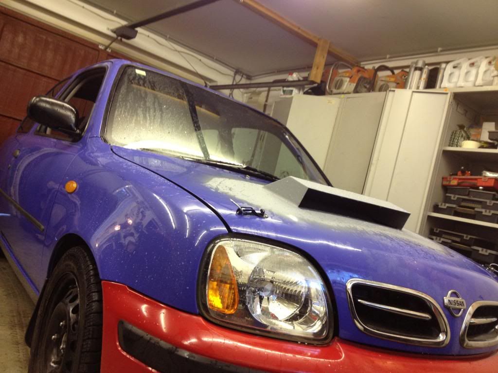

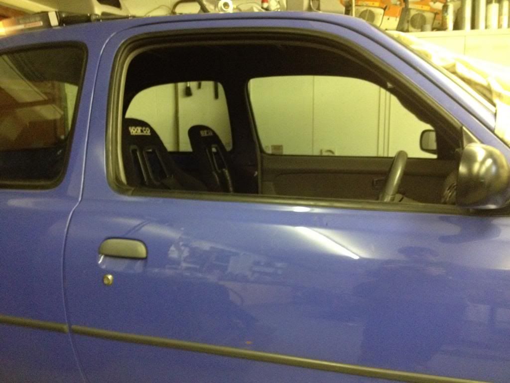

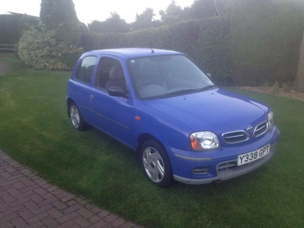

I have just bought molly on Saturday for the fwd project using my old r1 4xv engine. Its going to be multipoint caged, front wheel drive, sparco fiberglass buckets, fully stripped, lowered a fair on spax bit current one is around 3", possibly polycarbonate windows again and eventually hopefully i'll be making fibreglass bumpers, bonnet, boot and hopefully doors (i know the doors wont be easy by any means).

molly on her first day

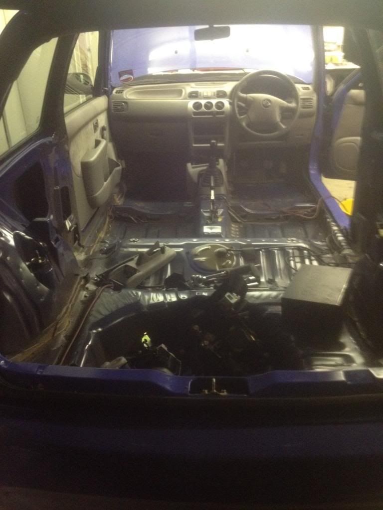

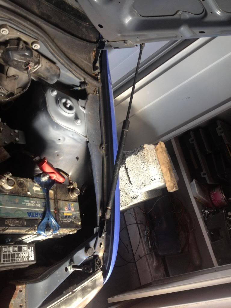

nearly fully stripped in an hour or so

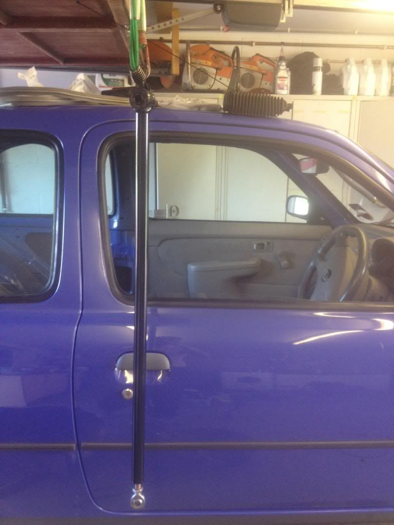

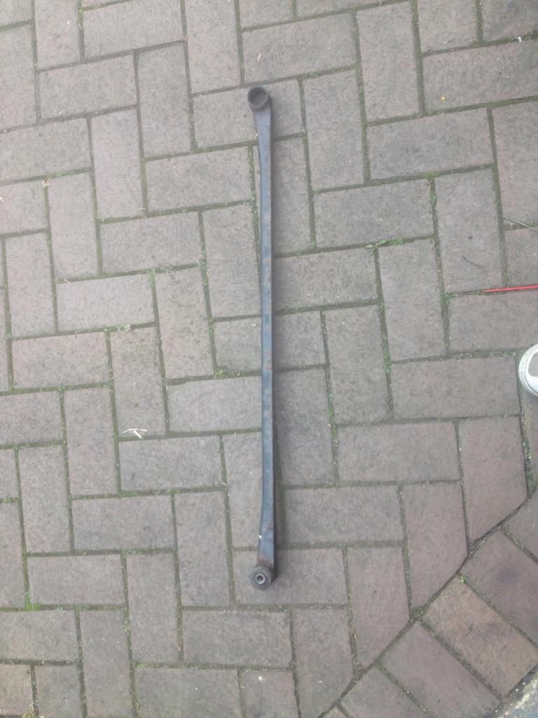

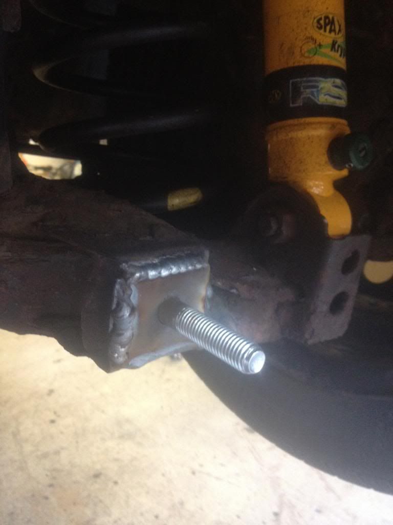

panhard rod made using old rods bush and rose joint. Used something I learnt at school (i did come in handy after all...) worked out with 80mm drop the length of the panhard should go from 815 I think it was to 800mm. Will be laser aligned when done.
did cut the bolt down and spray it up.

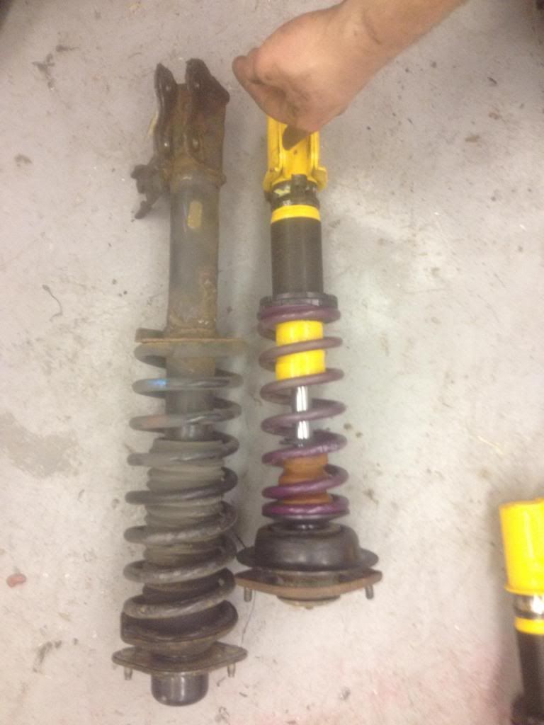

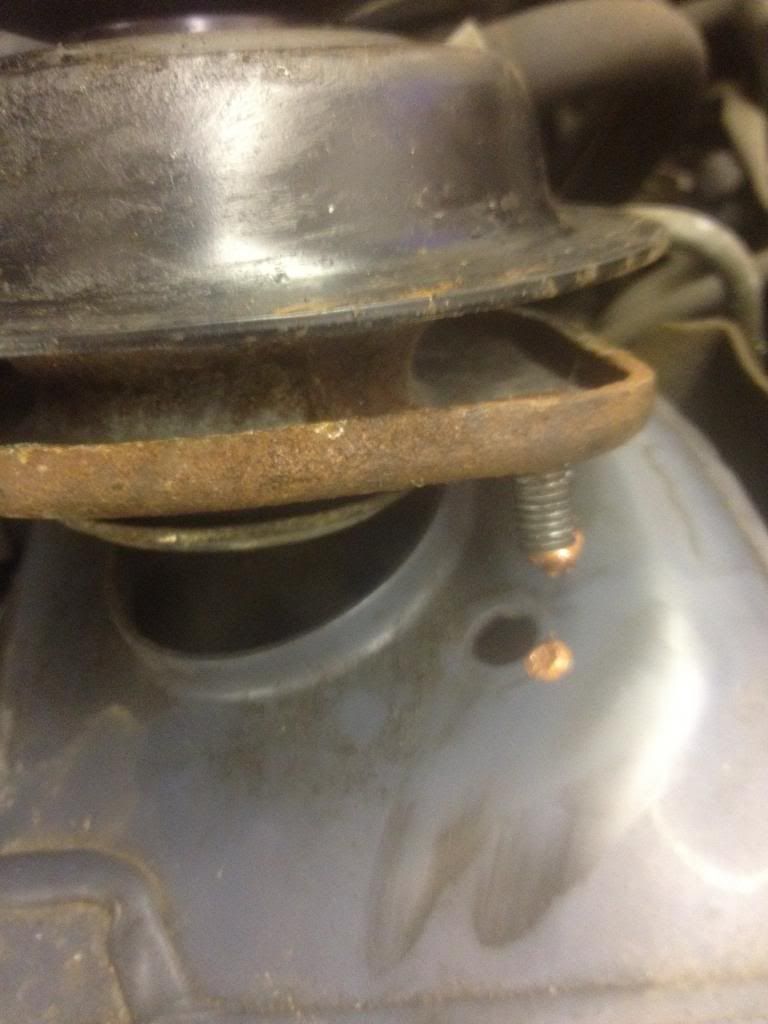

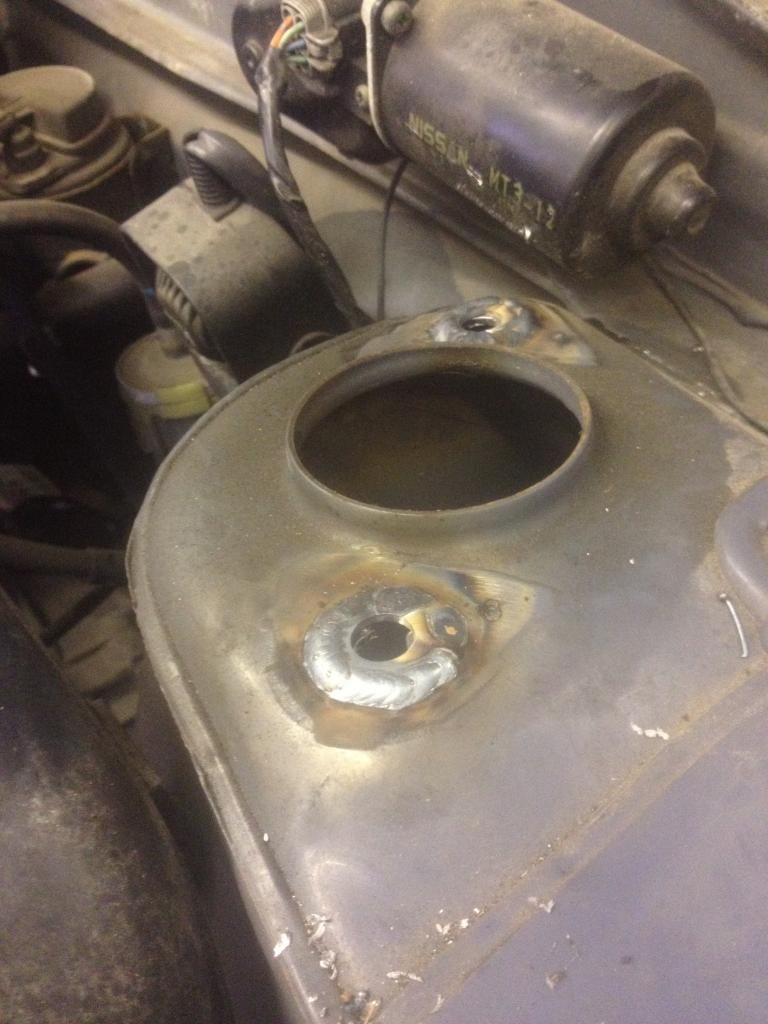

How to fit corsa b front struts without changing top mounts. elongate the actuall strut to upright holes. Mark where strut new top mount bolts go to as shown. I welded on some washers just mainly to cover up old holes and put a bit of strength back in.

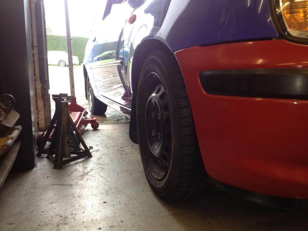

front only lowered here, on highest setting on corsa b coilovers. front will be set to match 80mm rear lowering.

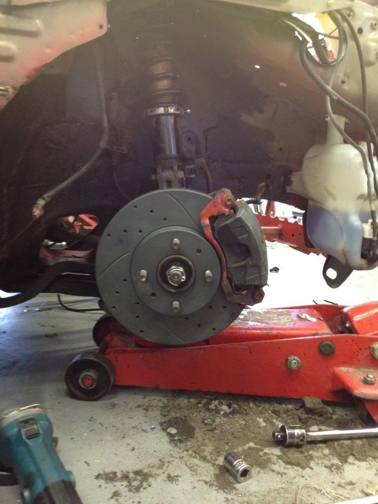

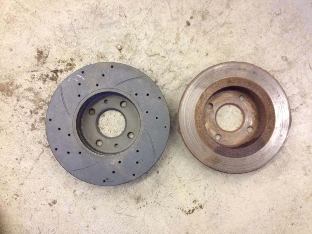

brake upgrade to gtir calipers and discs. to confirm what most people say. need a spigot ring to fit disk to hub keep it central. 1mm spacer for caliper. And will fit under standard micra 14" steel wheels. still to paint and refurb calipers

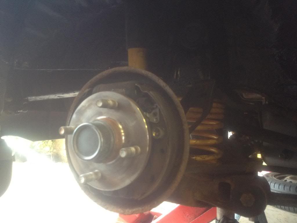

rear springs to stick in now sat on cut rears just to check sizes etc.

fitting custom cages cage/gussets
buckets/harnesses

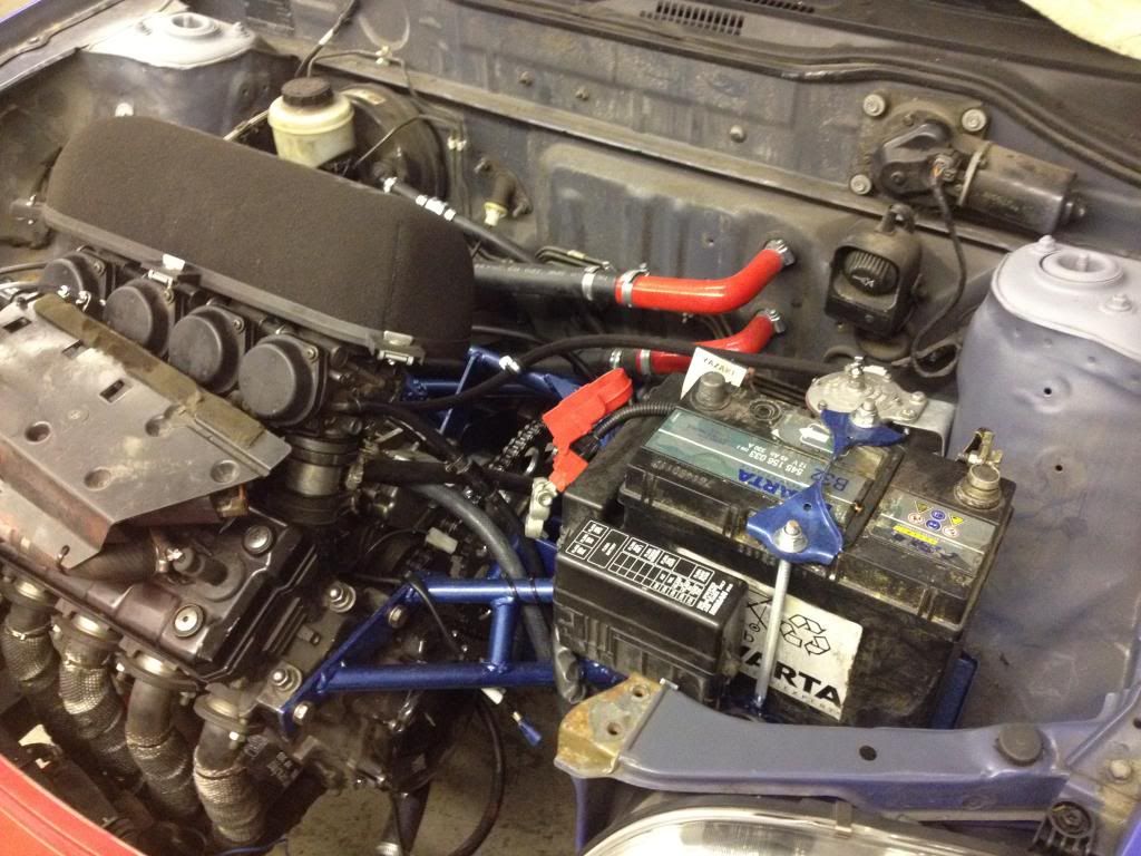

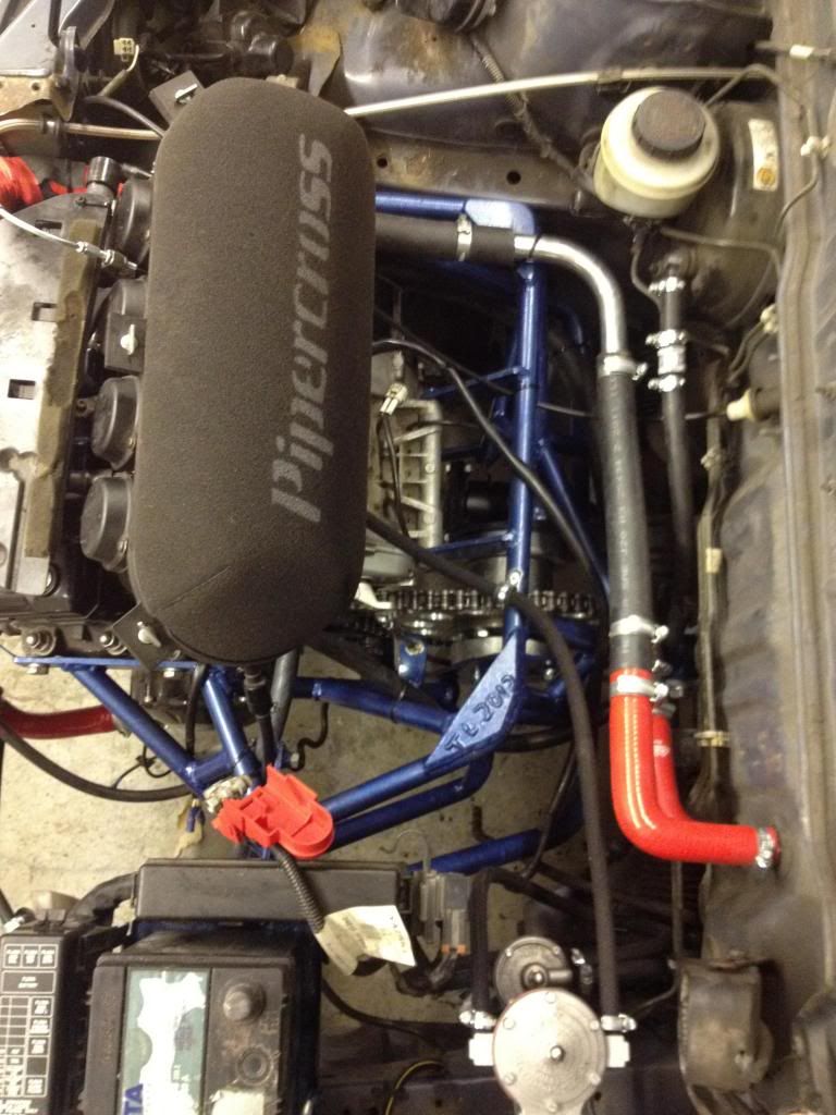

engine in all plumbing rad batt, gear cable exhaust.

What size spigot rings are needed for the disks?
Got some coming and if i can get the bits together before they arrive will make it all much easier :p
Like the thread Tim! Looking good :)
micra centerbore is 59.1mm and pulsar gtir disk centerbore is 61mm acording to the net. I heared you use 1mm rings so i made some from sheet metal. Worked a treat might check with a DTI just to check there running true up and down. Also you need a 1mm spacing between caliper and upright, going to make these today and refurb the calipers and paint.

No probs. yes 1mm between caliper and upright to bring the caliper out 1mm to centralise it on the disc.

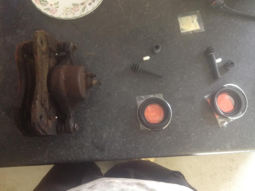

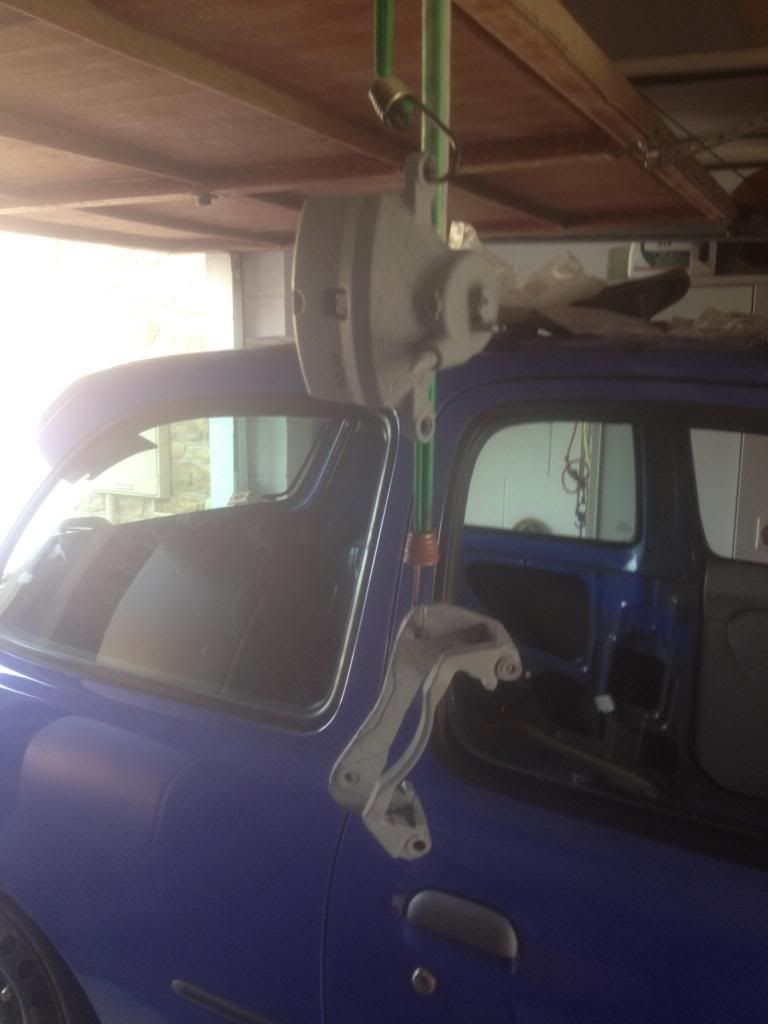

got both front calipers rebuilt waiting on shims/anti rattle plate thingys. Thanks to skinner_87.
Primered ready for paint, 1mm spacers made and fitted.

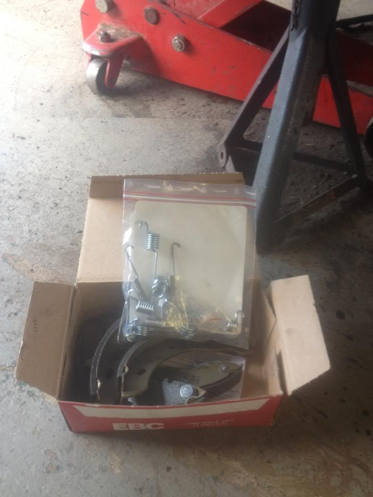

redid rear brakes with ebc pads, going to try it as it is with just drums on the rear for now.

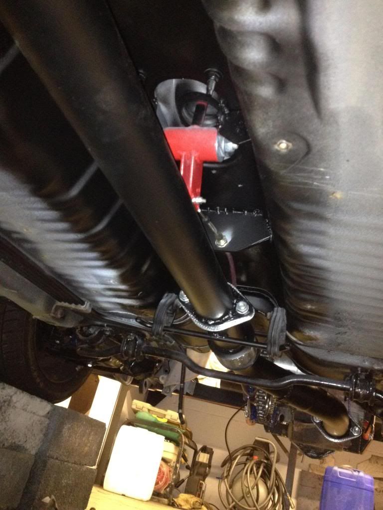

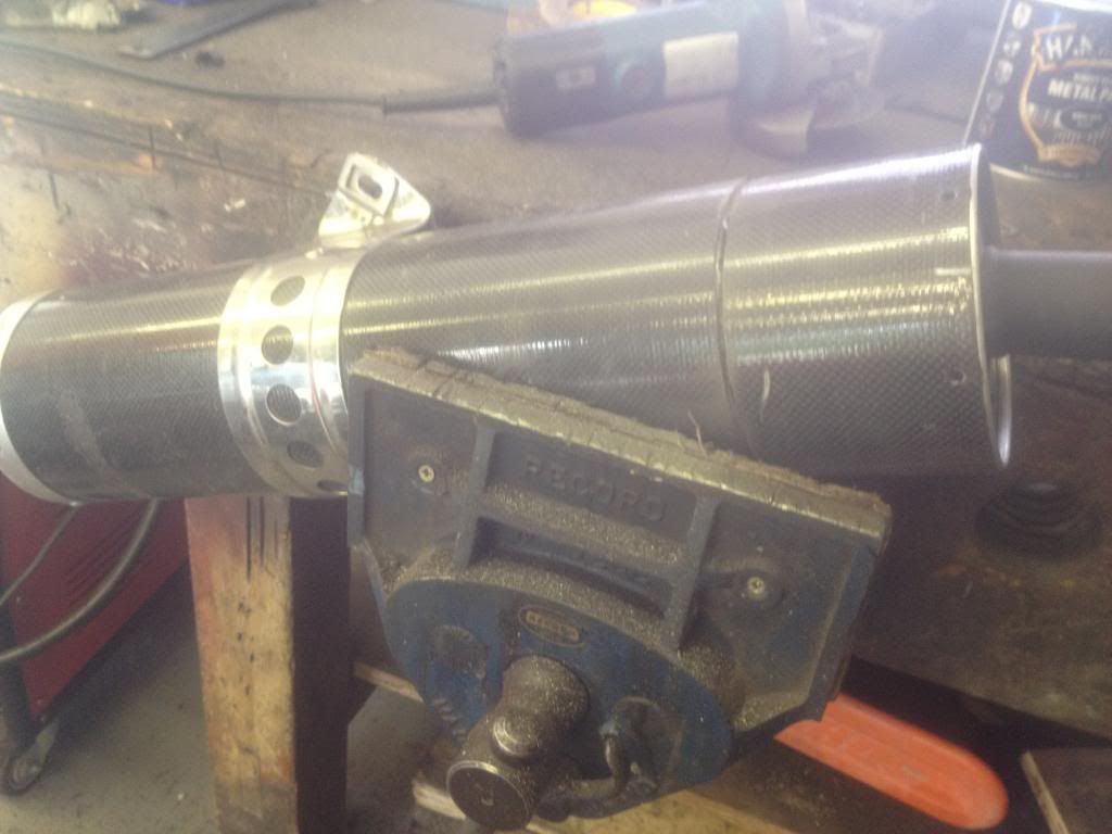

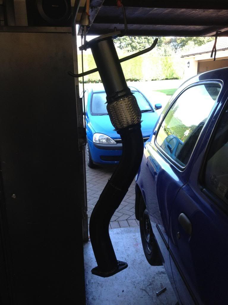

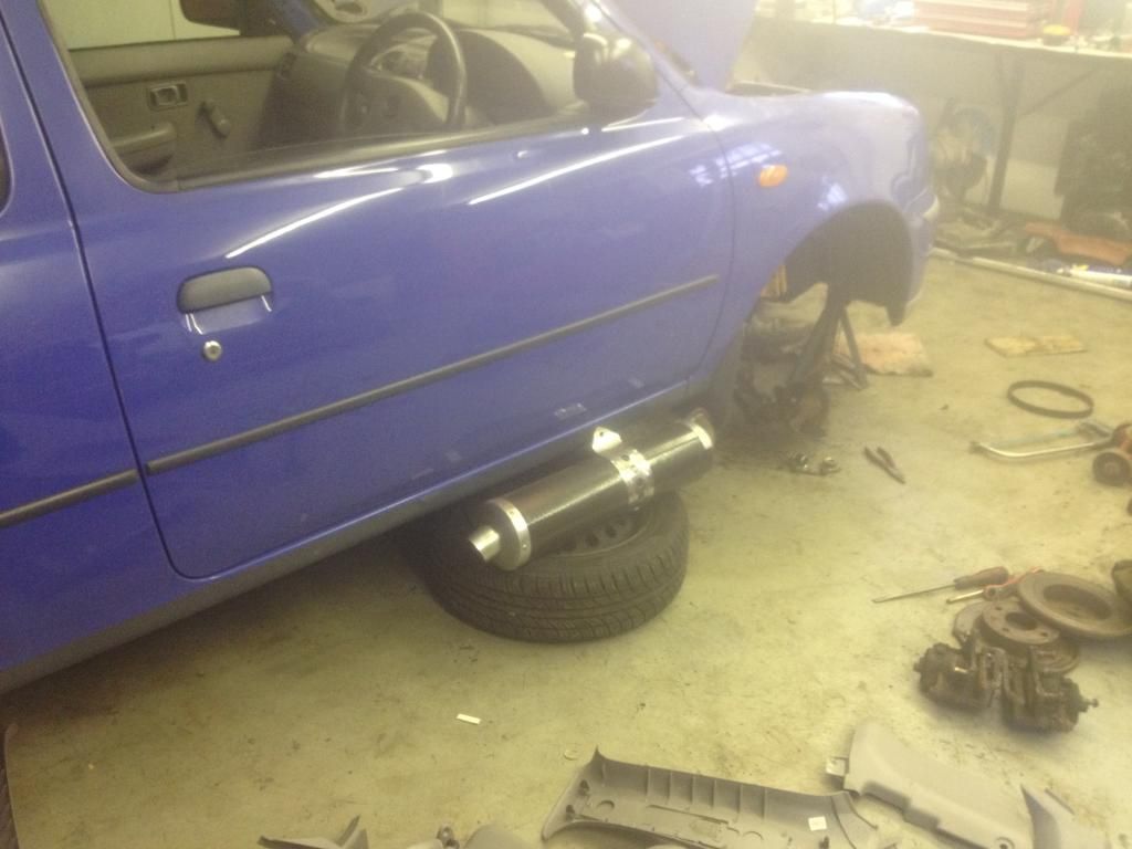

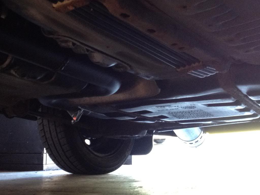

cutting end can to fit between rear bumper and beam

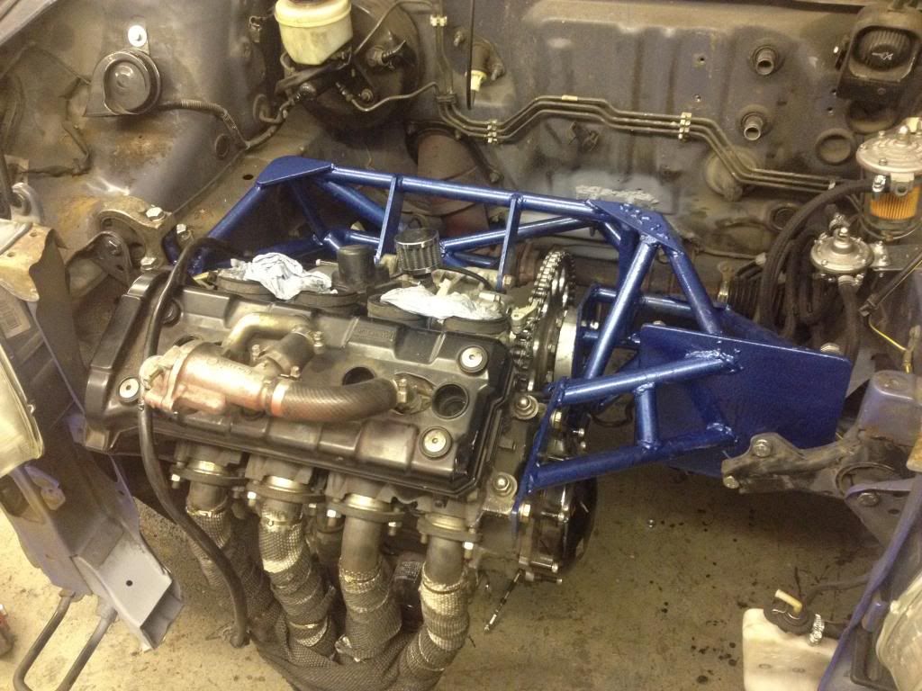

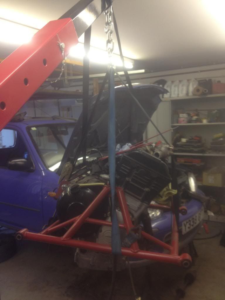

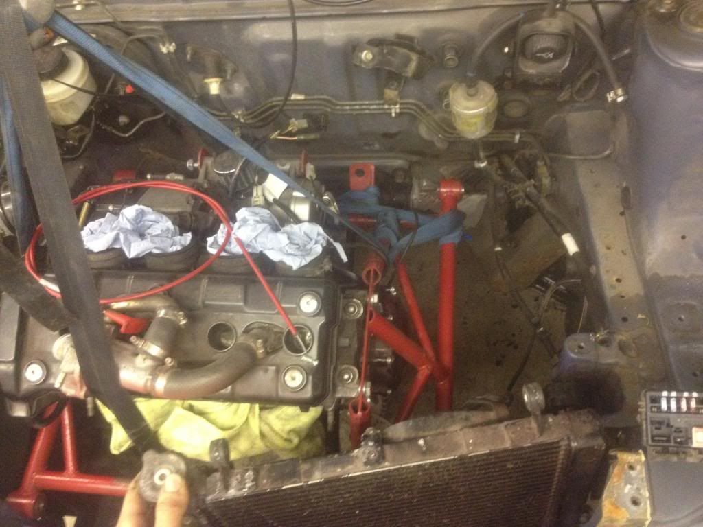

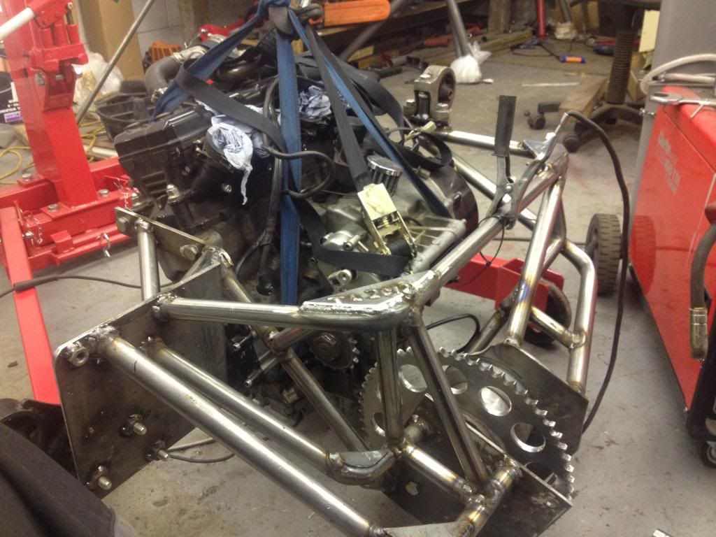

engine in old cradle with dodgy rigging.

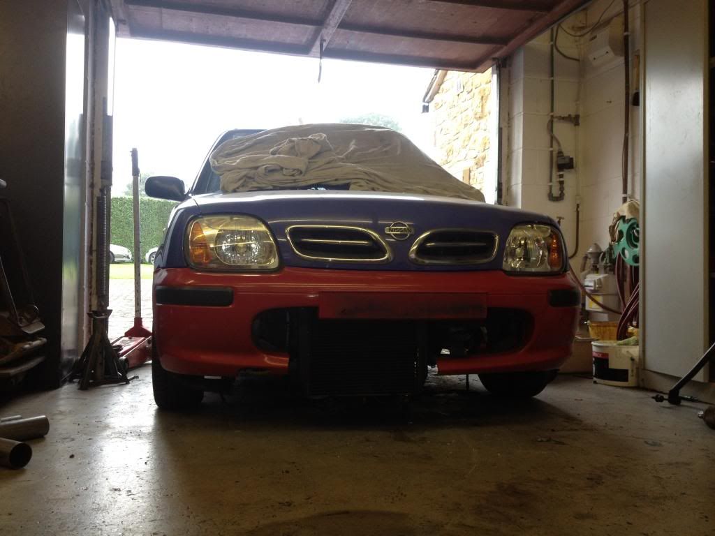

roughly where she will be sitting.

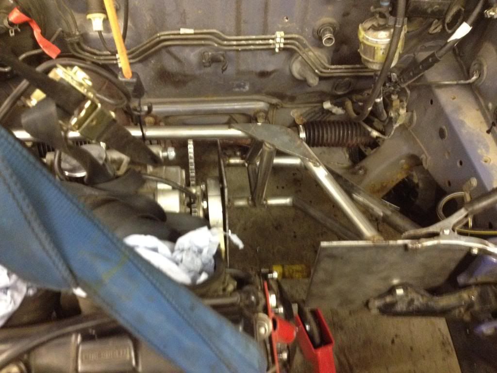

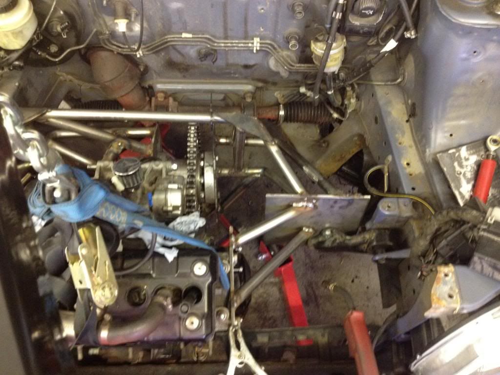

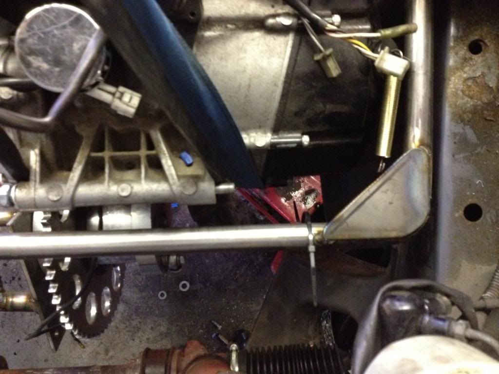

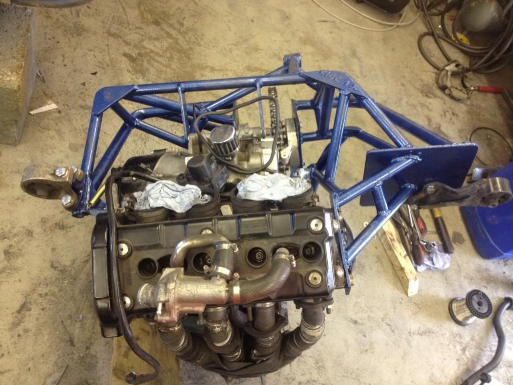

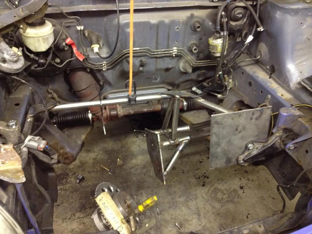

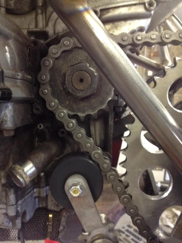

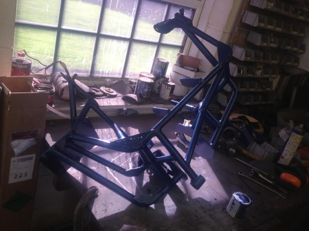

Well heres a few more pics of making the engine/diff cradle. Steady progress as it all needs making and lining engine to sprocket etc.Mock up of where i'd of liked them to sit.
Few more nights should see engine in by itself.

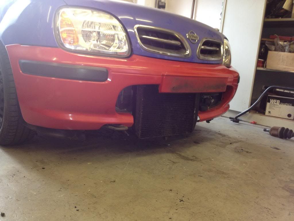

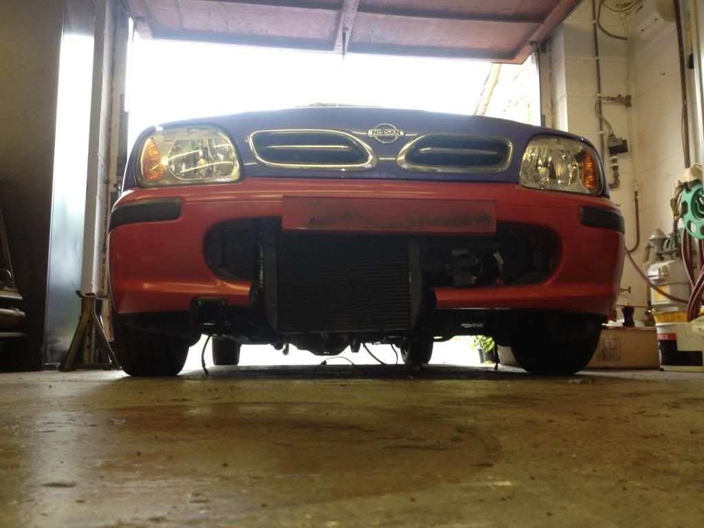

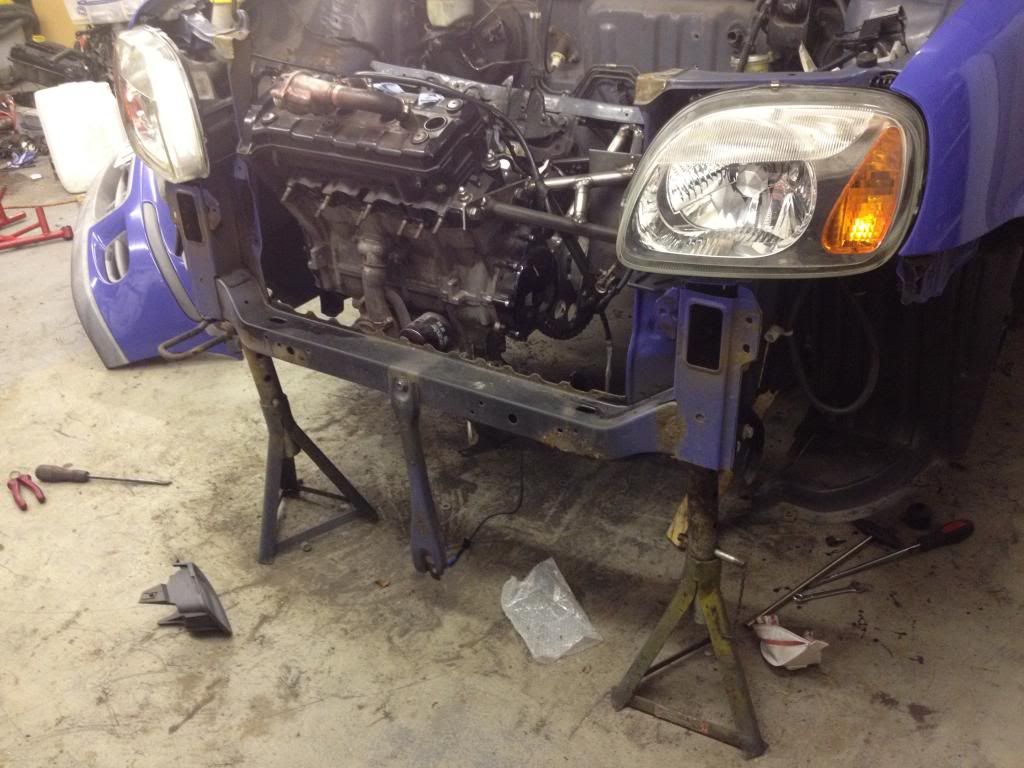

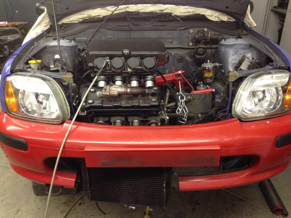

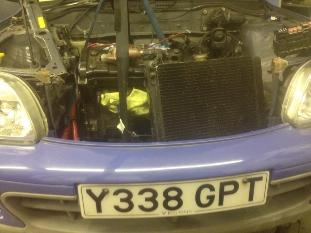

Exhaust may need moding a bit and also front bumper will see a radiator sat right upfront due to lack of space. Good excuse to get on with the fiberglass bonnet and bumper quicker than id of thought.

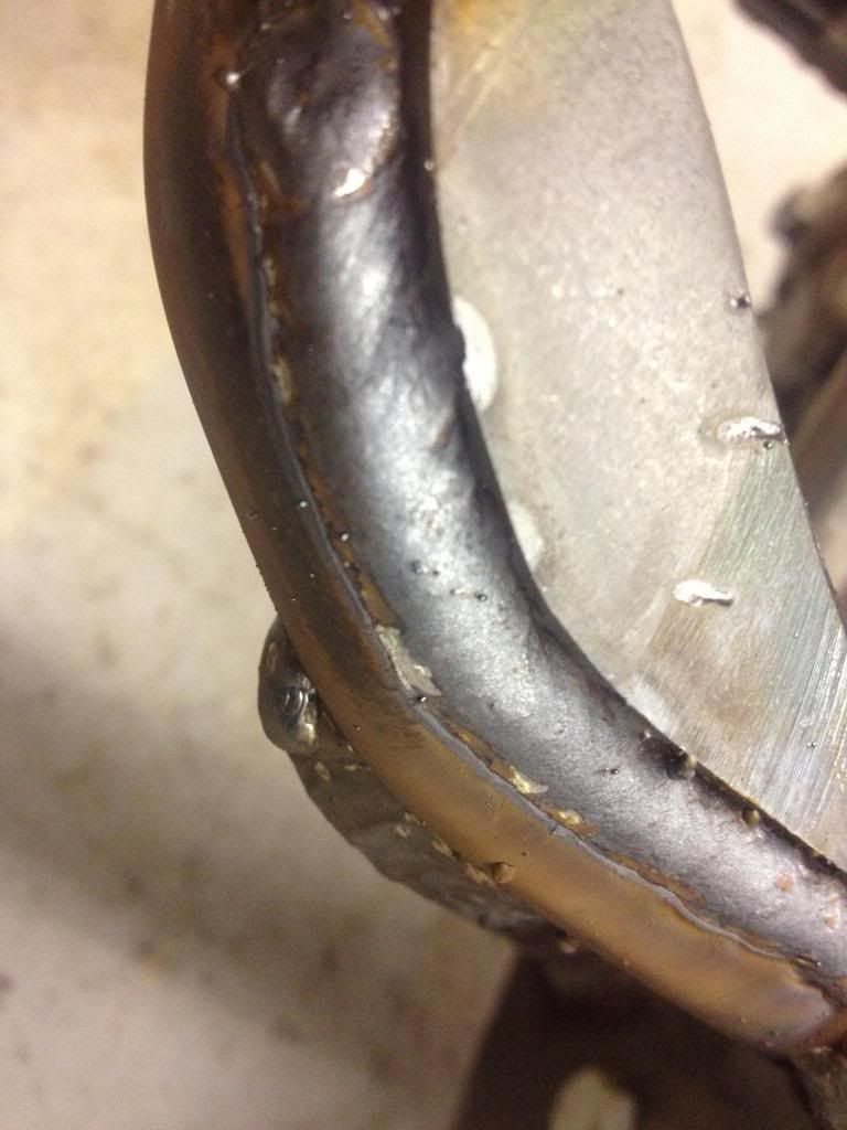

Got the engine/diff cradle pretty much made up just a few odd bits to fully weld and a few more bars to add.

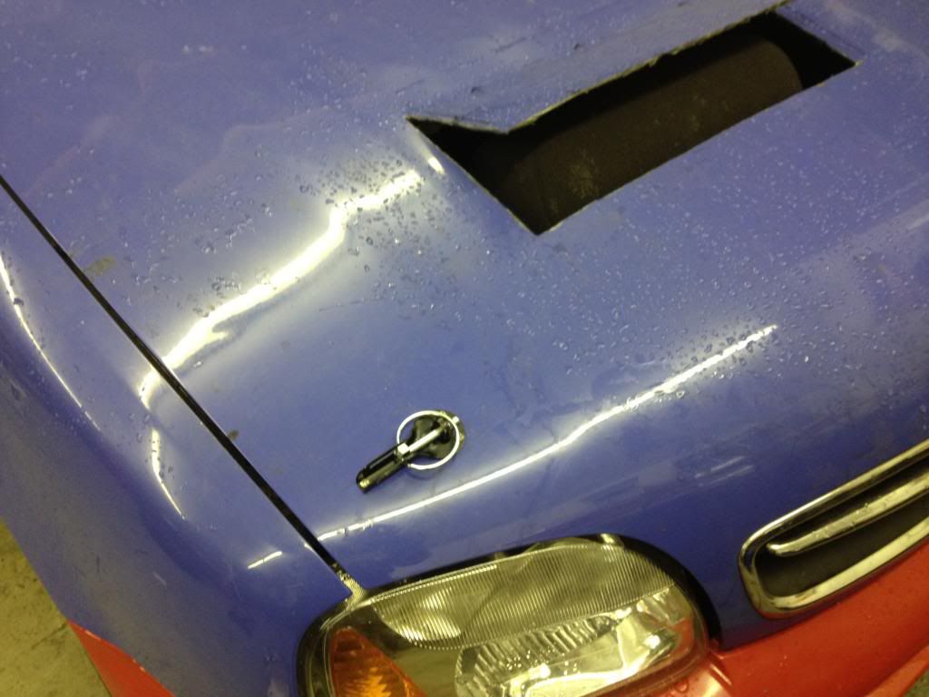

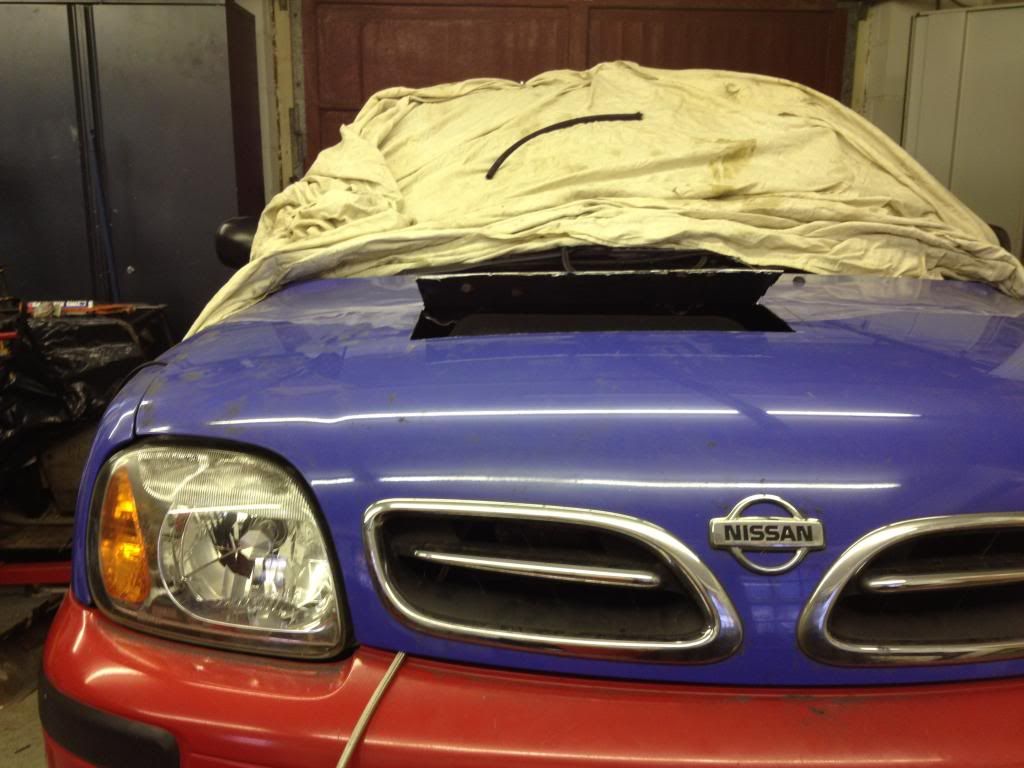

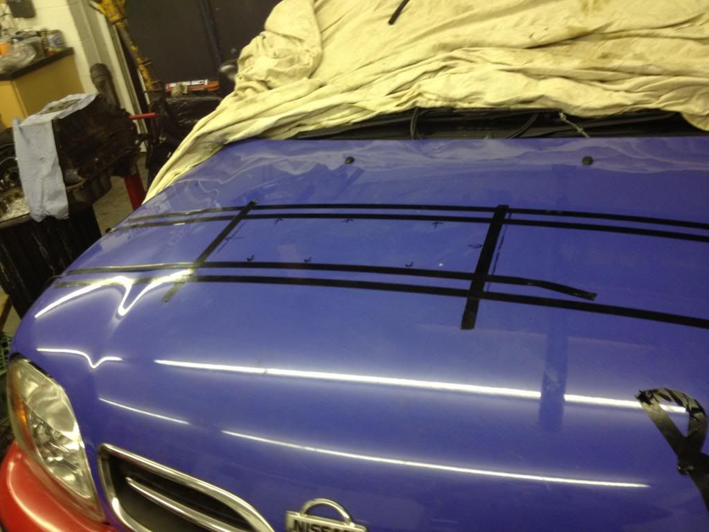

Fiberglass bumper will be made once the car is finished also bonnet scoop will be made then i think a mould took of that to do a bonnet aswell as the air filter will poke through a little. Spacers to order and mock driveshafts to make mock ups soon. Also exhaust to make and gearcable to fit.

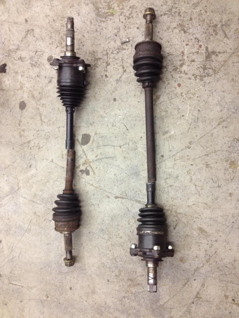

The 99p rear beam lol? Cheers, nice to get it nearly finished will get some pics up soon. Just waitin on driveshafts comming back also need to sort out a fuel gauge, and then the cage and some bumpers. Mot next week :)
